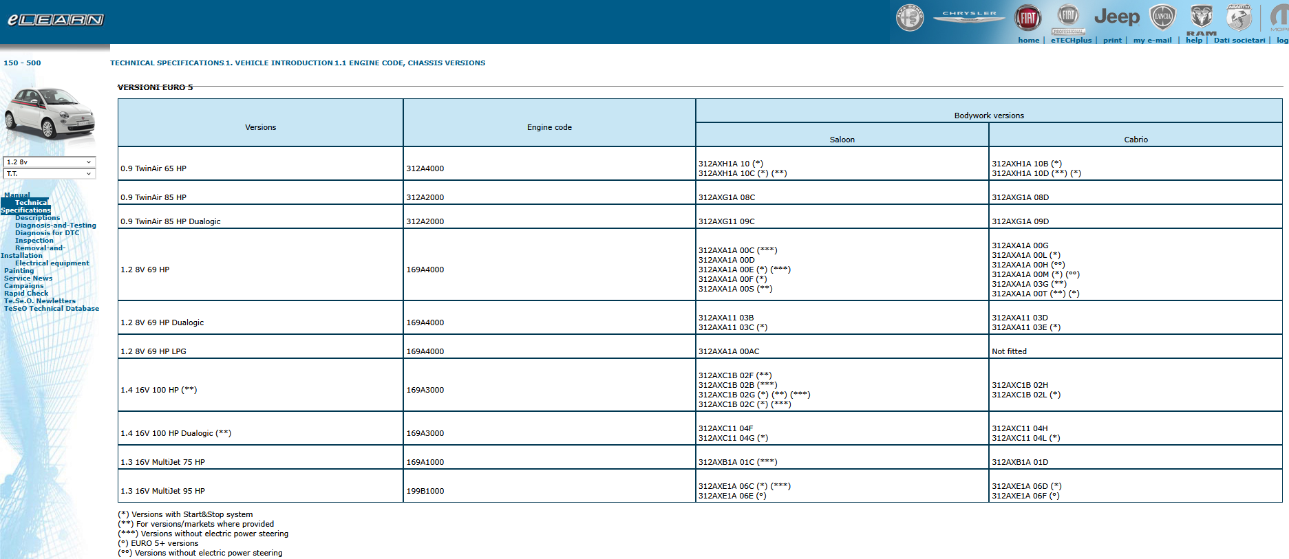

Hello,
I'm not sure if this code would be somewhere on the engine block. I assume you'd find there the part numbers, on all of the parts (like block, head, etc.). The engine type should be listed on the aluminium plate under the bonnet (where the VIN number is).
Then you have this info from eLearn:
