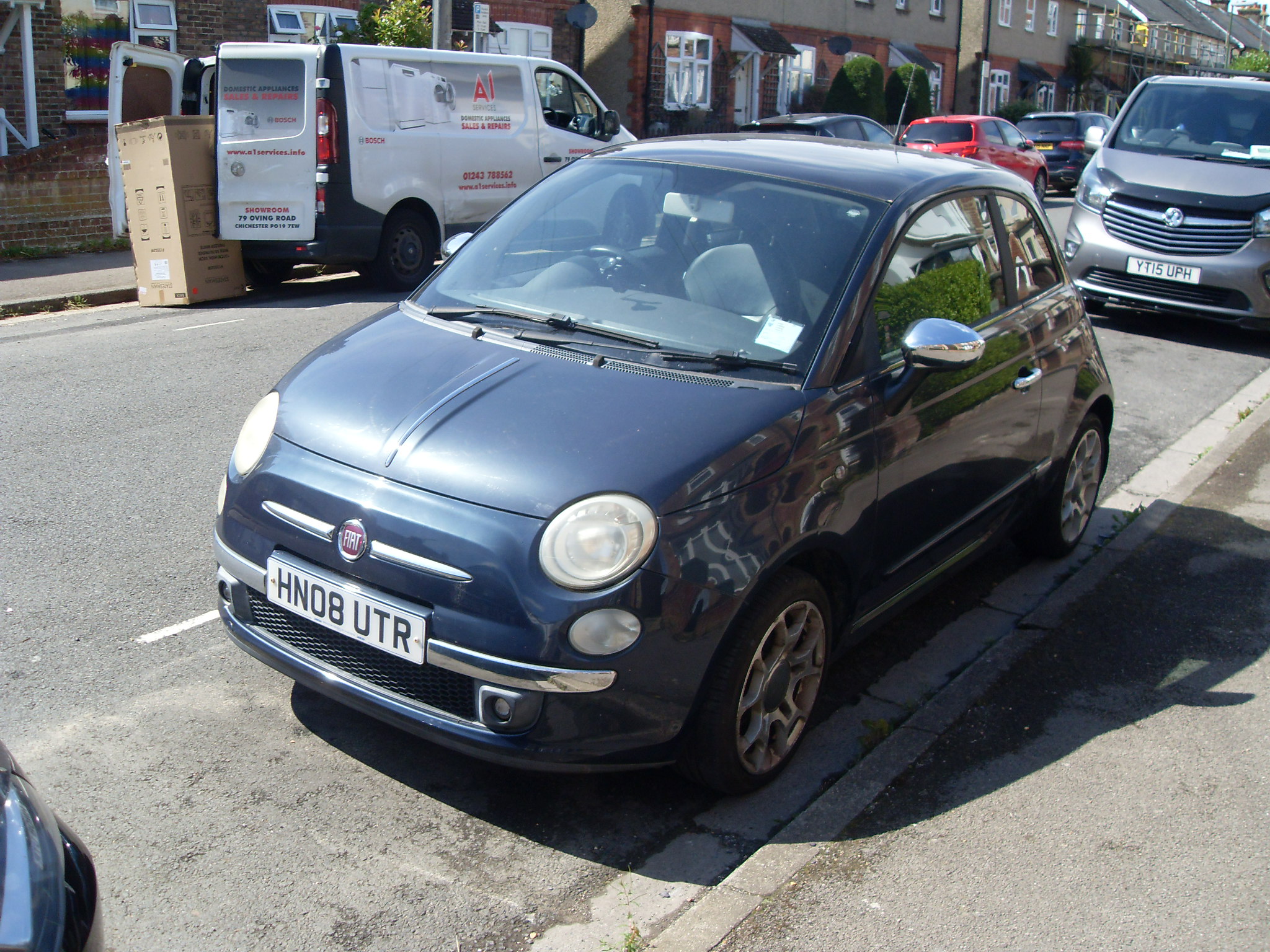

My update on this (my brain hurts) :
Have spoken to 4 local garages regarding the clutch issue. Have been told "it's the master cylinder", "it's the slave cylinder","it's both slave and master cylinders","slave cylinder is concentric type","slave cylinder is external type", "needs a new clutch" etc etc etc.
The car is 16 years old now but only 28,000 on the clock. However is costing more and more each year in maintenance - £1,500 recently, new brakes all round, new wishbones and other bits and pieces.
So, have just bought a brand new Fiat 500 1.0 Mild Hybrid Top which I can collect on 9th August. Got £5,300 off the RRP so a great deal.
Sad to see the old car go but none of us are getting any younger!
A big thank-you to everyone who has contributed to this thread.
Happy motoring to all!
Regards Tony

Shame, someone has just got a cheap p/ex car probably;)
