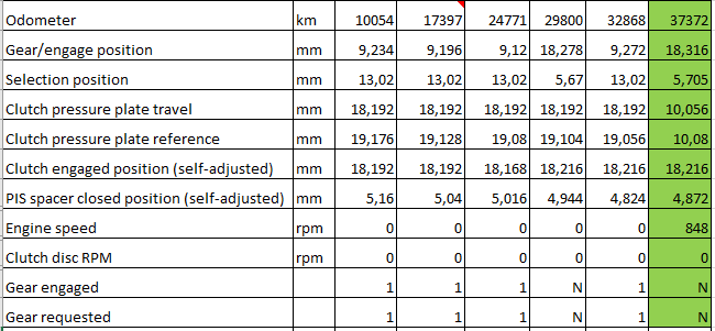

Below are some values for my 2018 2.3/150, CFC448. I log all Comfortmatic parameters now and then as reference values in case of future problems, and to spot any trends. The last column is highlighted because it's different i.e. the engine was running:

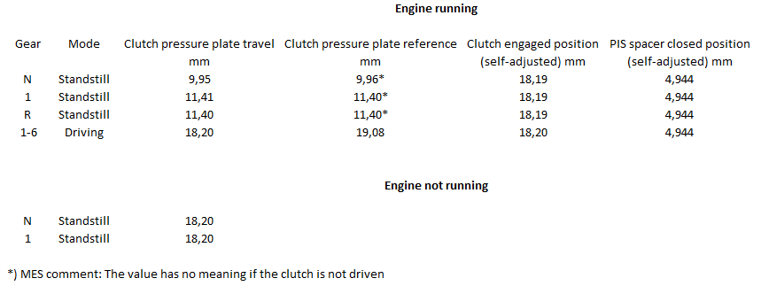

And also a table showing clutch positions while travelling/idle/engine off; logged at 29850 km:

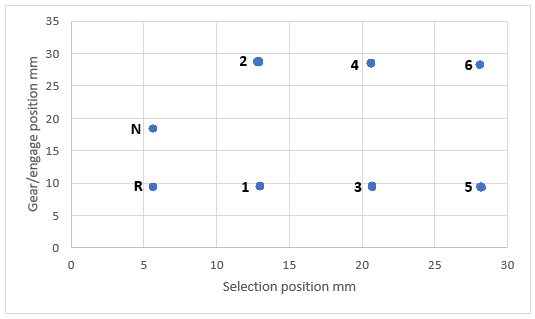

Plus a graph showing the Gear/engage and Selection positions, based on values logged while driving:
