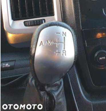

The difference should be easy to notice in the specification, Comformatic having 6 gears and ZF 9 gears. Then, the gear lever is completely different:
Comformatic:
ZF:

The difference in the gear levers is an easy way for me to identify which box is fitted.
I'll be taking a look when I try it out next week.
