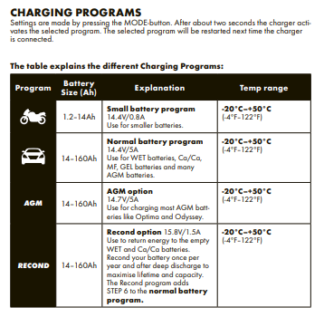

I use a standard charger like you'd use on a campsite with an a 3 pin adapter to plug into the mains at home. Here's a link to the battery: https://www.halfords.com/motoring/b...7B9ZOdSDSitezm7-FUhoCStYQAvD_BwE&gclsrc=aw.ds
OK, so it's not a Lithium battery, so no dedicated charger is required.
I'd also say that this battery being a lead-acid battery will produce some gases while charging. There's a breathing hole on the side, and even a second one on the opposite side, with a red plug in it.
One or other of the vent holes should vent to the outside of the vehicle, with suitable PVC tubing. (Outside includes down through the floor.) If this had been done initially, the smoke alarm would not have operated. Best to check voltage across battery terminals while charging. If gtreater than 14.4V, the charger should be disconnected. With battery charged and disconnected, voltage should settle to about 12.8V after several hours. If it goes below 12V, the the barttery may have a faulty cell.
