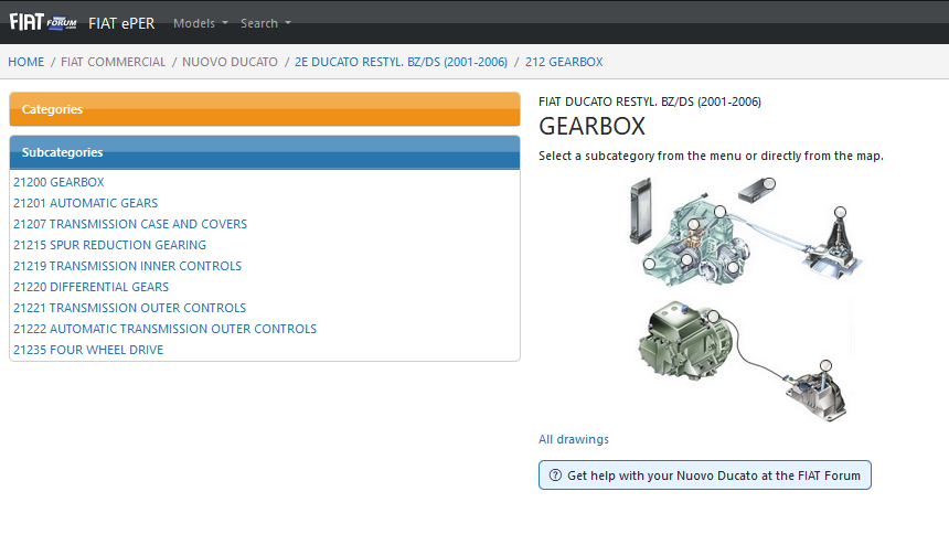

Hi, our Hymer on a 53 plate Fiat Ducato base is struggling to find some gears. We are told by the garage the part is not available but will not tell us what part is required. We cannot find reverse or 5th gear and it is difficult to find first at times. Can anyone help with either pictures of the underside of the same age and model van so we can see the gear selector rod etc or technical drawings of what maybe needed?

Hello,
On the bottom of the forum banner you've got a link to the forum ePER, FIAT's spare parts catalogue.
The search window is top left of the screen. You can browse by models and categories, or search with the VIN number, but as it is a Hymer, it is possible it won't be recognised.
There are several diagrams for each category, you can swipe on the bottom to see the others

Thank you for replying! I will take a look now 🙂
