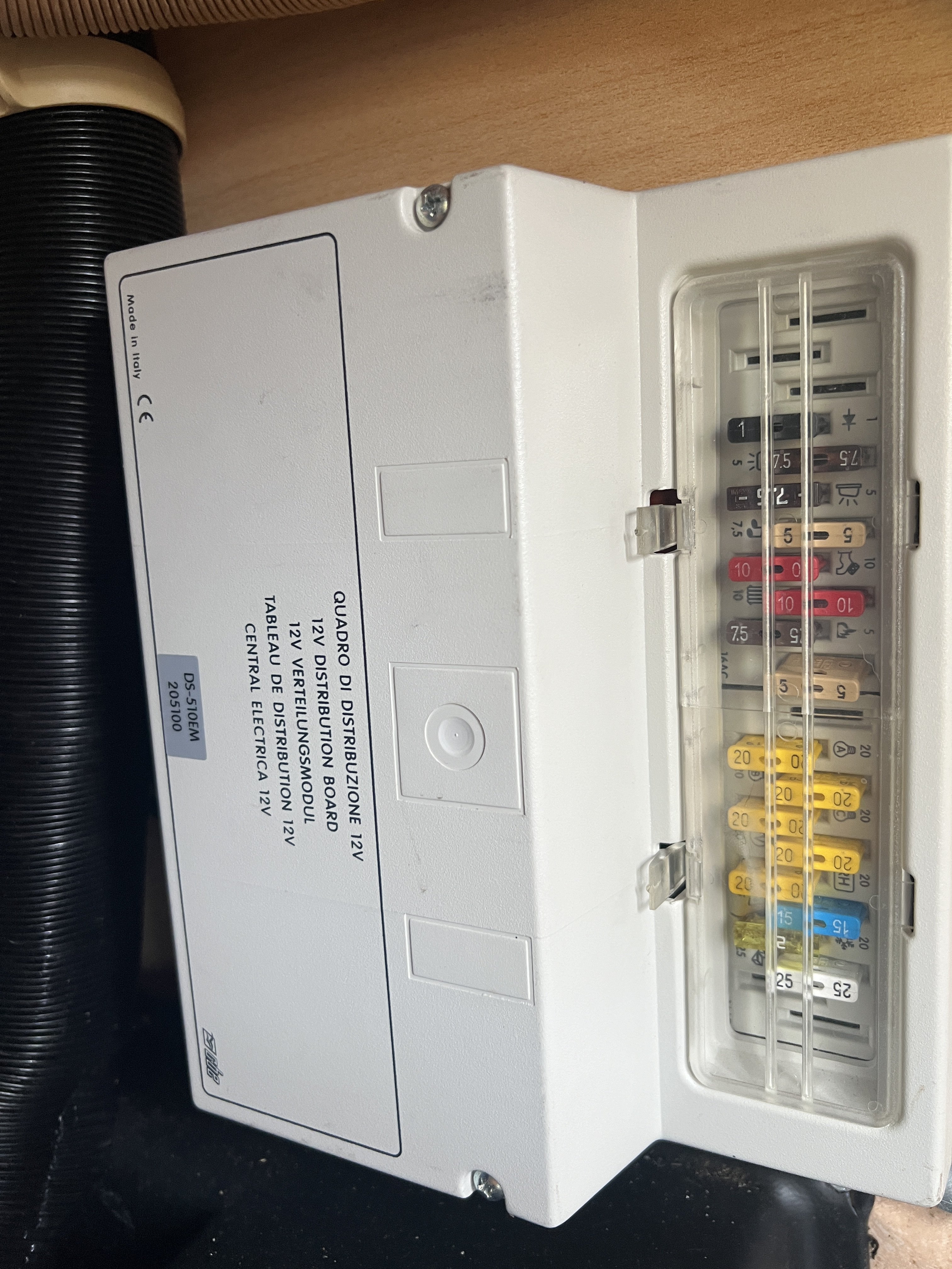

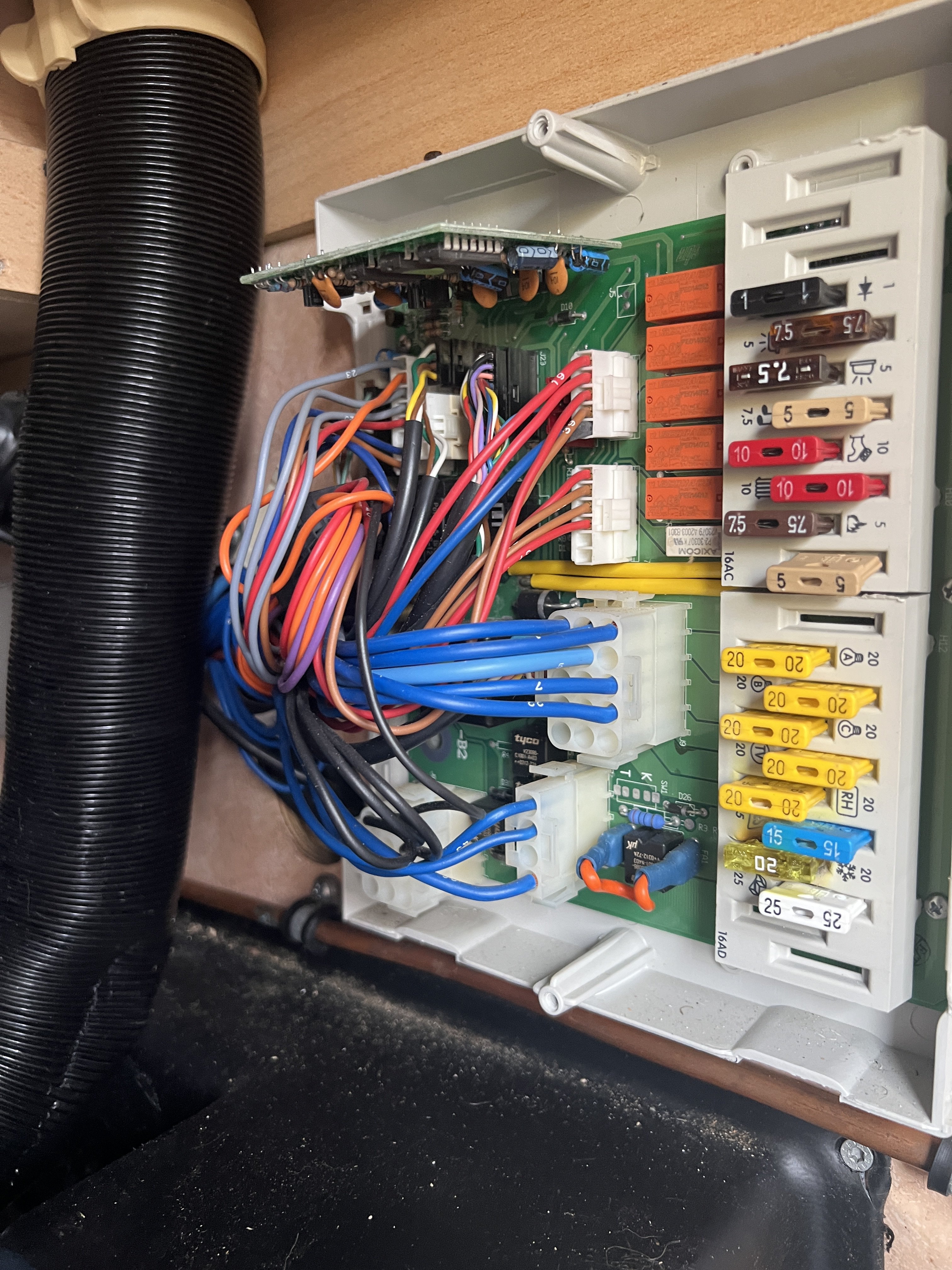

Hej, kan nogen hjælpe mig, jeg har dette cbe 510 hovedkort til at styre mit 12v lysnet i min autocamper.
Jeg har 2 agm batteri, som jeg vil udskifte med et lithium setup, så ny oplader og booster og solar controller til lithium profil,
,Jeg har ledt efter et victron-produkt.
,Men hvordan gør jeg det rigtigt med d+ og b+ på.
,Jeg skal bruge kabler, jeg tror det ene er fra startbatteriet og det andet fra i autocamperen men hvor er d+ signalet fra generatoren

The CBE DSxxx does not take D+ from the base vehicle. My PVC has a DS520, It simulates its own D+ signal by monitoring the voltage of an ignition switched supply. This is mentioned on page 19 of my manual under the heading "Electronic Battery Separator".
When fitting a B2B to my PVC, I added a changeover relay before the B1 terminal. Relay was operated fron the simulated D+ output. The fridge was reconnected to be supplied by this relay when operated, but when released the relay restored the original connection, so as to allow mains charging of B1. As my B2B was voltage triggered, I added a second large relay to prevent false triggering when mains charging. This needed an electronic driver as the mains on signal has limited (50mA) output.

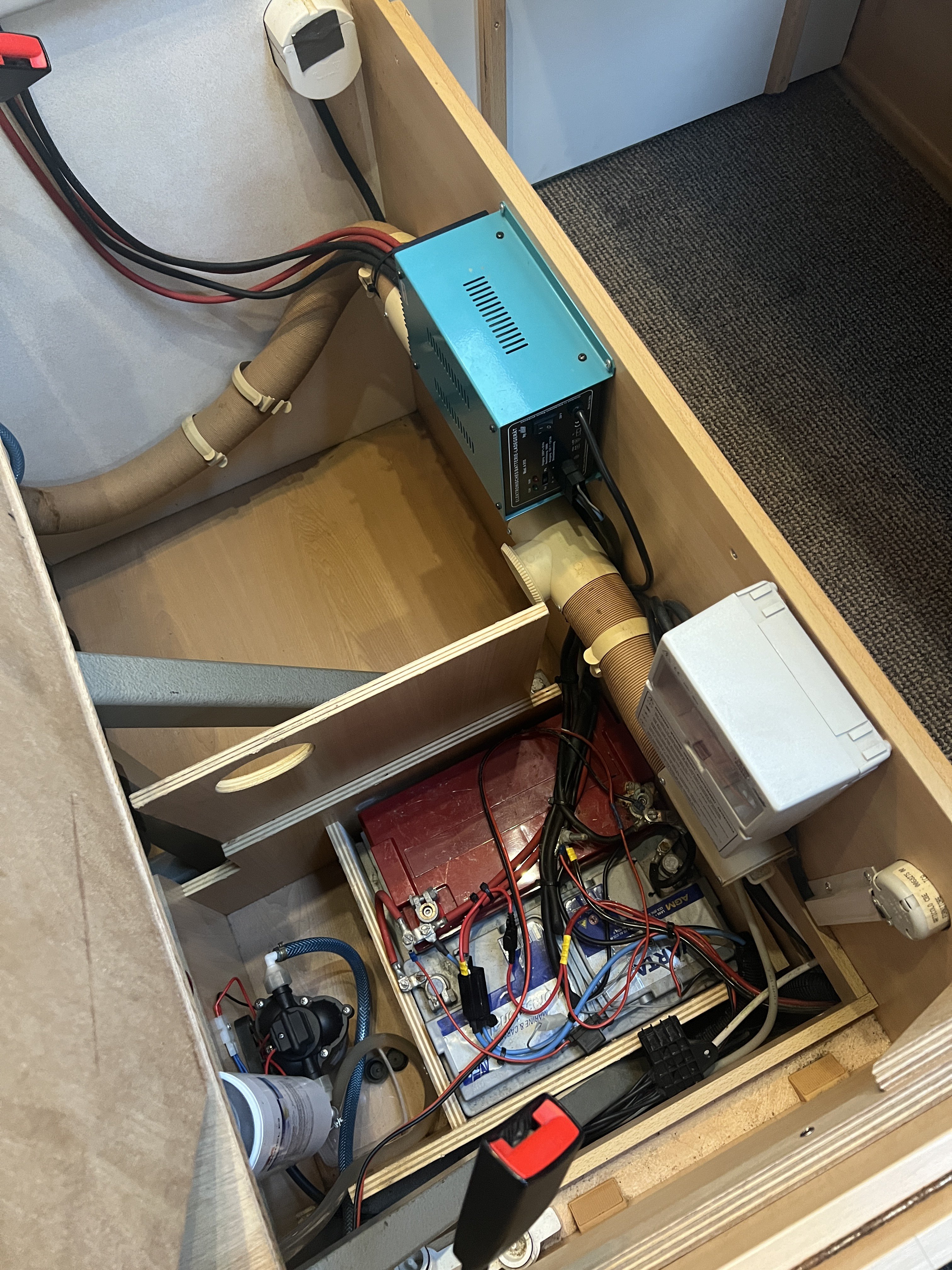

Ok, men har du lithium batterier 🔋 og booster og oplader installeret? Jeg har denne opsætning lige nu, og måske vil jeg skifte til lithiumoplader og batterier.
,The white box is 220v the other control ds510 is a another place

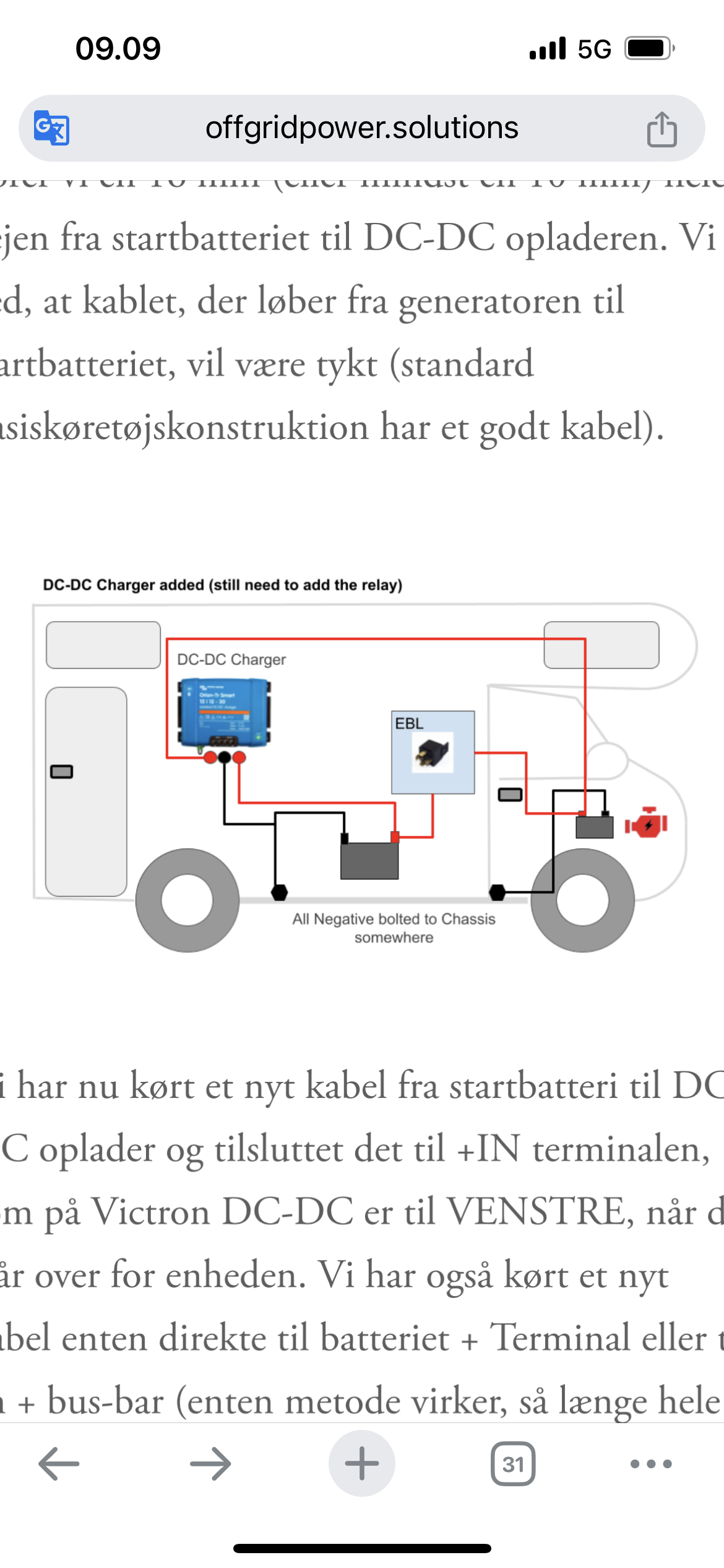

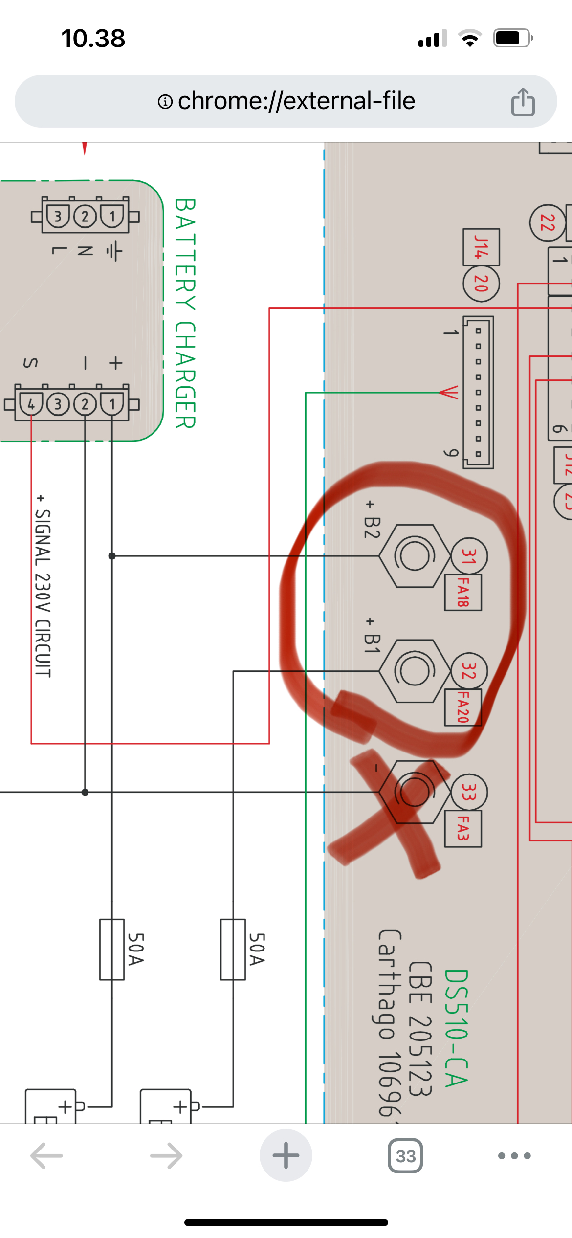

Do you know how to connect a shaudt booster for a new litium charger ? Do I have to connect a new cable from starter battery or ? To the ds510 control box
if I make it like this with a new b+ cable from start battery to dc dc charger (booster? And to liutium battery in the camper. How do I turn charging off from ebl (cbe box) to starter battery? Do I need a relay or ?
