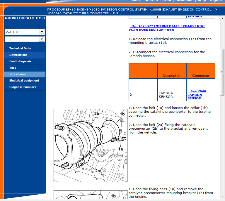

I am replacing the DPF, but bought new one together with catalytic converter in a pristine state that I would like to replace.
Do you have an idea if it needs to be replaced from the top or the bottom?
If from the bottom is it possible to take it out without removing the subframe?
This is the guy: 1349896080
Good shout thanks. I've checked it and it doesn't seem to tell much about surroundings, they simply say "undo bolts, remove the filter" and drink champagne :)
If any of you have experience with that, I would appreciate any info. Otherwise I guess I will have to deal with it somehow on the cold evening outside.
