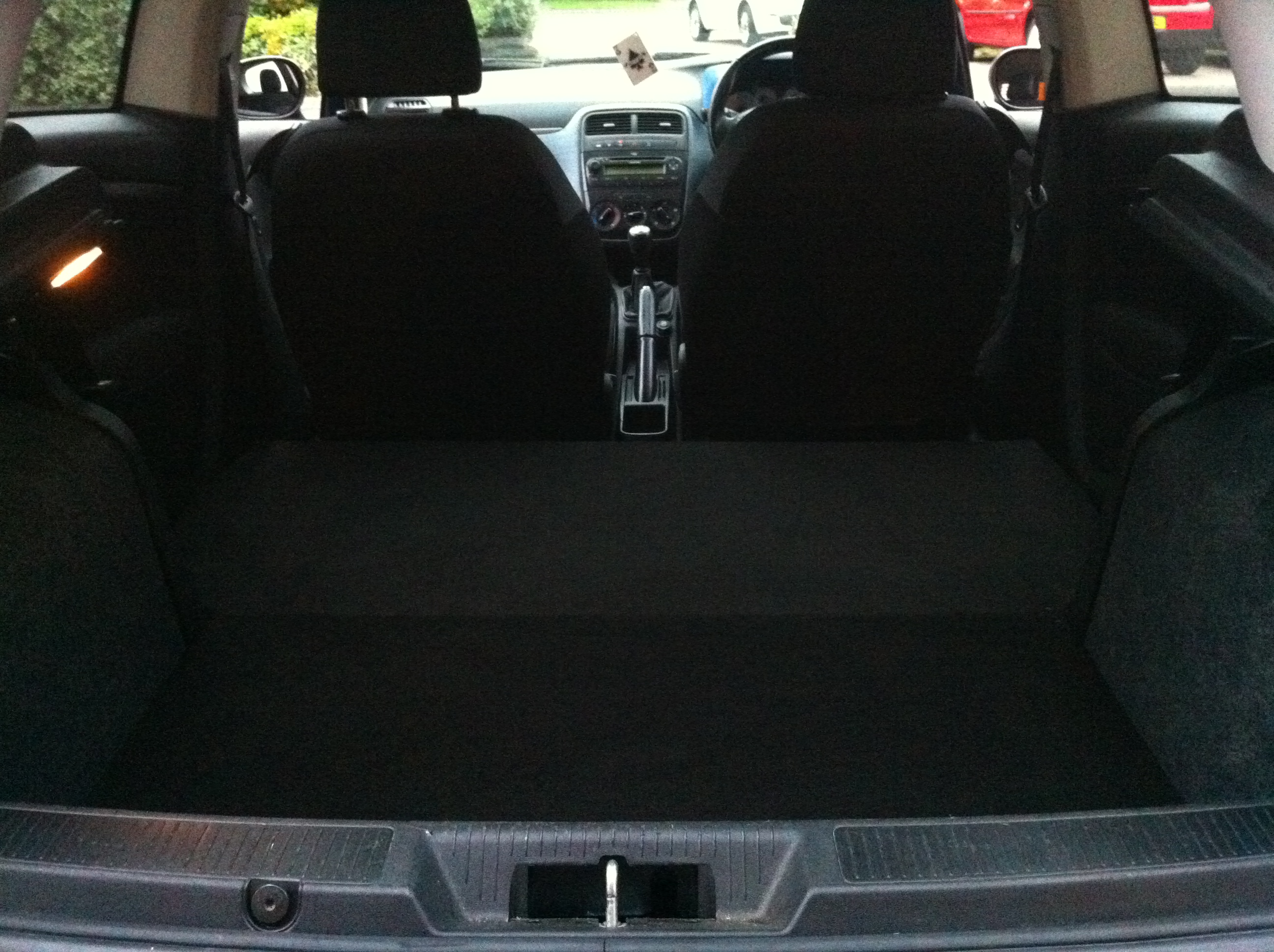

One of the things I was doing over the summer as I mentioned a few pages back was building a carpeted false floor for the boot, which is now done:

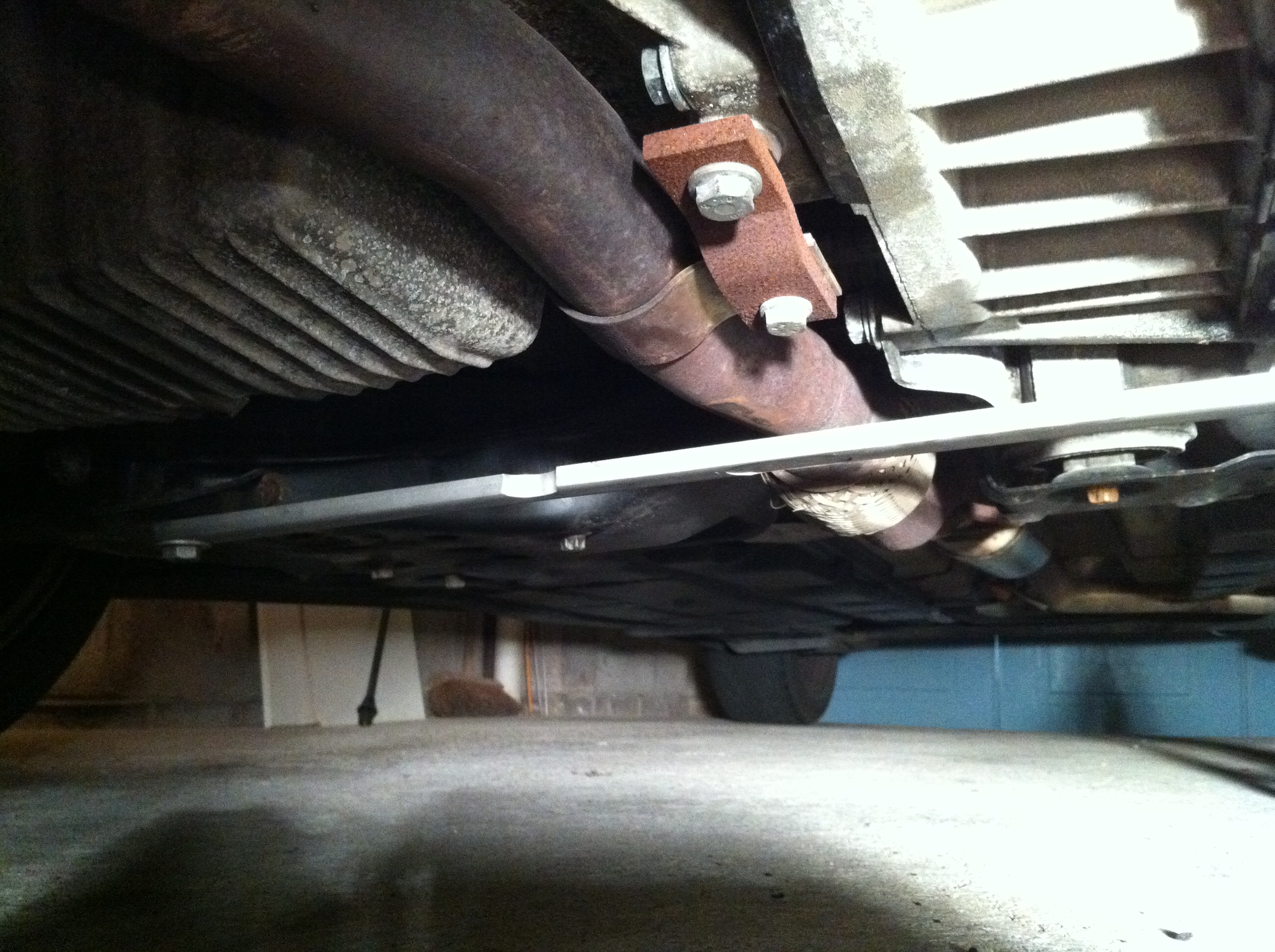

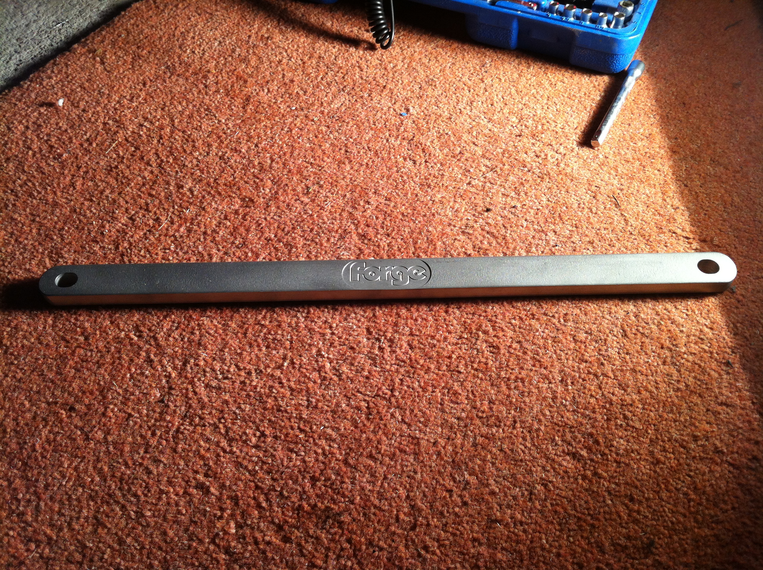

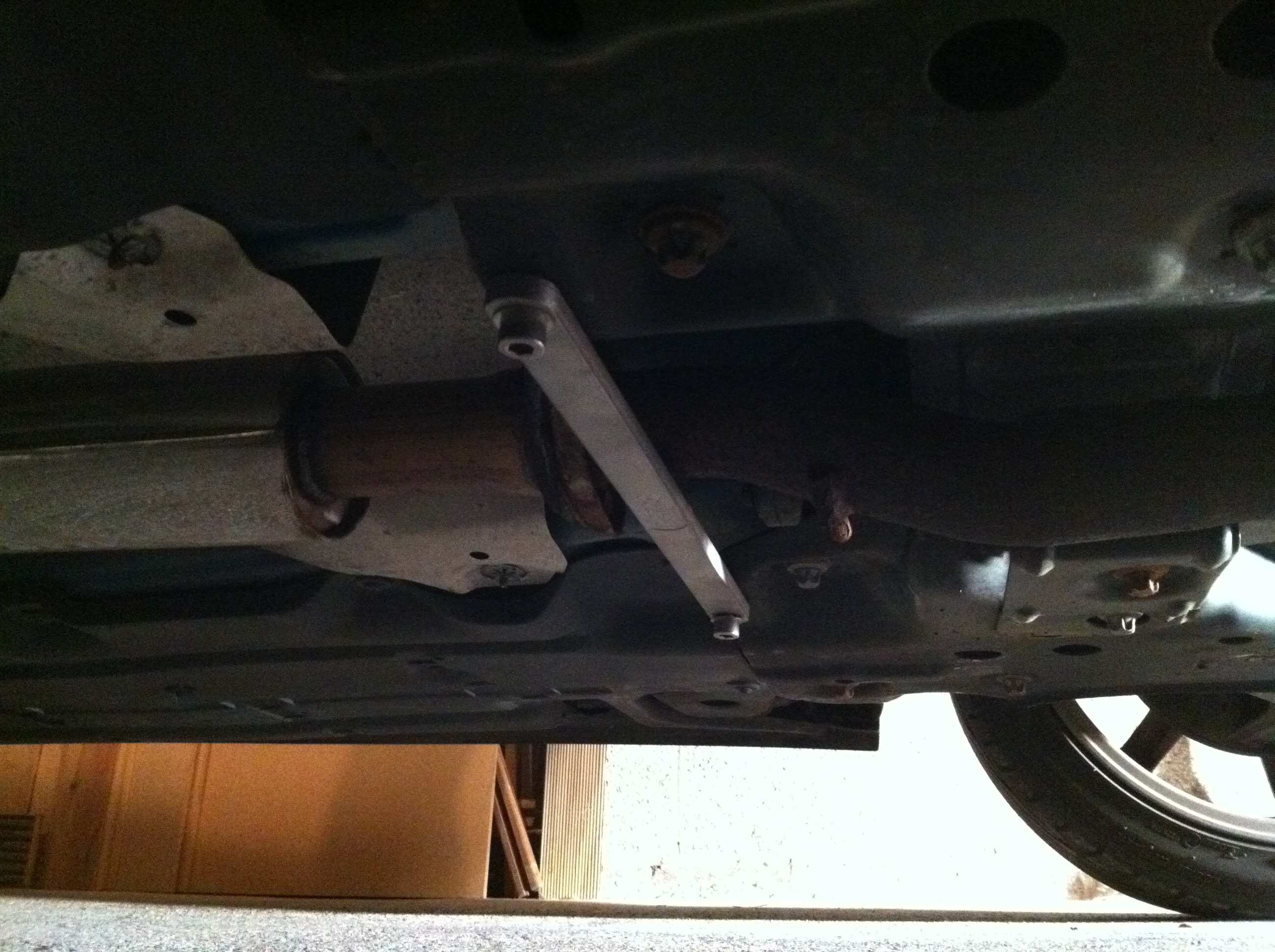

Next up, I was sick of having to listen to the subframe bracer bar rattle against my exhaust after bending it back numerous times, so I bit the bullet and bought some Forge Subframe braces. The big one replaced the bent one and the smaller one is just to stiffen up the chassis a bit more.
I can actually feel a difference in the handling now as well, it's minor though, not sure if the braces are worth it for everyday normal driving, but I'll be happy as long as they don't bend like the stock one did!

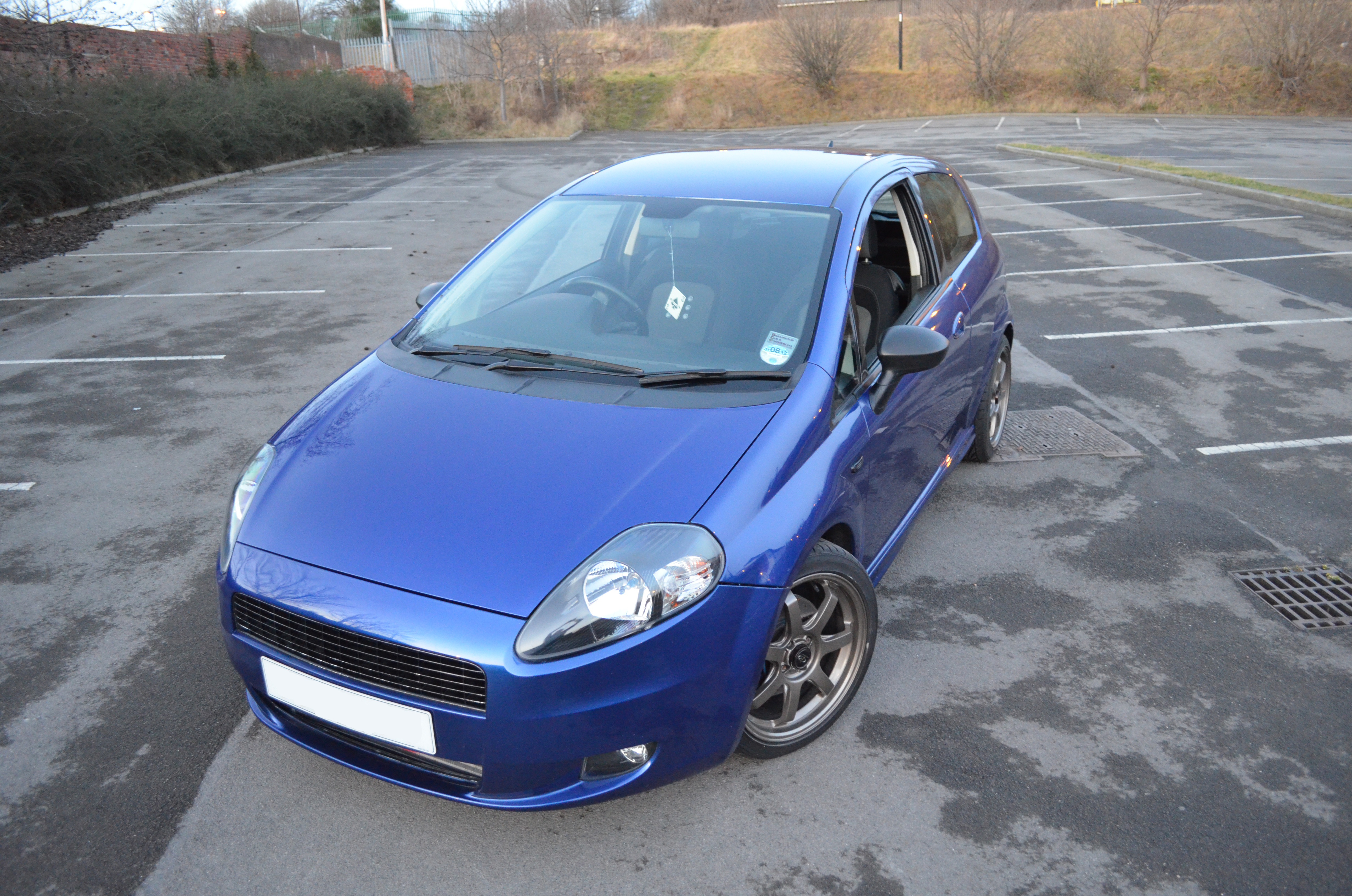

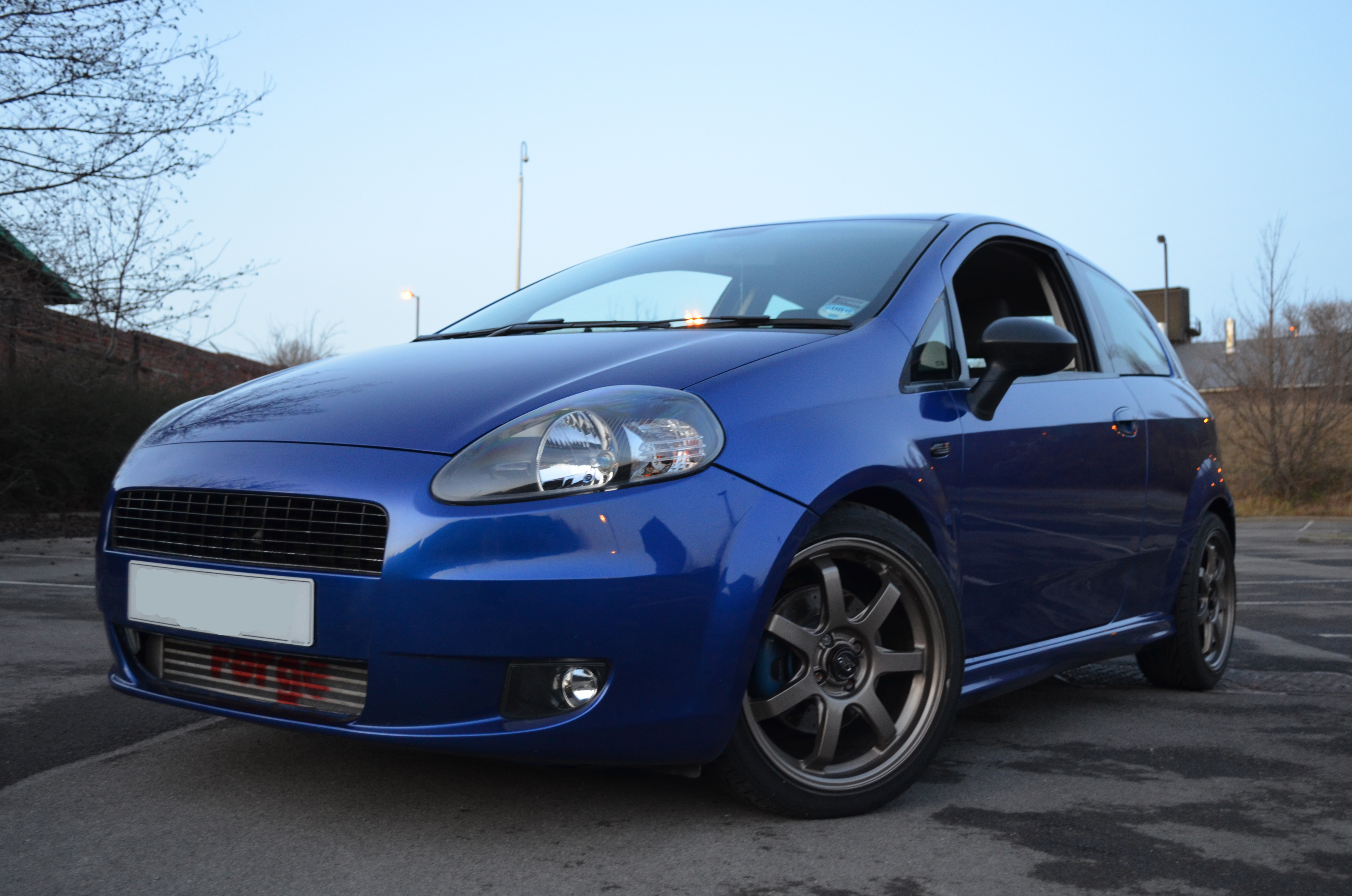

Finally, the latest update. After a great deal of messing about and being indecisive, I got some Abarth Headlights, and I have to say I really do prefer them now. They were actually easier to fit than I thought, which was handy, because in total I had to fit them twice, because the first time I fitted them the connector plugs had moved out of place and I couldn't re-align it with the lights on the car :bang:.

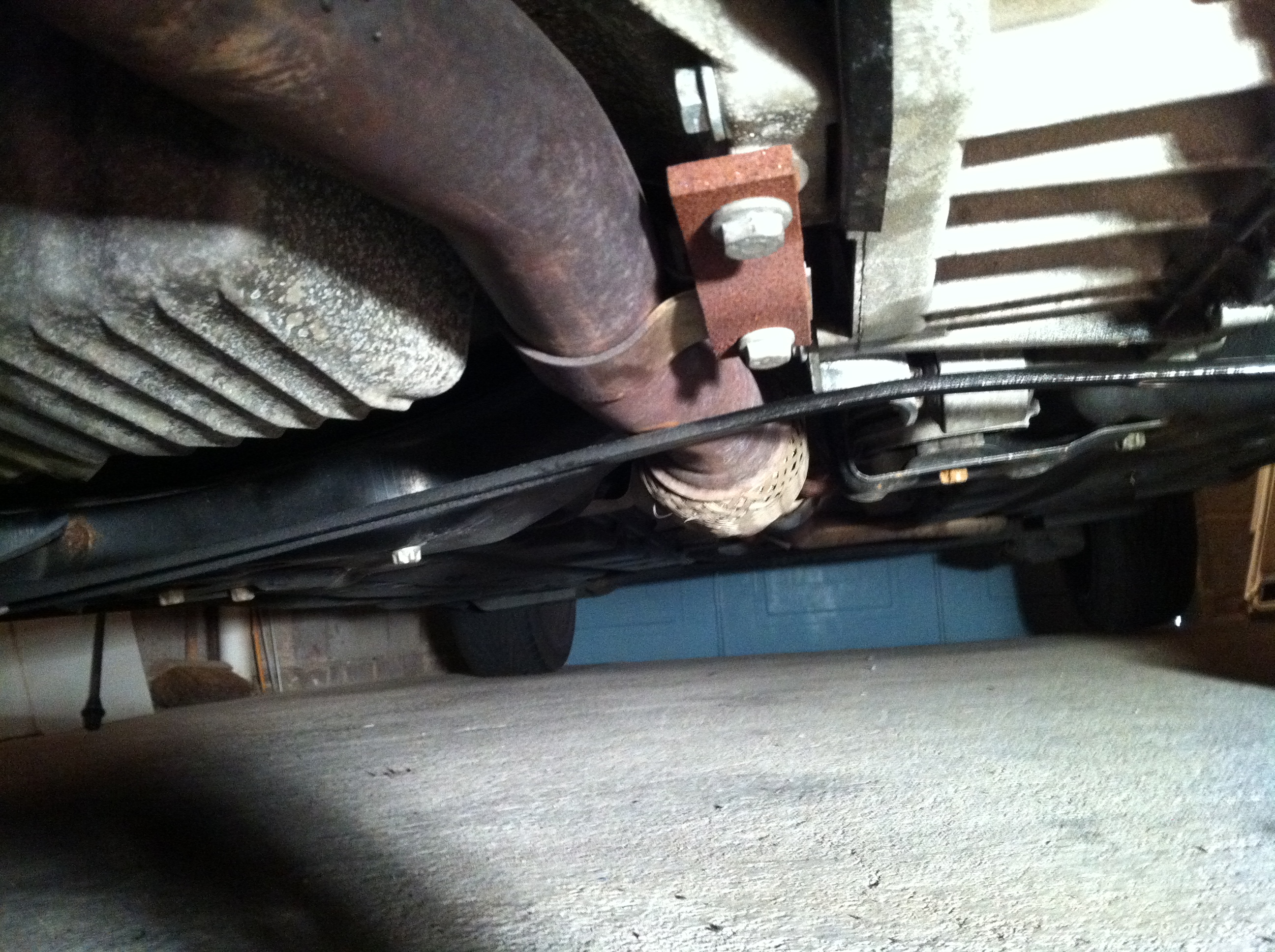

Unfortunately I don't have a good picture of them yet with the weather being bad and all, but here is one I took recently while I was doing some other work to the car. (Can you guess what? ;))
Anyway that's it for now, I'll hopefully have a big update coming in the new year once I get it back on the rolling road with the new engine mods. :D

oh and i guess your finally fitting the decat pipe, was it hard to fit the forge heater/water hoses?
You're correct! :p
The Boost/Coolant hoses weren't 'hard' to fit, just a pain. Removing the old clips was annoying, some are properly awkward to get off. Some of the new hoses are a tight fit as well. It would probably be helpful to soak the coolant hoses in a dish of hot water first to make them more flexible and easy to get on.
