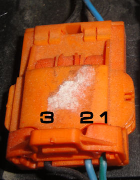

Hey guys
Can someone post a picture of the wires going into the connector block and out? Trying to try out bypassing the block but the previous guy already removed it so just wanna set if he has connected the right wires back together.
Also, can someone advise me where all the connectors are on the car that could be causing the issue? Only got a Bluetooth OBD and my fiatecuscan doesn't scan the airbag due to incorrect connectors?

Hey guys
Right - finally got my adaptor through and modified it. Connected to the airbag successfully and removed various errors, one remains
Side airbag (Driver) - short circuit at ground.
Now my thoughts are it could be wired wrongly. The previous owner bypassed the orange block connector on this one and I think may have connected them back wrongly. Would this read a short?
Can someone please post the wire colourings for before & after the block on the drivers side?
Thank you
