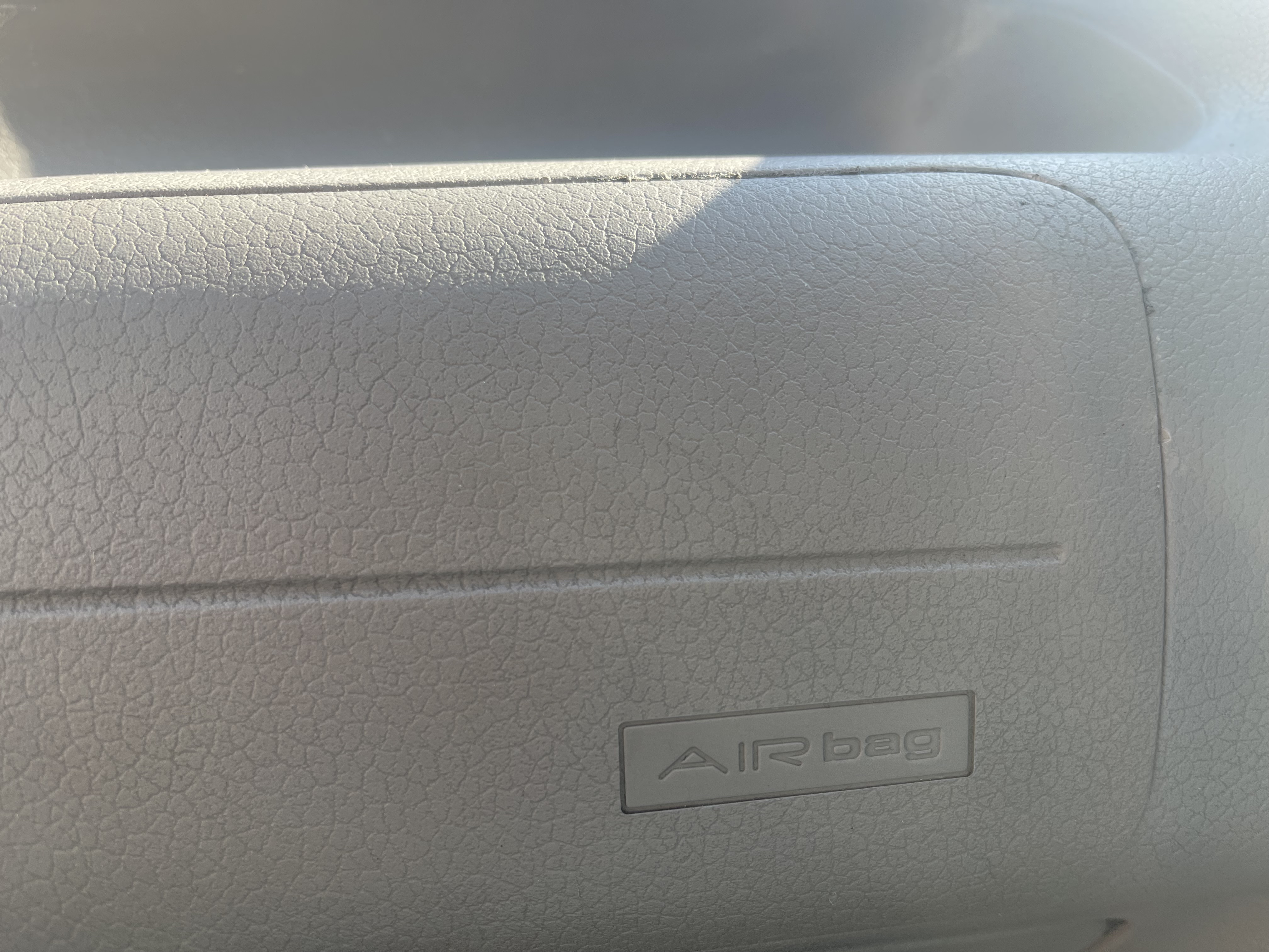

Afternoon, I have followed the posts pertaining to the airbag dash rattle, and this is my contribution…
My 2005 Panda Multijet was bought with the rattle already present,however sometimes very faint,othertimes almost a knocking sound.
I disconnected the battery,switched on lights to drain any residual charge and had a coffee.20 minutes later I started.
Removed glove box and literally explored behind by hand,found nothing loose.
I then took a flat screwdriver,gently seperated the plastig AIRBAG cover from the main dash at the top right corner where the soft rattle noise was coming from. (Very little seperation as it is a fixed unit).
Forced in some very thin double sided tape and pressed it together again for a few seconds. Trimmed off the excess tape….NO MORE NOISE…..at all.
Sure hope this may help someone.👍🏻
