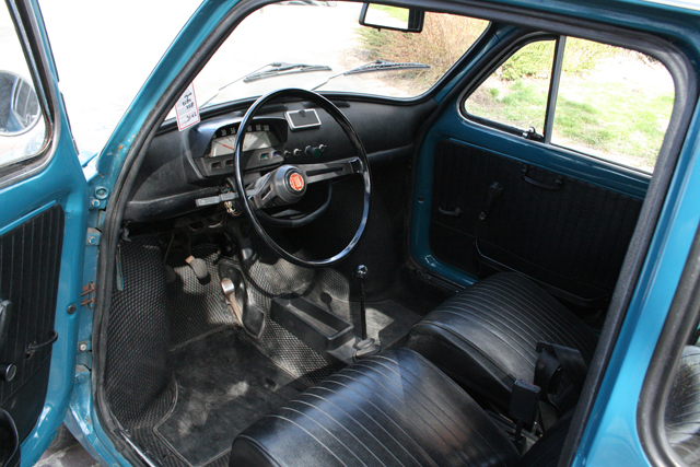

Hi, yeah I completely agree. It seems such a shame hiding that lovely painted metal dash under the not so pretty black plastic. I have found another thread here where some people have removed the black cover and I think it looks great.hi there no not as yet still looking for information. Like you love the retro look of the metal dash on the earlier fiat 500s not so keen on the plastic cover they put on over the metal one to give it a 1970s "L". I had heard that it was possible but for the life of me cannot find anything anywhere. Just want to remove the plastic either side of the square speedo keeping the speedo as in place if you find out anything let me know, and likewise will let you too
so since the last message my husband has successfully removed the black plastic cover revealing a lovely red shiny metal dash. How did he do it.. fin a nutshell firstly remove the speedo and gauges by the two tiny metal clips that you can see underneath the speedo box itself. They are hard to see but it you get down and peer underneath you should find them. The two clips need pushing up ( use a small blade) and this realises the speedo box. Undo the speedo cable and the two wire sockets then speedo head comes away. Undo three switches on the plastic dash (no need to remove wires on those) pull out the ashtray and door seals on the edges of plastic dash driver and passenger side. This will allow you to gently ease the plastic cover out above the padded rail along the bottom edge and then it will drop down away from the windscreen rubber. The reconnect everything you have unfastened (the black padded section stays in place) the speedo box will then simply push back into the slot and the metal clips with hold in possition, and you are then left with a nice enamel dash ...good luckHi, yeah I completely agree. It seems such a shame hiding that lovely painted metal dash under the not so pretty black plastic. I have found another thread here where some people have removed the black cover and I think it looks great.
