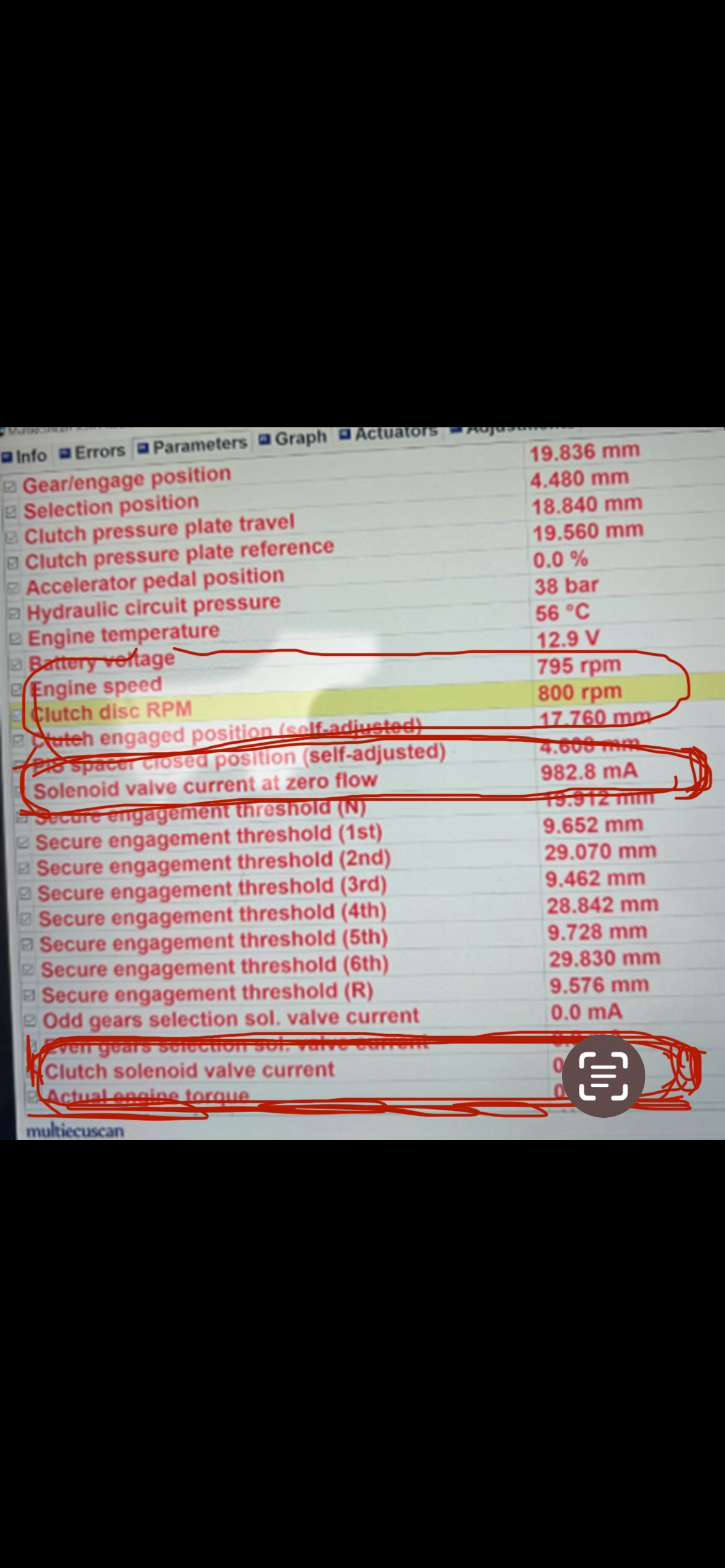

I have a 2008 Fiat Ducato Motorhome, 160 Multijet, 3.0 litre diesel. The old "Gear unselectable". In a Sydney Fiat Professional workshop since October and still unable to drive ?. Changed the Hydraulic Unit, Slave cylinder, Gearbox ECU, Wiring loom, all four "4" Gearbox Solenoids, Gearbox was removed & clutch is good as it was changed about 15,000KM ago. Got them a donor gearbox for parts. They say the gear box is OK but the clutch will not move and drive. Any one had a problem similar to mine and got it fixed, if so how and where. Never get a FIAT DUCATO again.
Hmm... Seems like your real BIG issue is not the actual vehicle, but the "workshop". Any place that fires a parts canon and after 6 months has not found and fixed the issue should not be in the business. There are numerous issues than can cause the fault, but a trained expert with the level of diagnostics that FIATPRO have should locate the issue pretty quickly I would think. Have you thought about getting the vehicle to another workshop? If you have the skills, perhaps get a copy of MES and see what you can find yourself. Very hard to offer any help if there is no data to look at.
