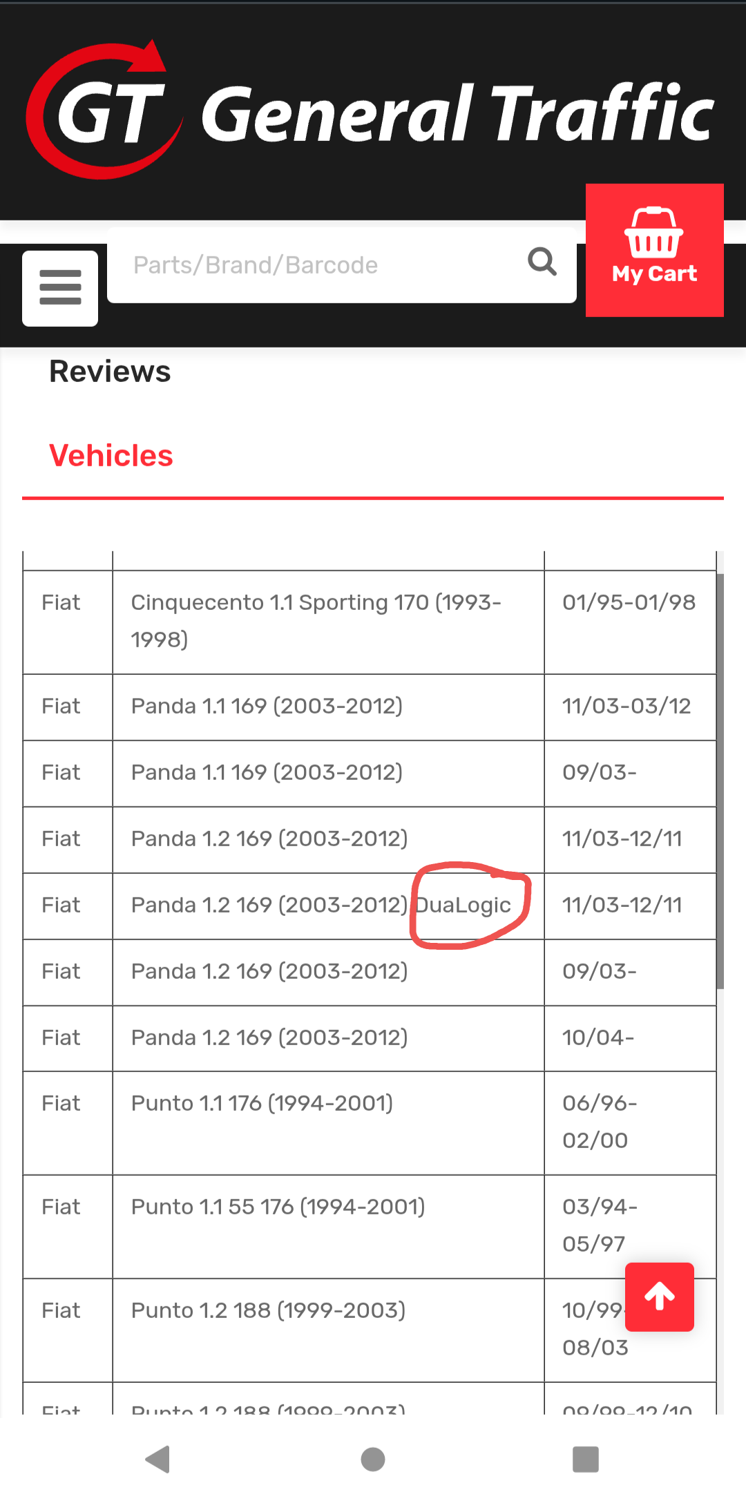

Is the only listing I could find that mention it

I'd message the vendor before ordering, to be double sure, but it would appear to be the same
