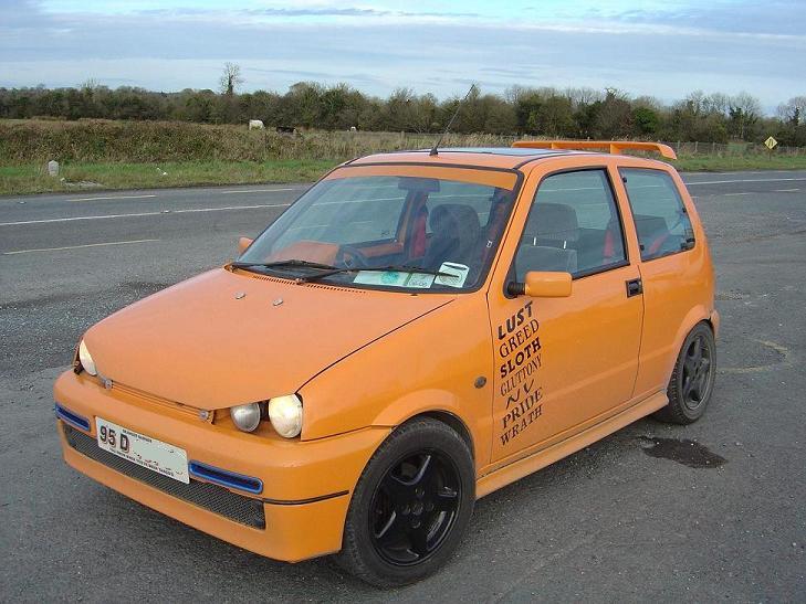

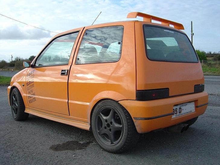

Fitted chip last weekend to 1242 8v with Tricker TB. Not an easy job to de-solder old chip but I had a spare ecu from a breakers. Car is smoother and pulls cleanly from tickover - well worth the price for the improvement to the car. My MAP sensor went bang on the way home yesterday but I doubt the two are related - new sensor fitted this evening and car running like a dream (for a few days anyway!!)
Top marks to Mckrich for a simple performance mod.
