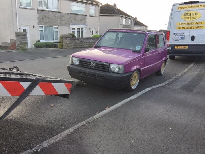

atm heres how it stood up untill last week , only real issues are that its been off the road for two years ,at the time the front caliper was sticking and the rear beam center bush was knocking its balls off. apart from that its a solid , unwelded , one owner car with 66k on the clock.

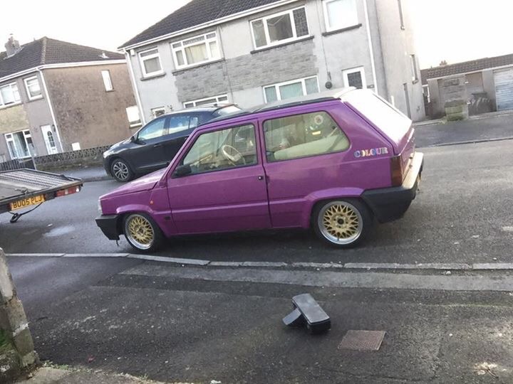

Good to see it progressing, had to abandon my 15's on the colour as the rears rubbed.
Pity I couldn't keep the graphics on mine though the funky seats and interior went so wasn't much left that was original colour except the instrument pod.
Will those front wheels actually turn okay?
Glad the misguided VW alloys have gone, the period X-wires you found do look better. Uno Turbo alloys would have been nice too... 155 tyres max (65 or 70 profile).
Mind the rear shocks don't grind away the inside of your back wheels when you've got a rear passenger.

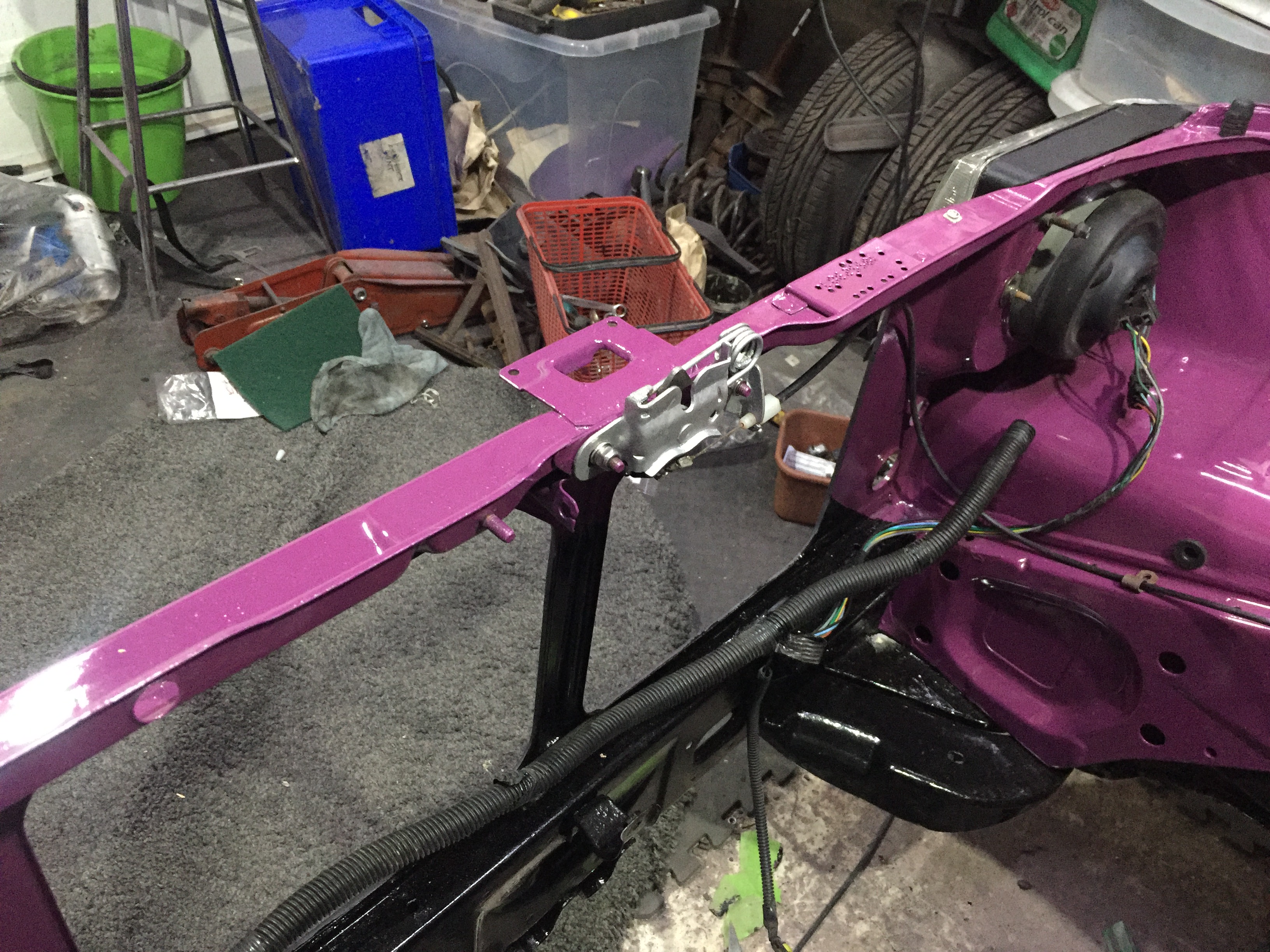

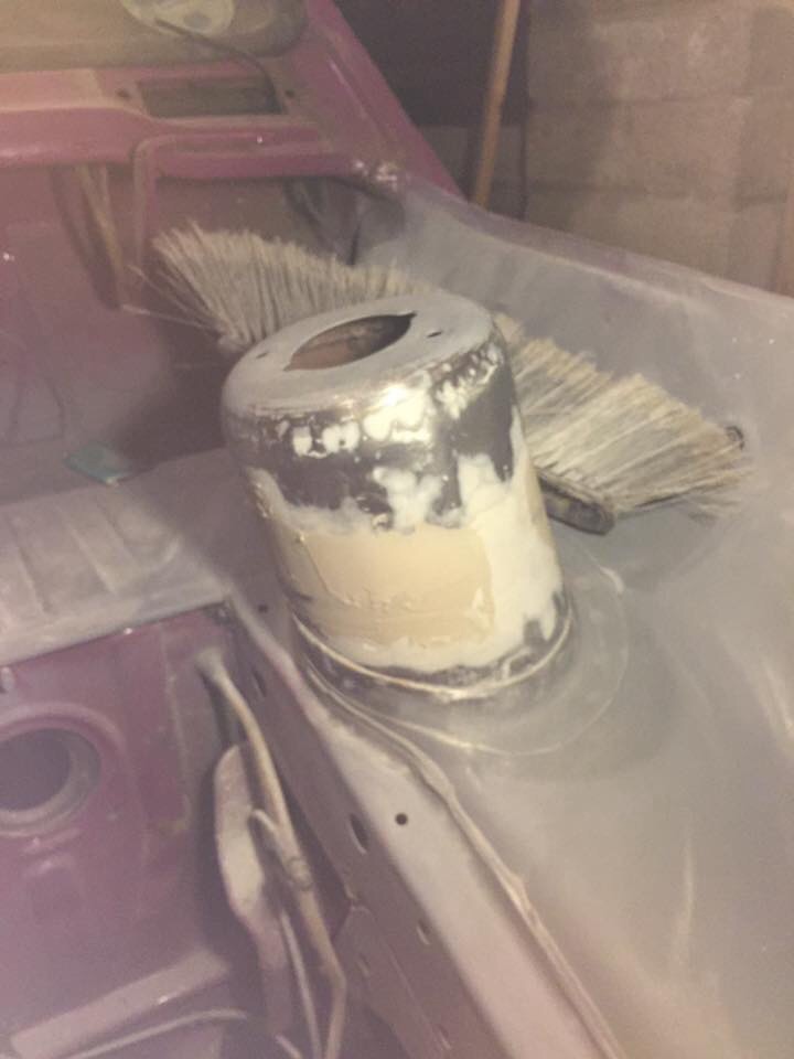

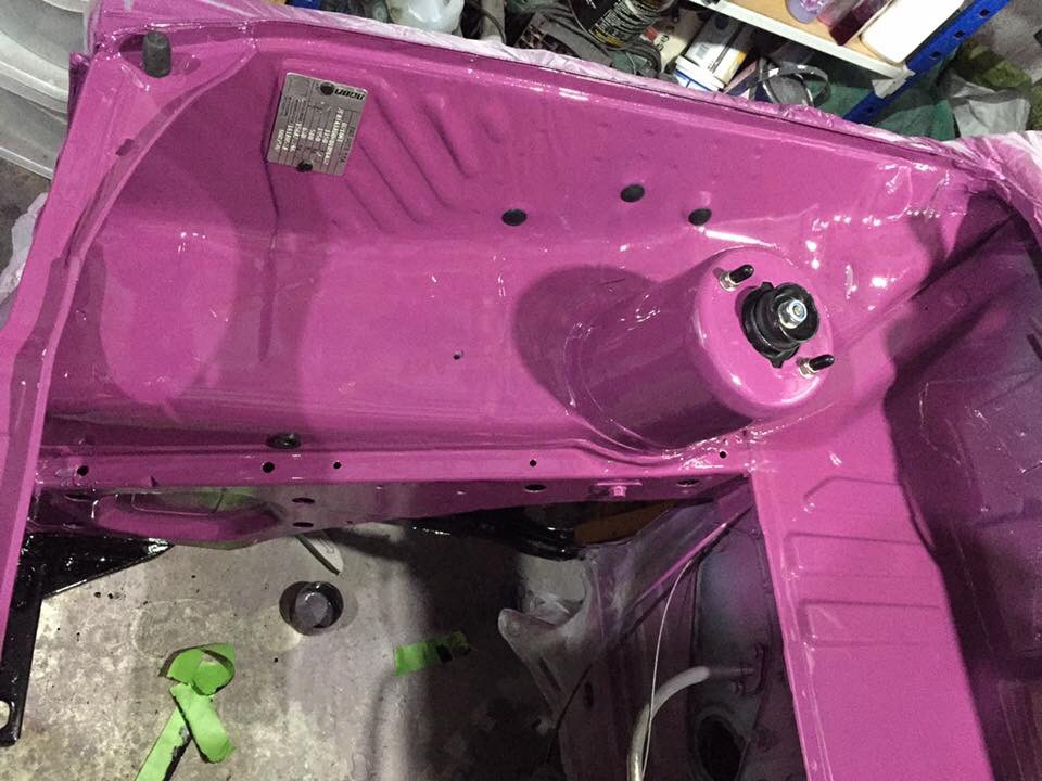

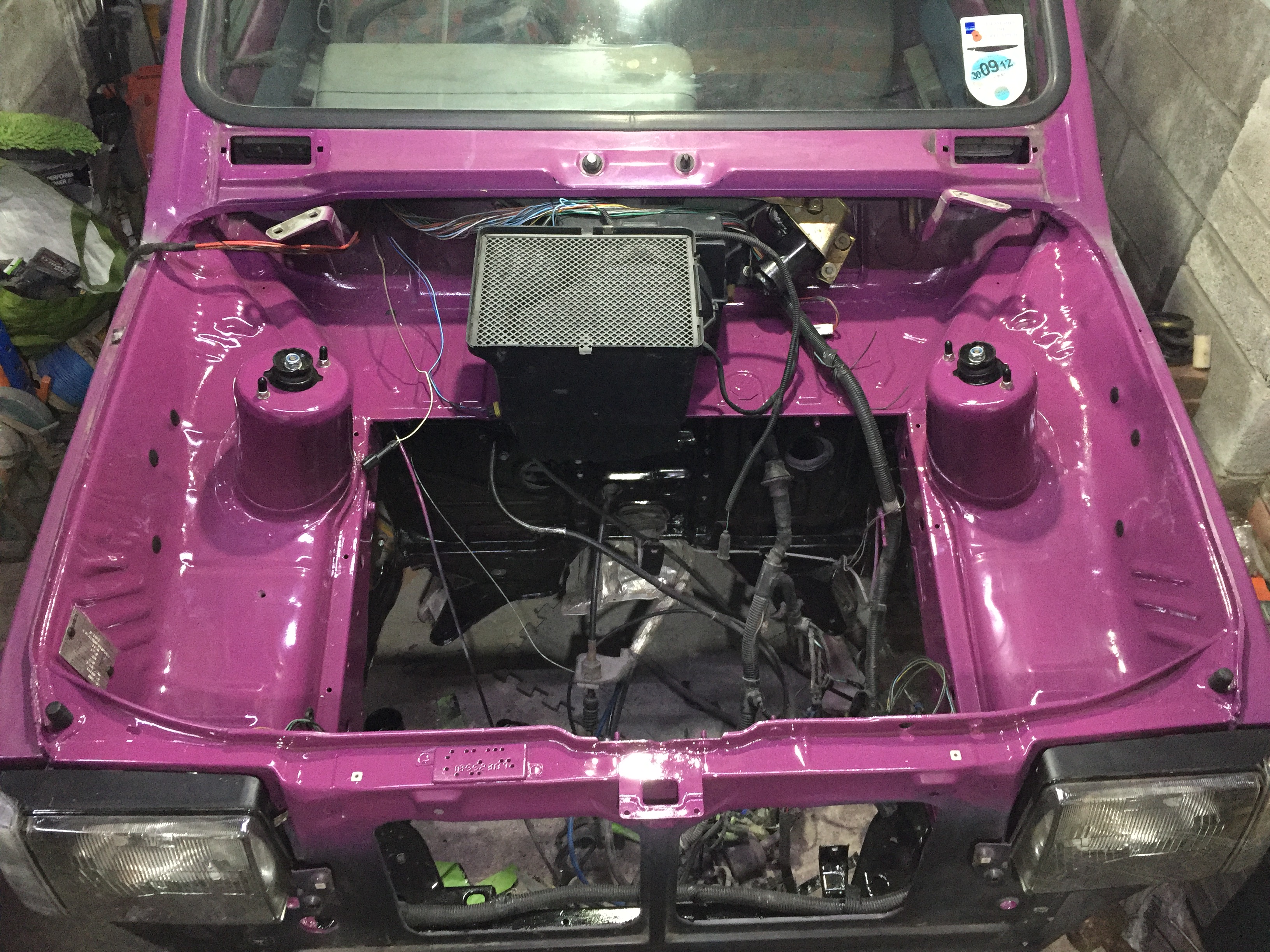

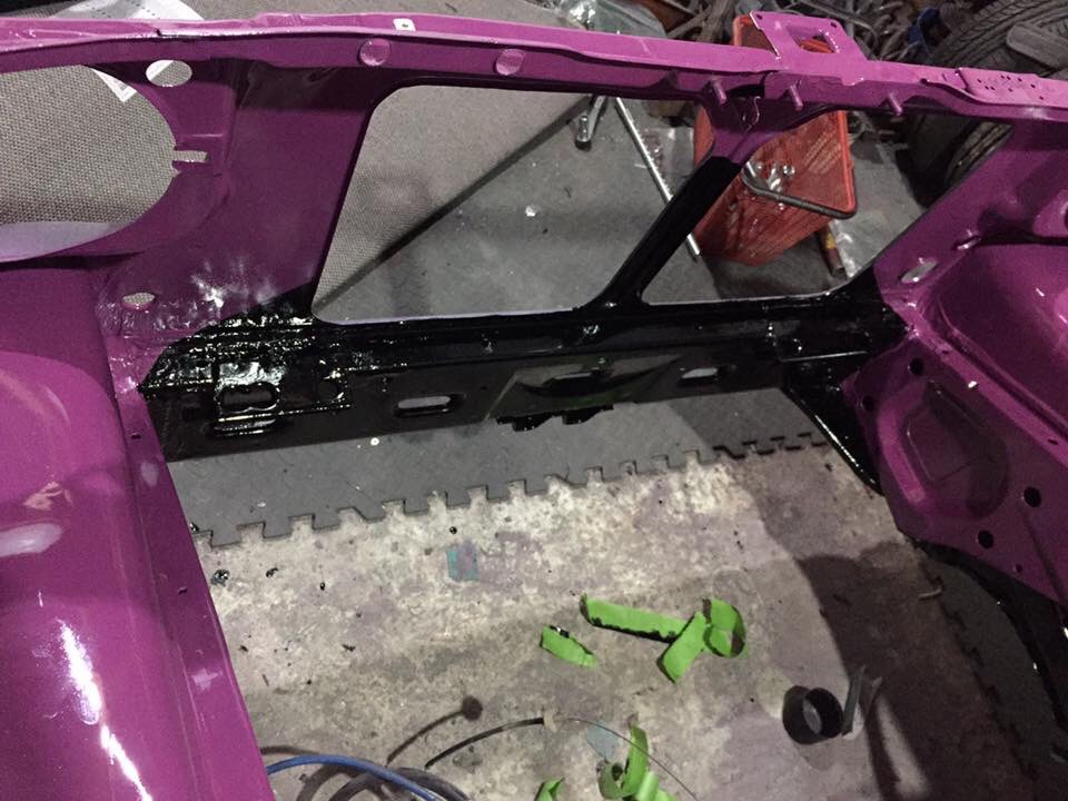

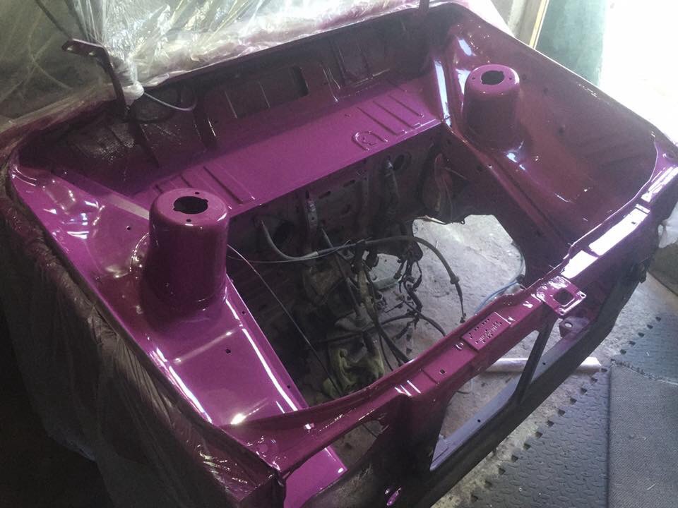

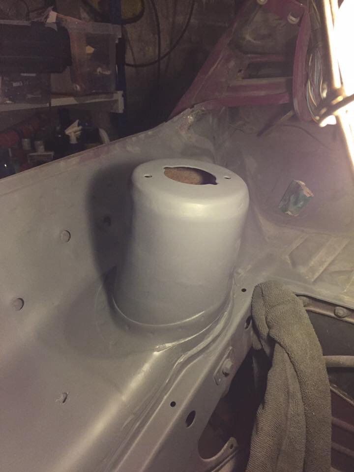

Got the engine bay all etch primed ready for paint
Then finally got some paint down

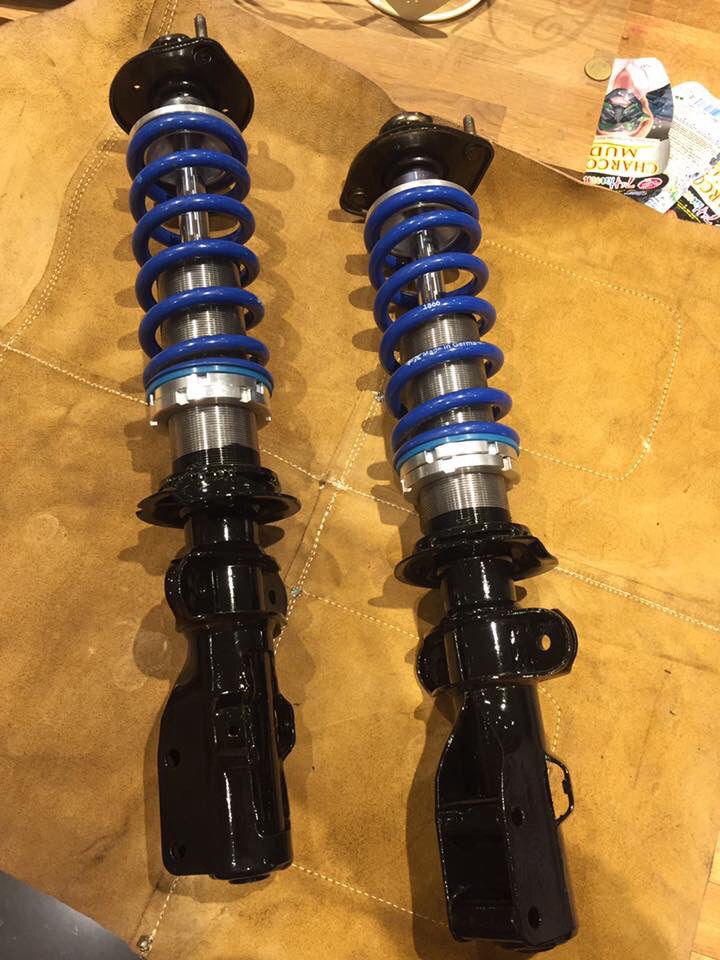

Got the coilovers welded and painted up

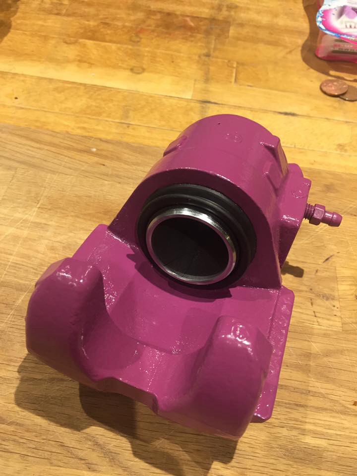

Rebuilt the calipers with all new seals and Pistons, also stainless nipples (not fitted in pic)
Now I'm slowly putting it all back together , heater box is back in and it's finally making good progress, ready for the engine to go in from the siecento sporting I've bought :slayer:
Started to put the car back together now

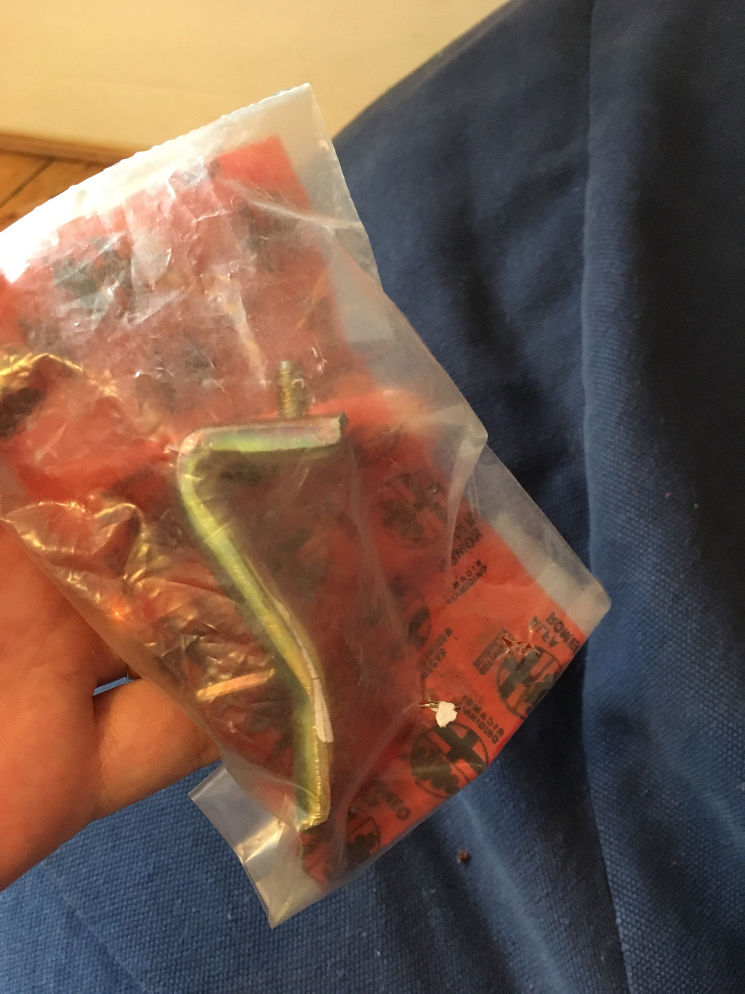

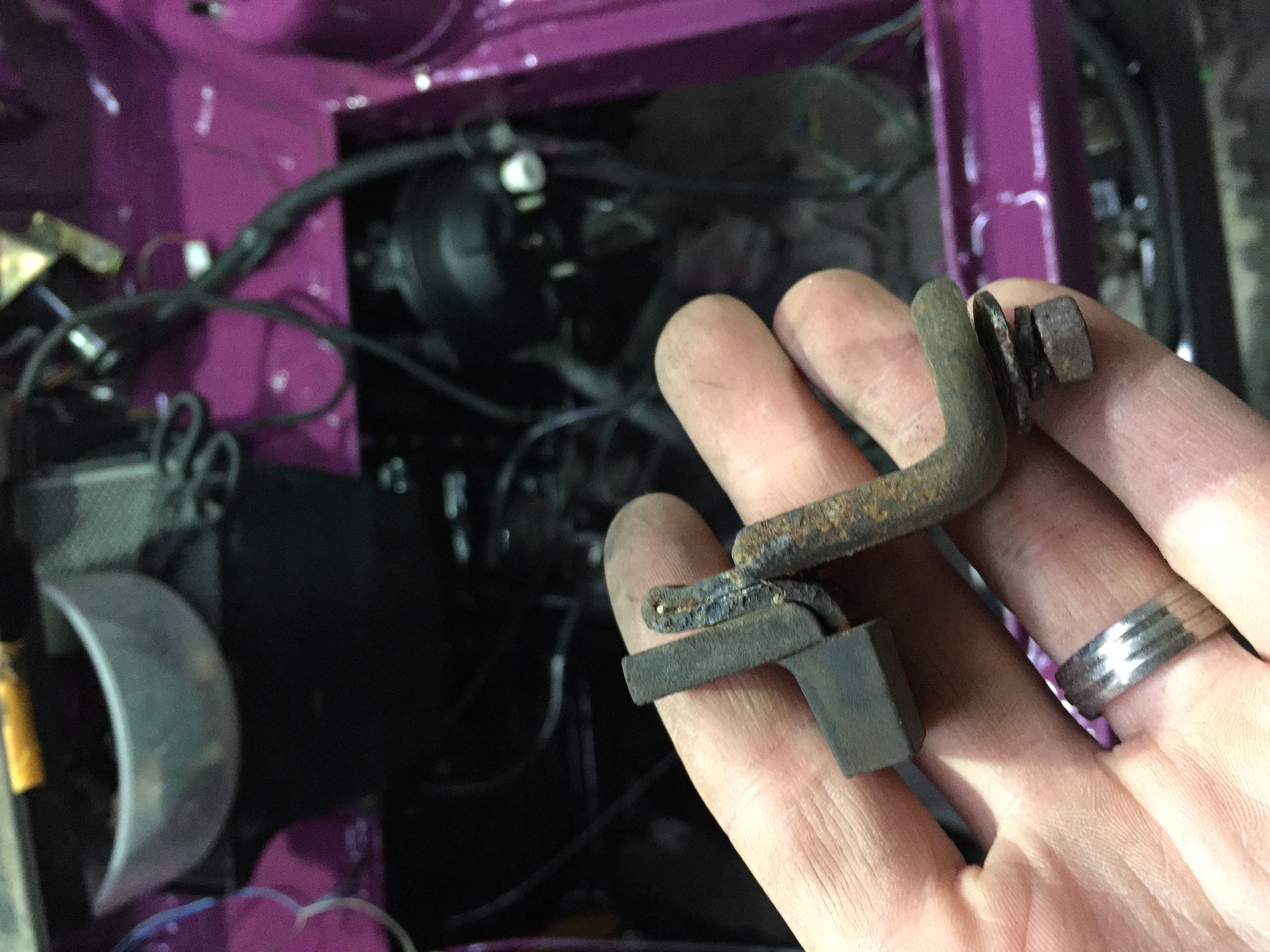

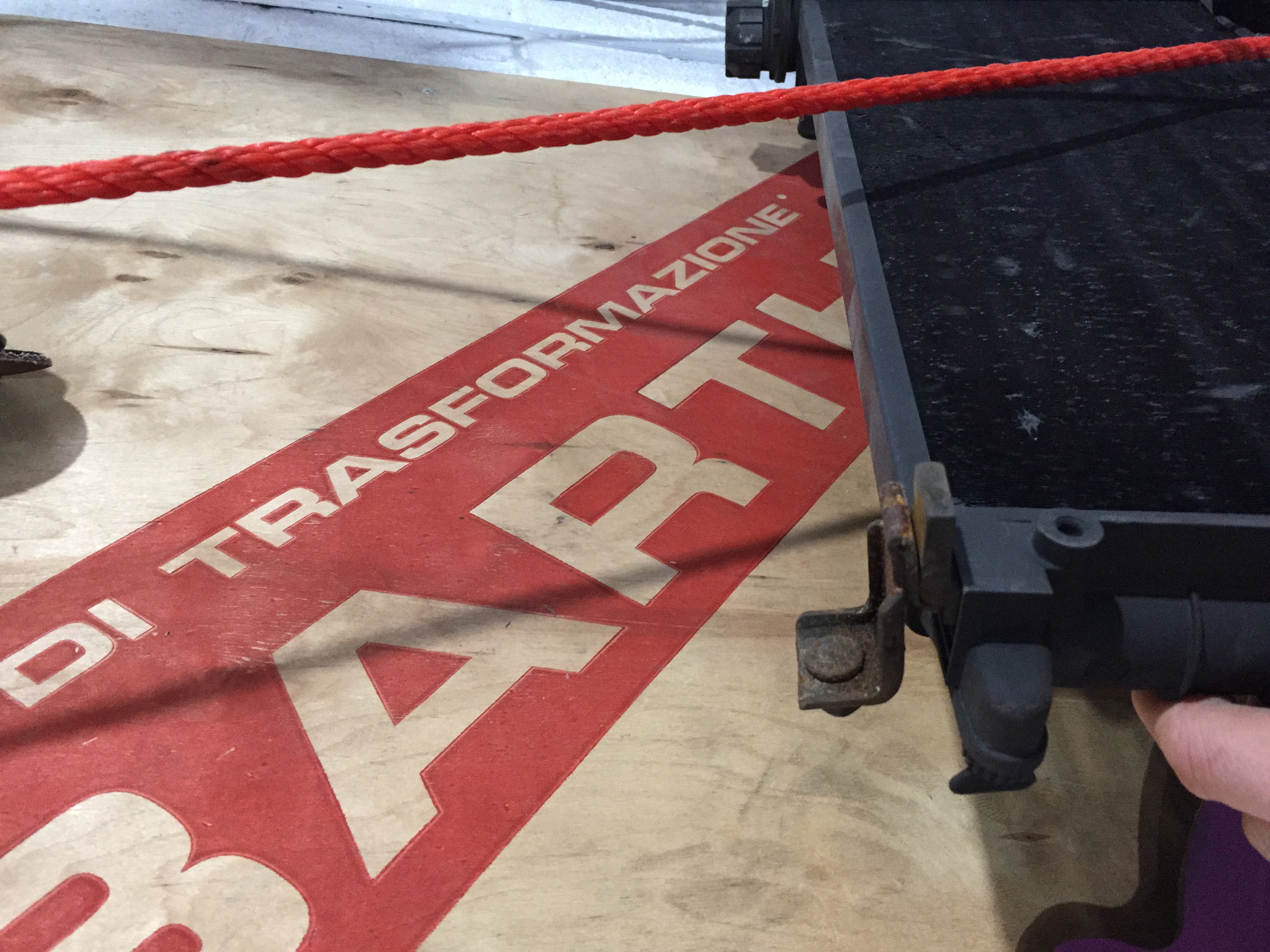

I'm missing a radiator bracket like the one below?

I am pretty sure I still have a brand new bracket. I will try and dig it out for you. They can be ordered direct from a local fiat dealer. Was about £4 when I thought I needed one. Turns out I didn’t. :)

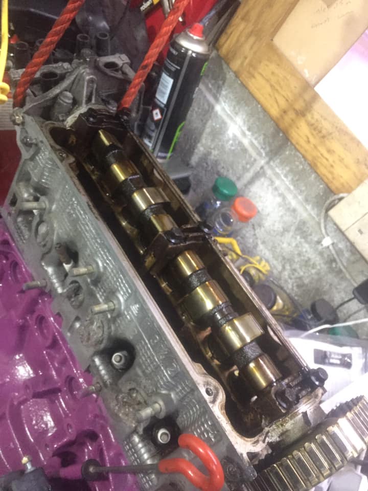

866 Cam fitted

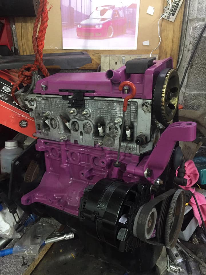

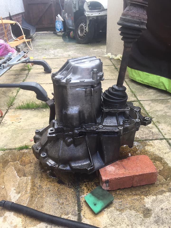

painted the 1108 from the donor car, New timing belt,water pump, cam seal, rocker cover gasket,and clutch

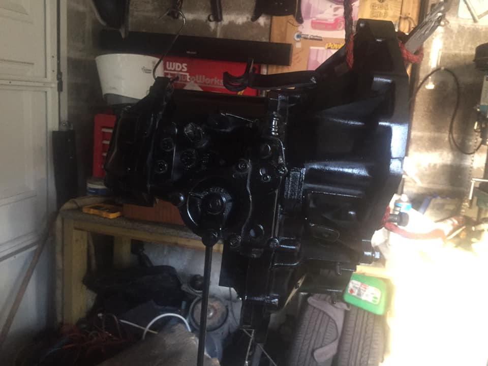

Cleaned and painted the gearbox

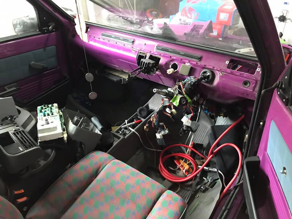

pulled the dash out for a clean and used the extra access to get my battery cable ran for my relocation,

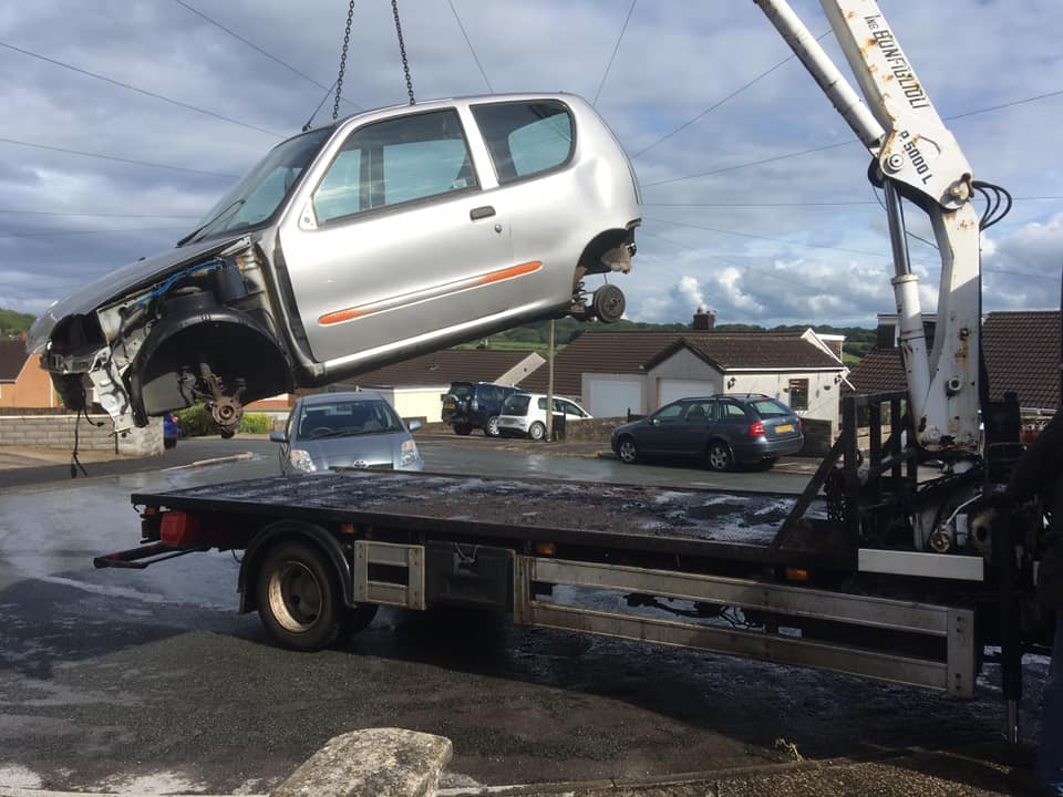

bye bye siecento!

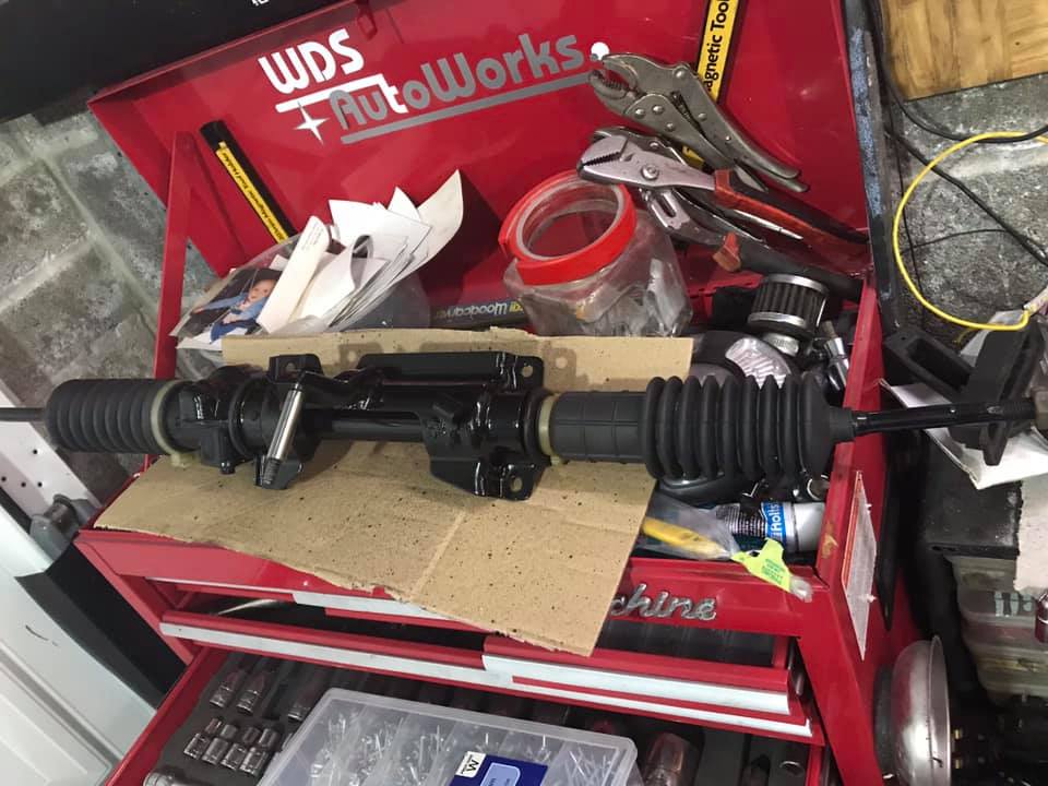

steering rack referbed, new gaiters and grease

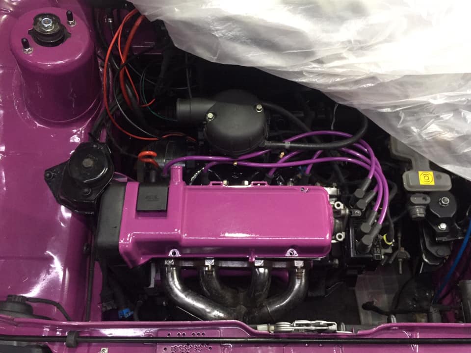

Stainless 4 branch Manifold

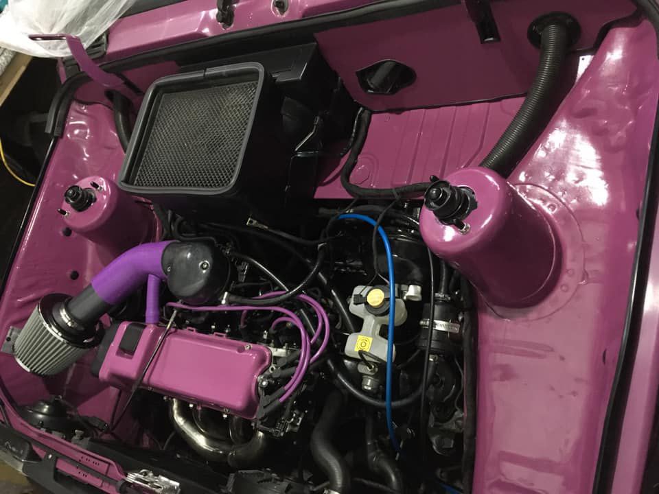

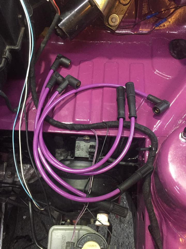

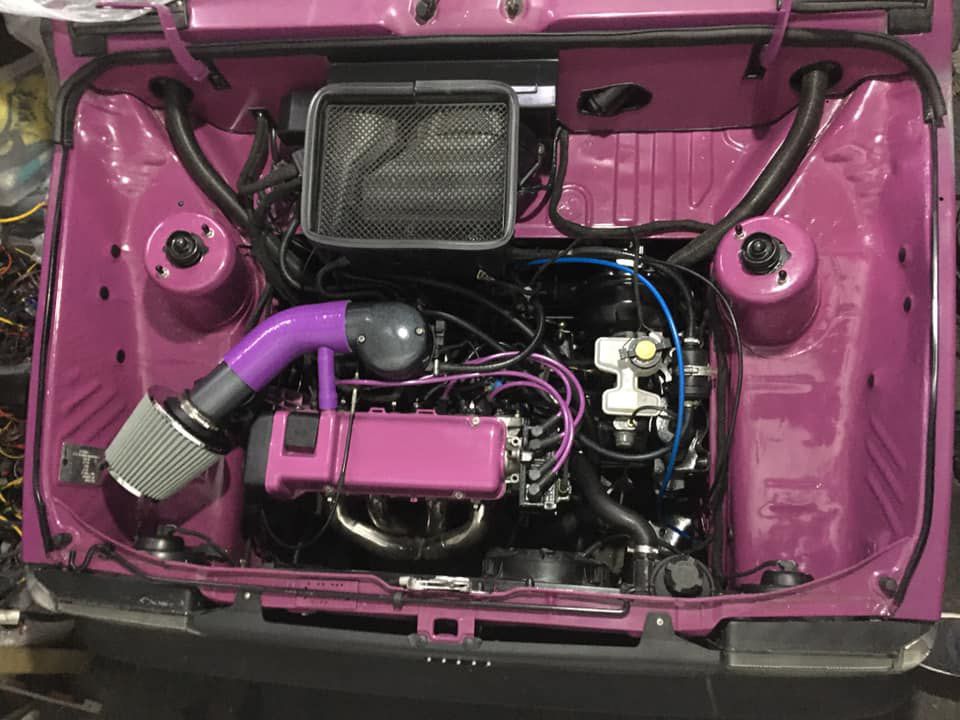

Engine almost all together. ( 50/50 on the yellow lights )
the white bits at the back are templates for some aluminium covers im making to tidy the bay up some more,

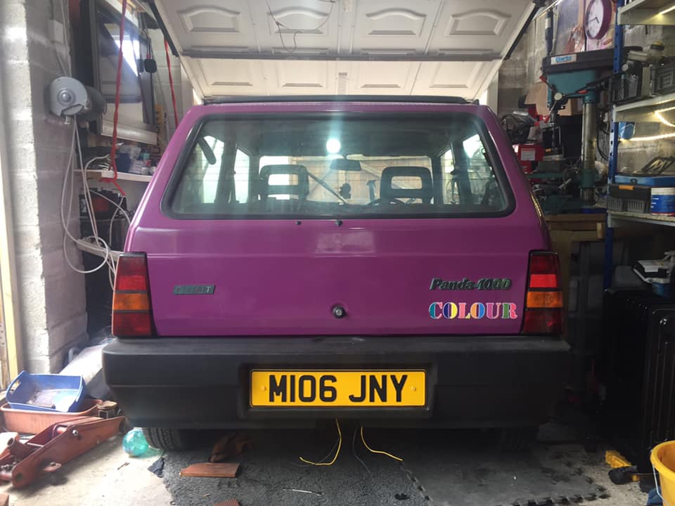

got my Italian rear light in too, Reverse lights are overrated

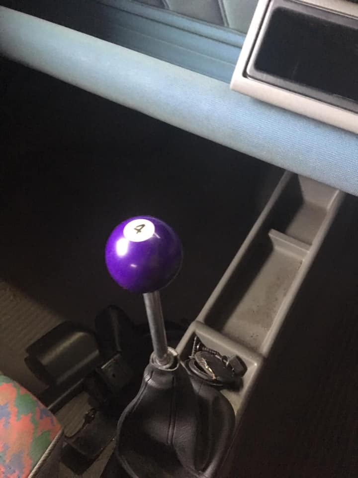

My new gear knob

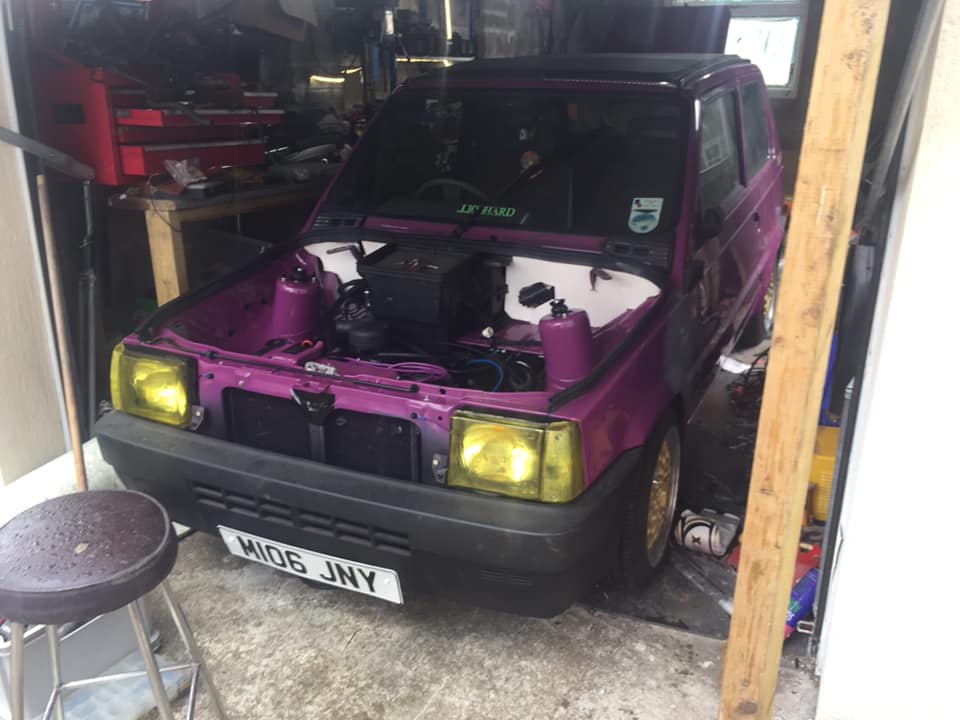

This is where we are to date, coilovers are all fitted, new brakes and just got to fit brake lines, connect up fuel and add coolant, oil and driveshafts and rear brakes and exhaust ......the list is surprisingly still pretty long but I'm too fussy to just throw it together so if im lucky it may be finished by next year , hopefully.

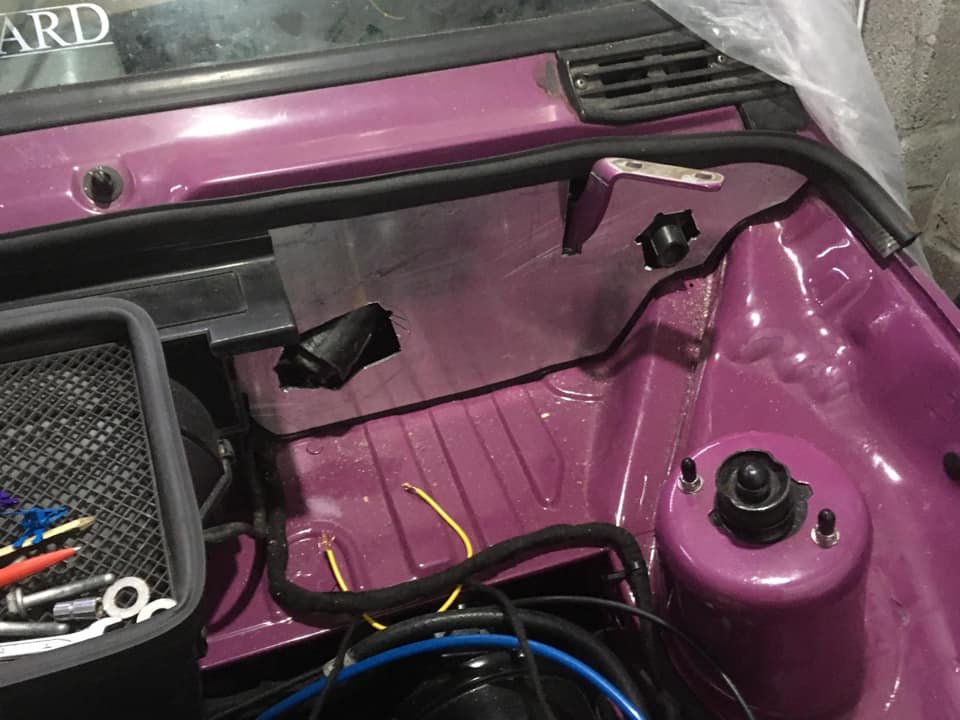

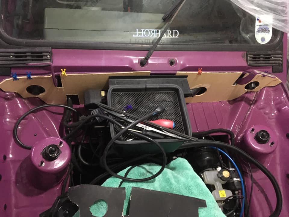

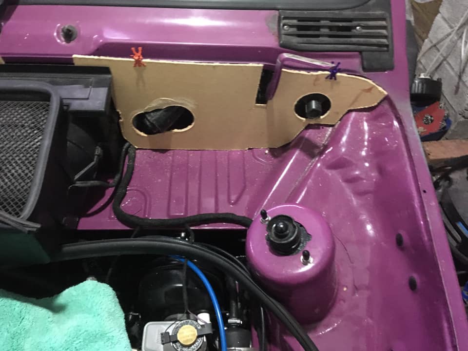

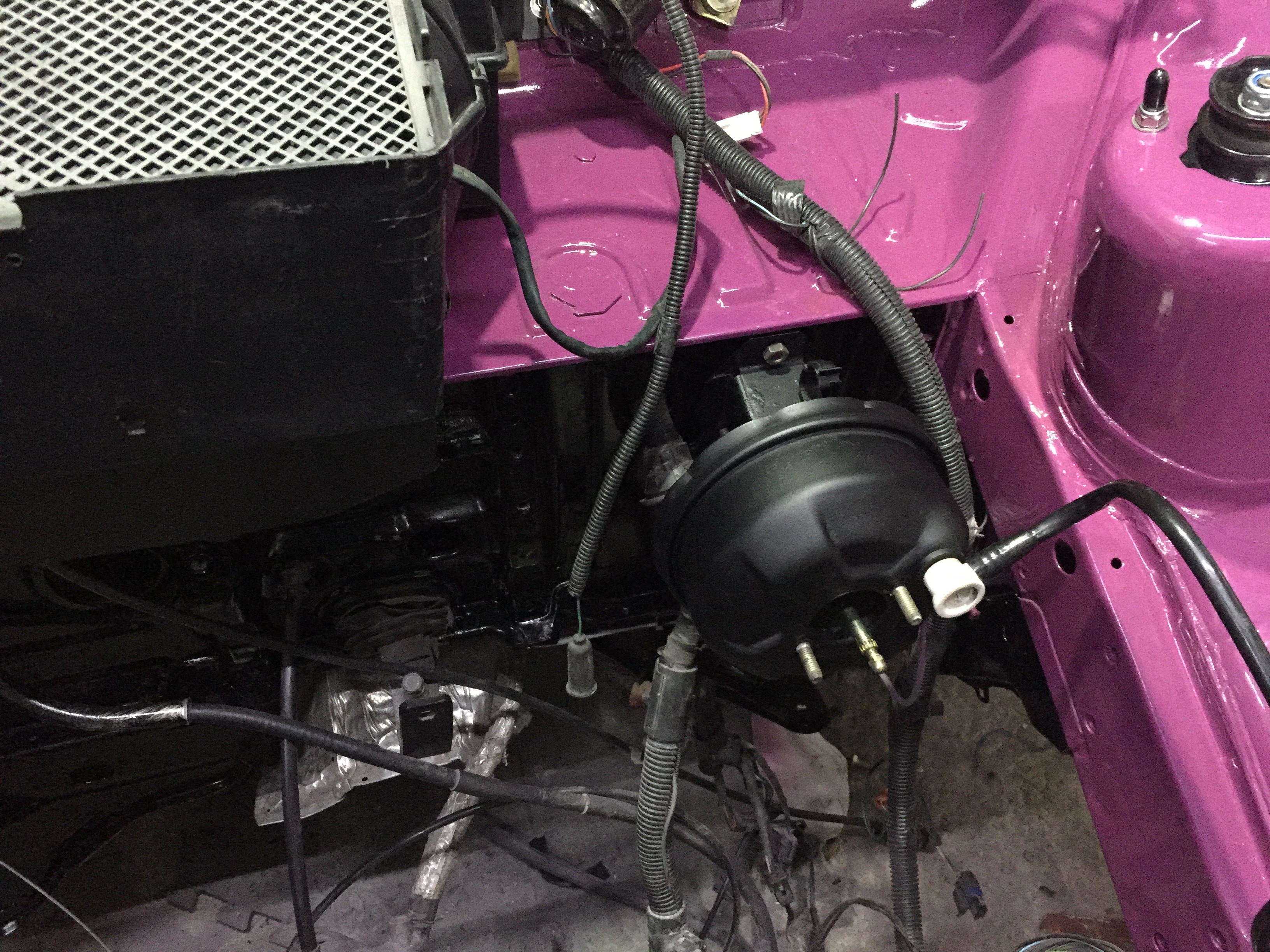

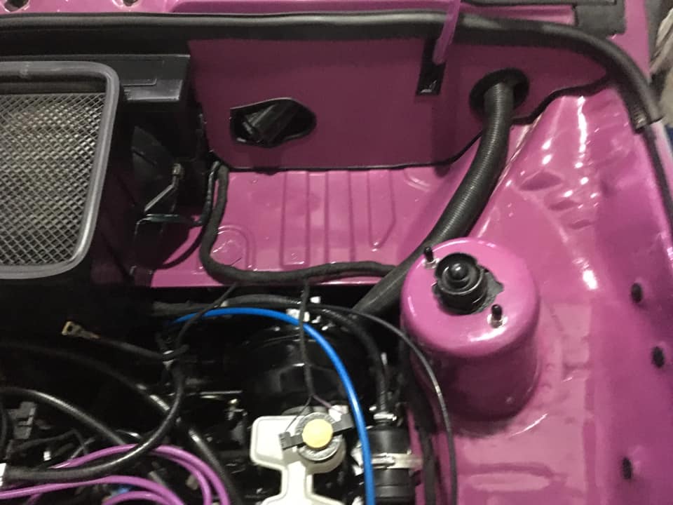

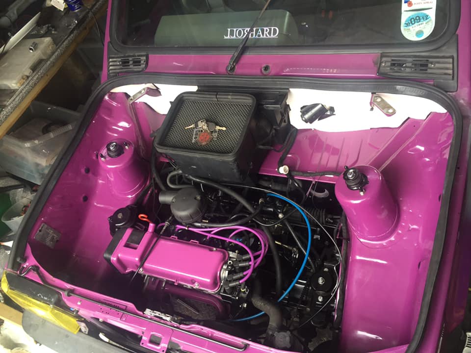

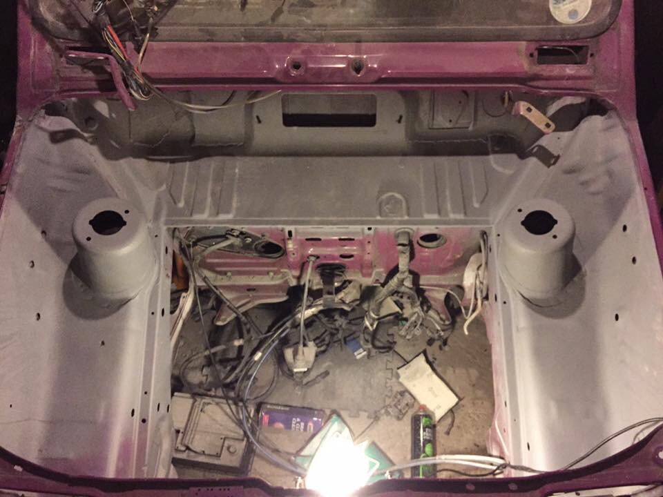

Progress is slow and steady , one of the major things I've managed to sort is the bulkhead covers, I never liked the terrible matting/ sound deadening style one,

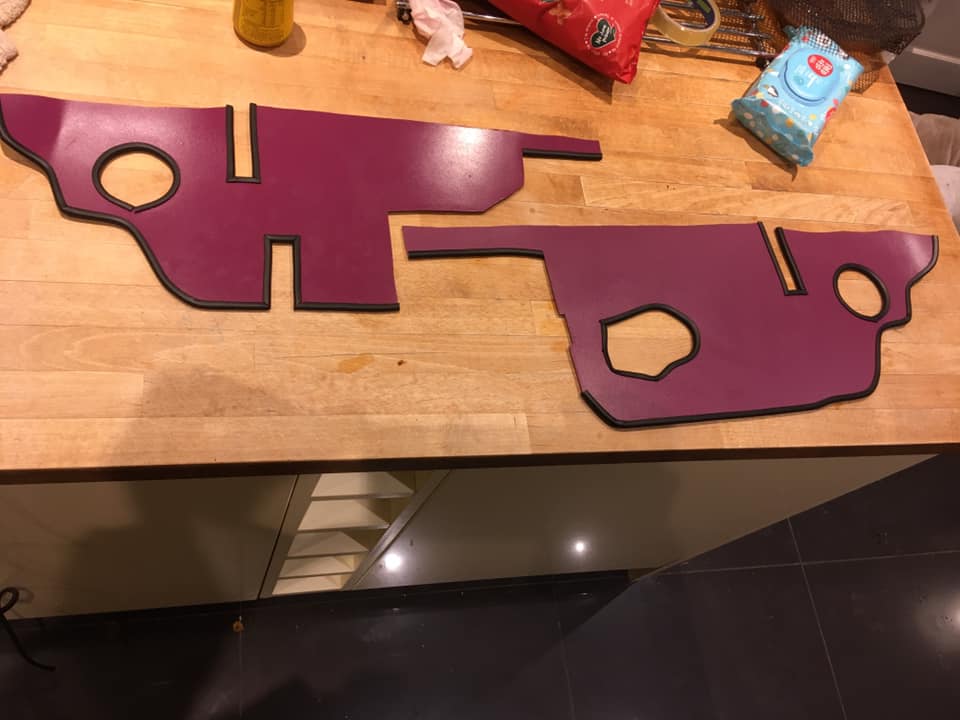

So first I made some Card templates that you can see in my last post,
Then make some Fibreboard ones,

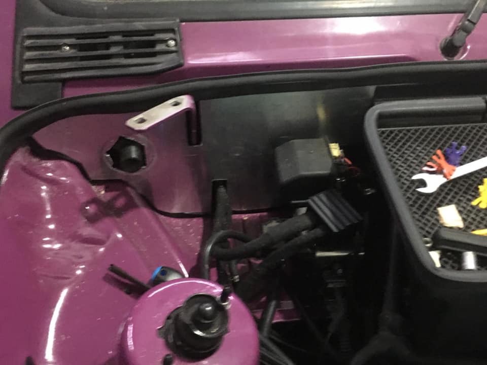

Then I cut them out of some aluminium,gave them a paint and added some edging trim to avoid them scratching the paint,
All fitted
Much neater!

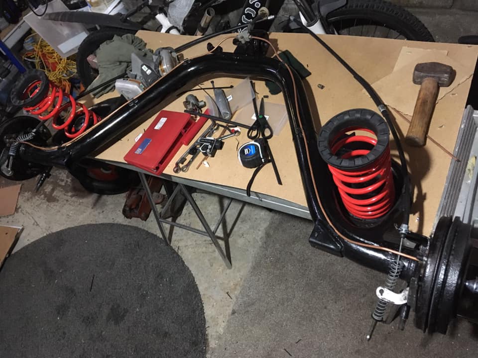

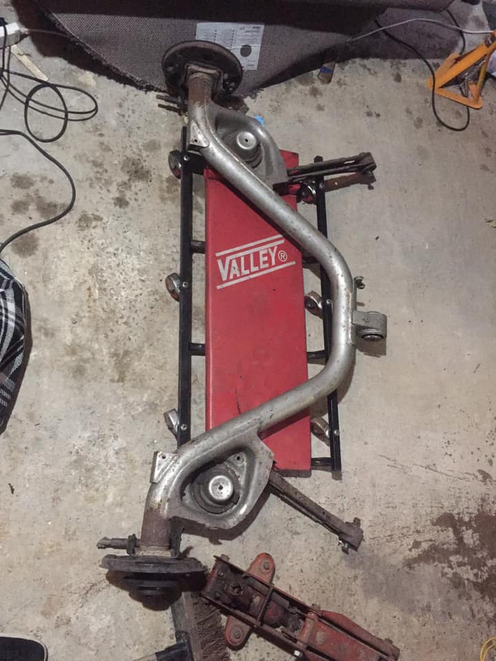

Also sorted the rear beam, I did paint this about 4 years ago but made the mistake of using hammerite and it was pealing off, bearing in mind the cars not been on the road yet!
so it now looks like this

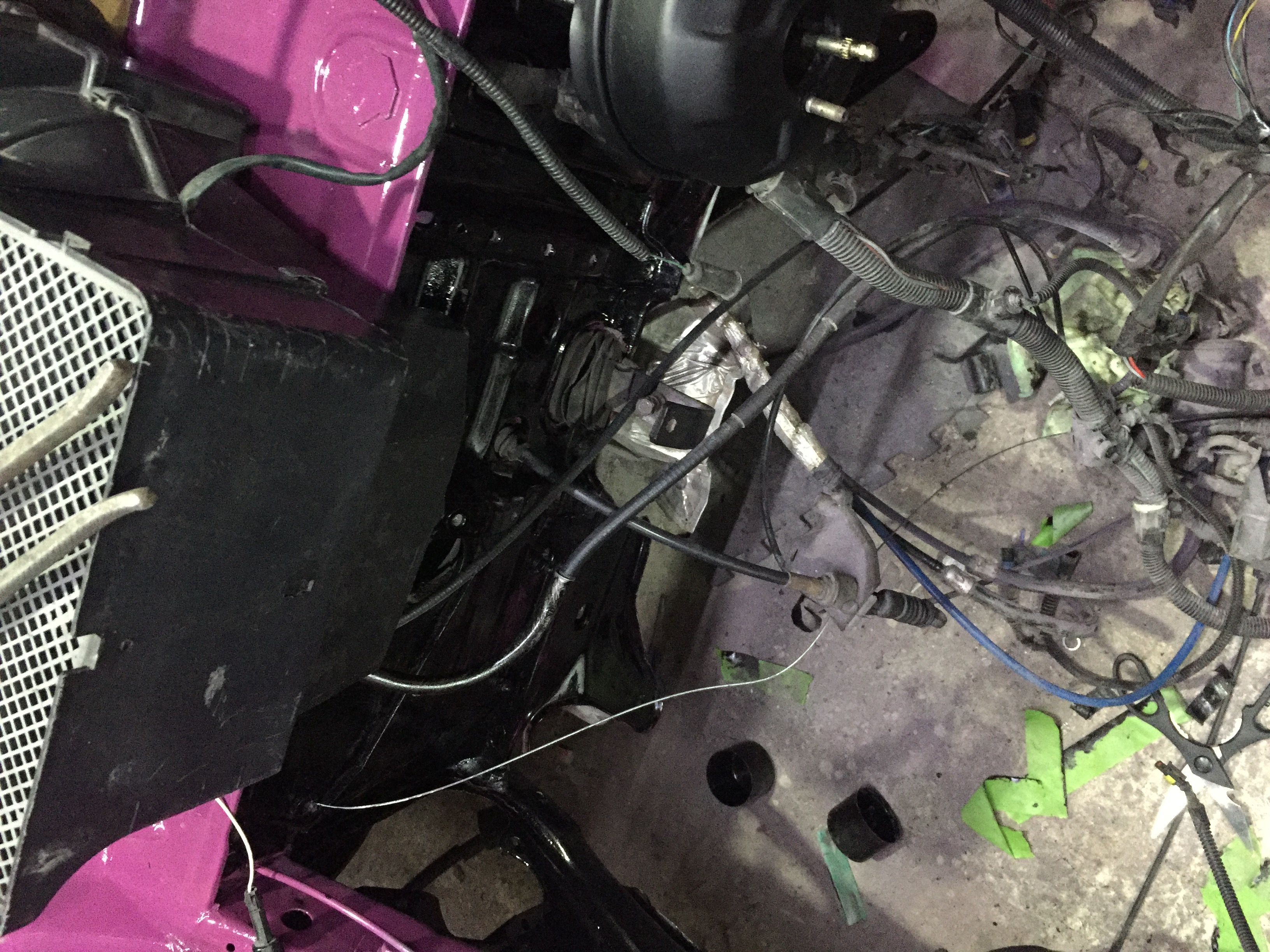

New springs , new shocks , new brake lines , cylinders.... literally everything's new...everything,
Also if you were wondering where the washer jets bottles gone from under the bonnet,
The battery also lives in the boot on the other side,
The cars not far from being done now , once the rears back together its just a case of fitting the driveshafts and brakelines then just a bit of paintwork to sort out before its let out of captivity,
few extra progress pictures of the bulkhead covers

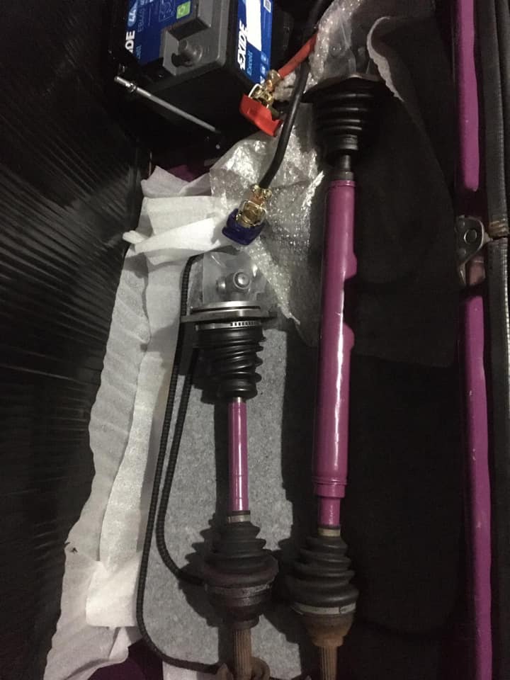

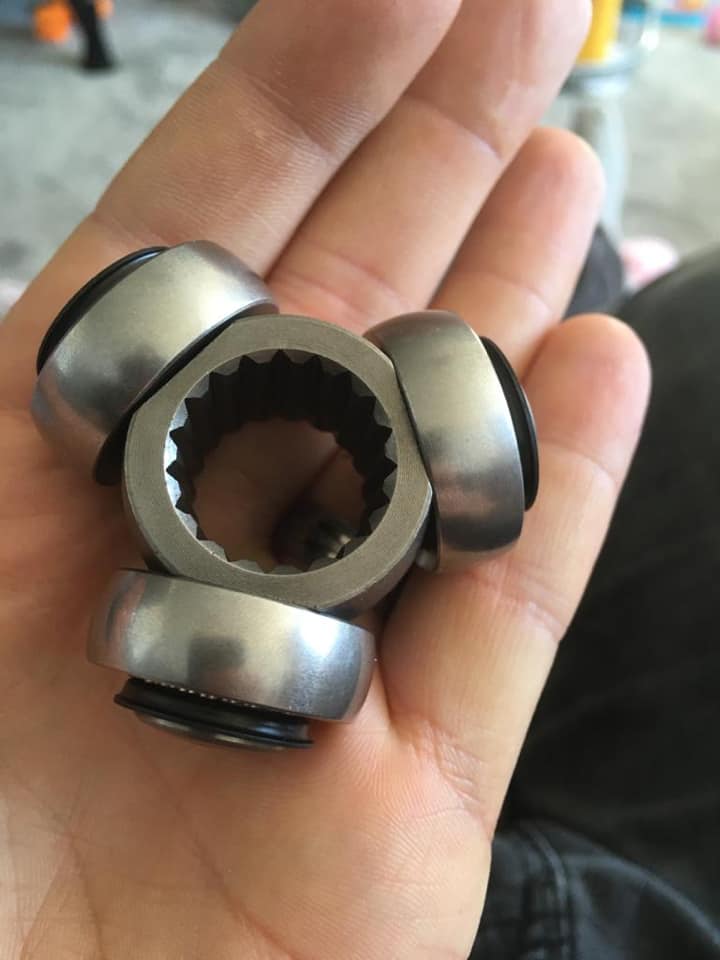

Ive also replaced the tripod joints on the driveshafts as 6 years of them hangning around did'nt do them any good,
While I was there I colour coded the driveshafts, I'm sure the MOT tester will appreciate them lol
