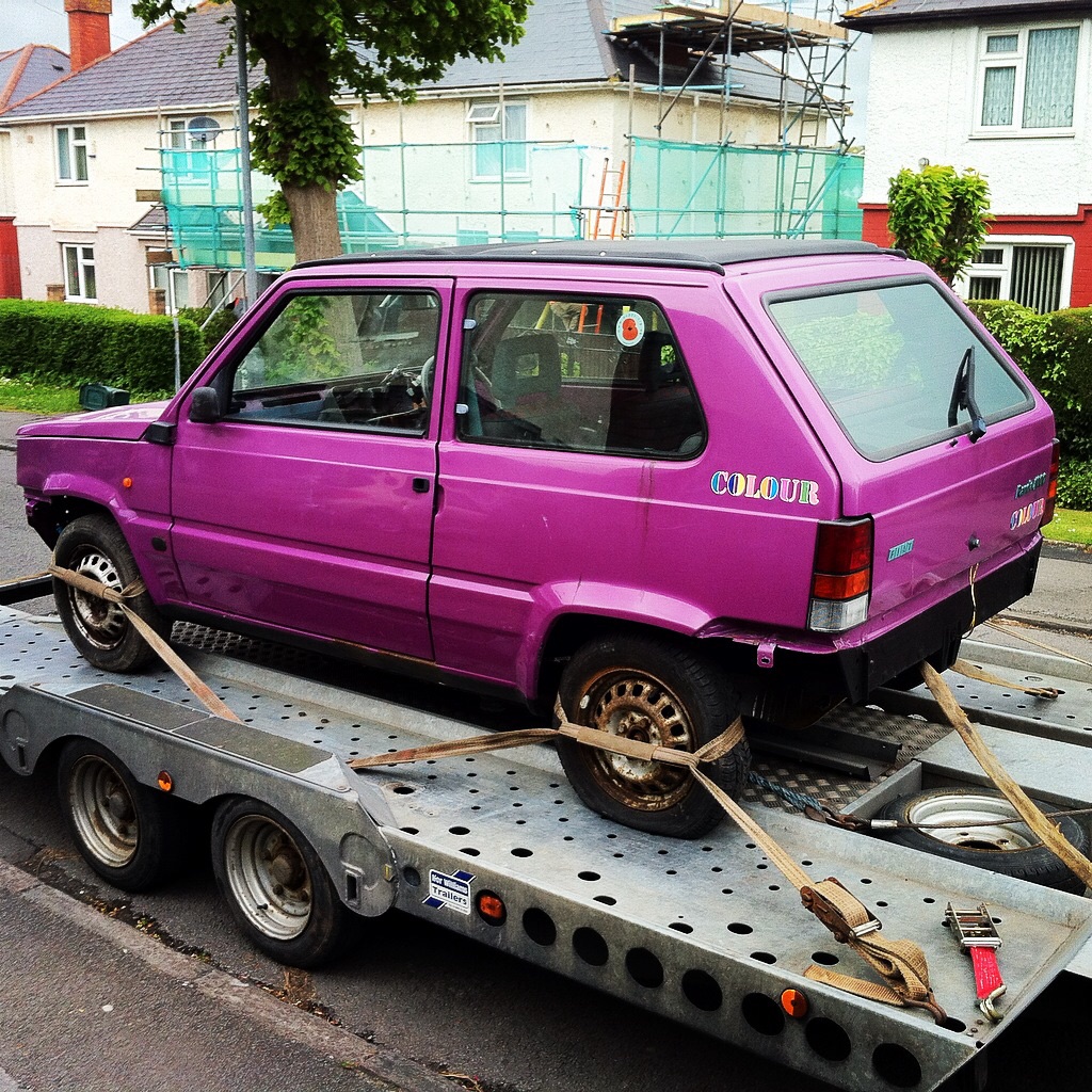

hey, im chris from south wales been lurking on here for a while but now seeing as ive started work on the Panda i though id let you in on it ,The cars a 1994 panda 1000 fire Colour , my grandad bought it from new (my nan chose the colour) , it spend most of its life in a garage although it spent a year in my brother ownership so theres the odd dent , but apart from that , rust is minimal and its got an immaculate interior.
my aim is to do a resto mod as the americans would say, restore the whole car , Standard interior,respray, cleaned bay, lowered suspension and nice,possibly widish wheels, possibility by widening the body,maybe
atm heres how it stood up untill last week , only real issues are that its been off the road for two years ,at the time the front caliper was sticking and the rear beam center bush was knocking its balls off. apart from that its a solid , unwelded , one owner car with 66k on the clock.

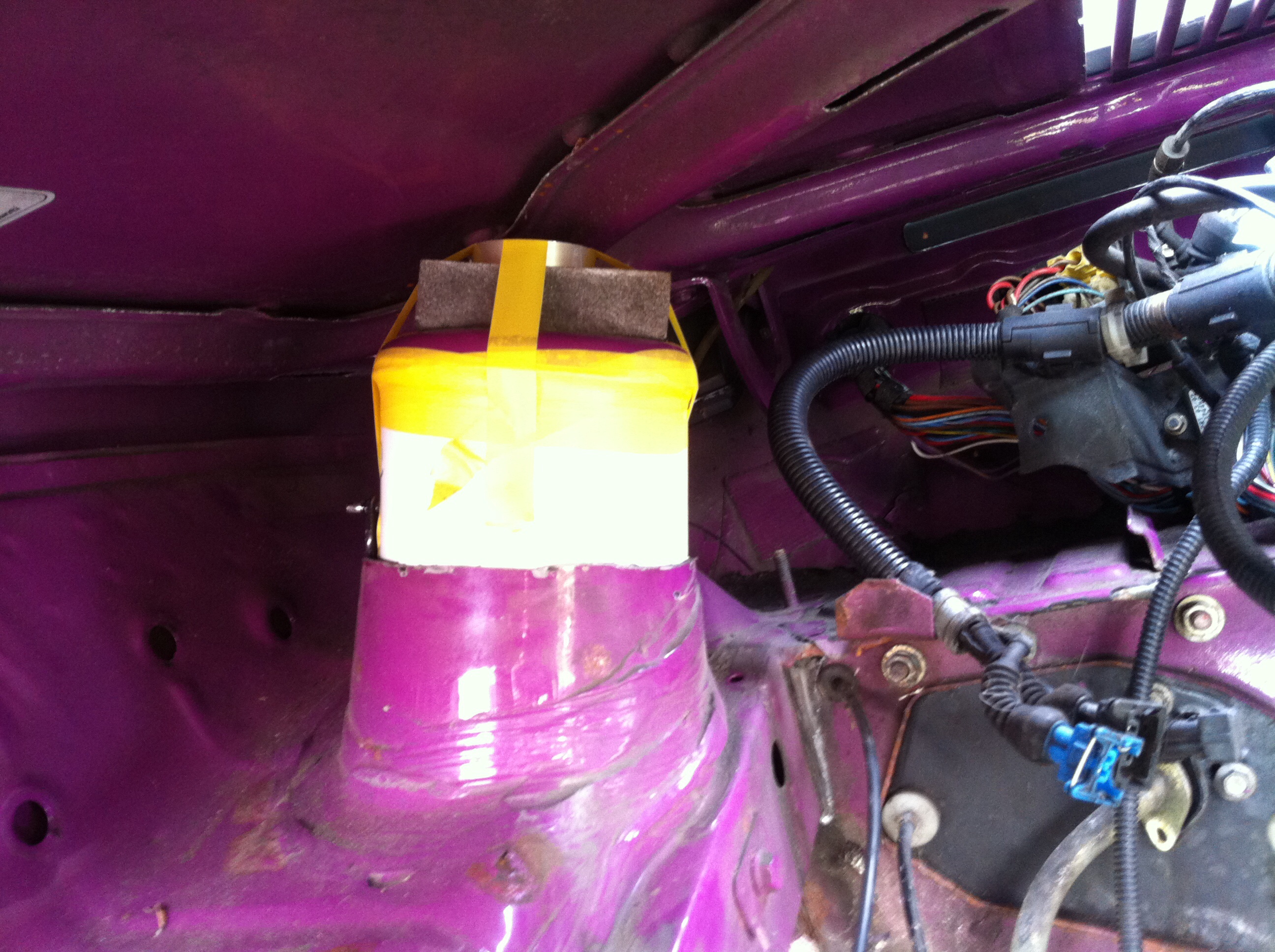

I've also managed to start metal work on raising the turrets
First I made myself a little tool to be able to score a level line
Then I got cutting and mocking up new turrets
The mock up
Good old toilet waste pipe!
Getting two steel cylinders made up to weld in place and I'll also be using some tubing as bracing , it's about time I used my hydraulic pipe bender for something!
Looks like I'll get about an extra 80mm drop by doing this , which is more than I want but it should leave me being able to have the car dropped nice and low to have no arch gap and still have decent ride quality .

I take it the top mounts won't foul on the inside of the bonnet?
Its not really my kind of thing, but I admire the engineering and uniqueness. Make sure they are nice and strong as the forces will be stiffer and stronger through the coilover suspension.
Yeah that's why I mocked up a top mount and closed the bonnet so I know roughly how high I can go .
Yeah my thoughts exactly with regards strength , I'll be adding 2" tubing to the turrets to strengthen them , may even try and do a strut brace but not sure on clearance of the heater box and air intake
Like this , epic paint skills I know lol

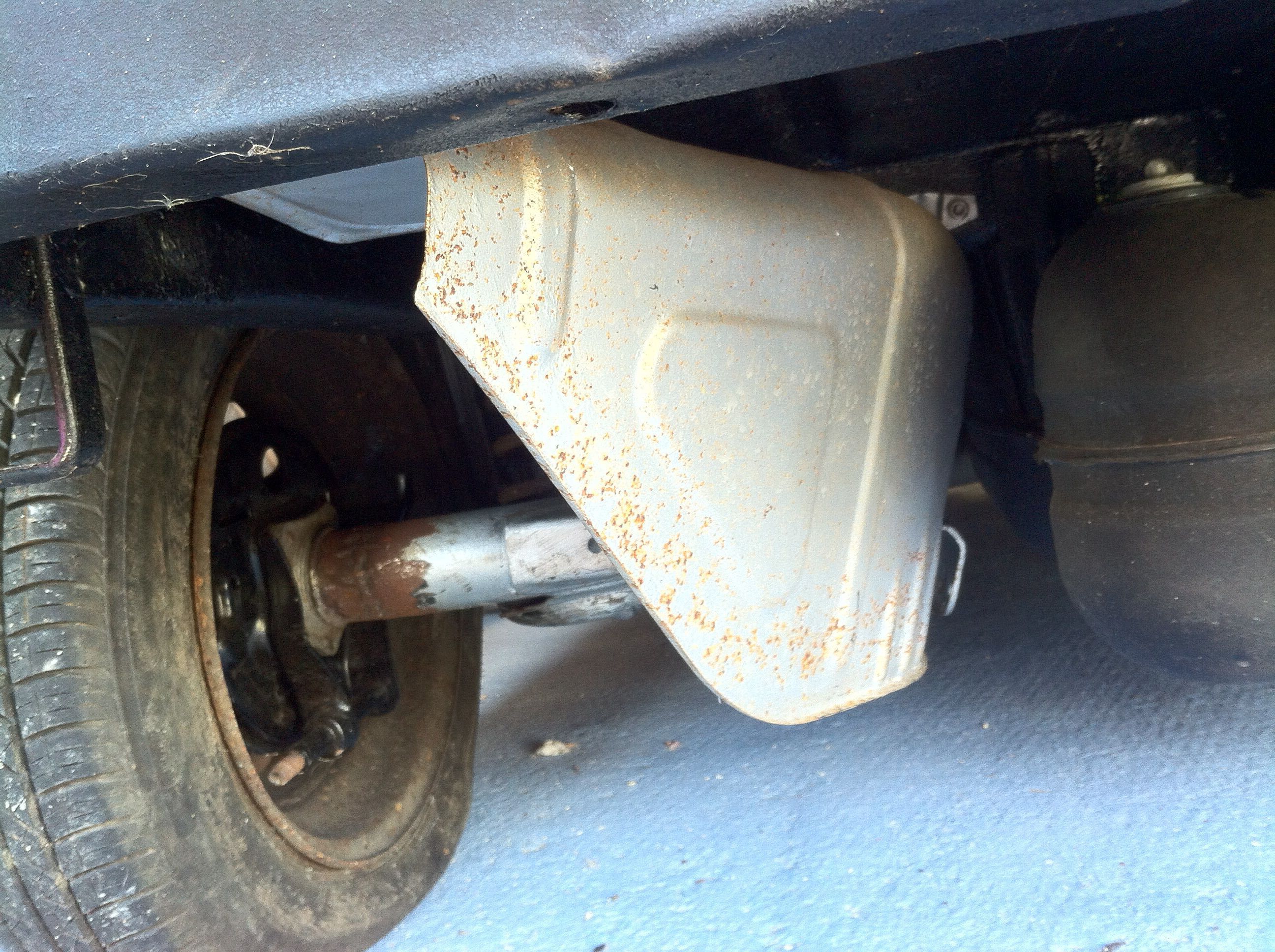

Noticed the heatshield I painted has started rusting , a year outside has taken its toll.
So it's stainless steel time

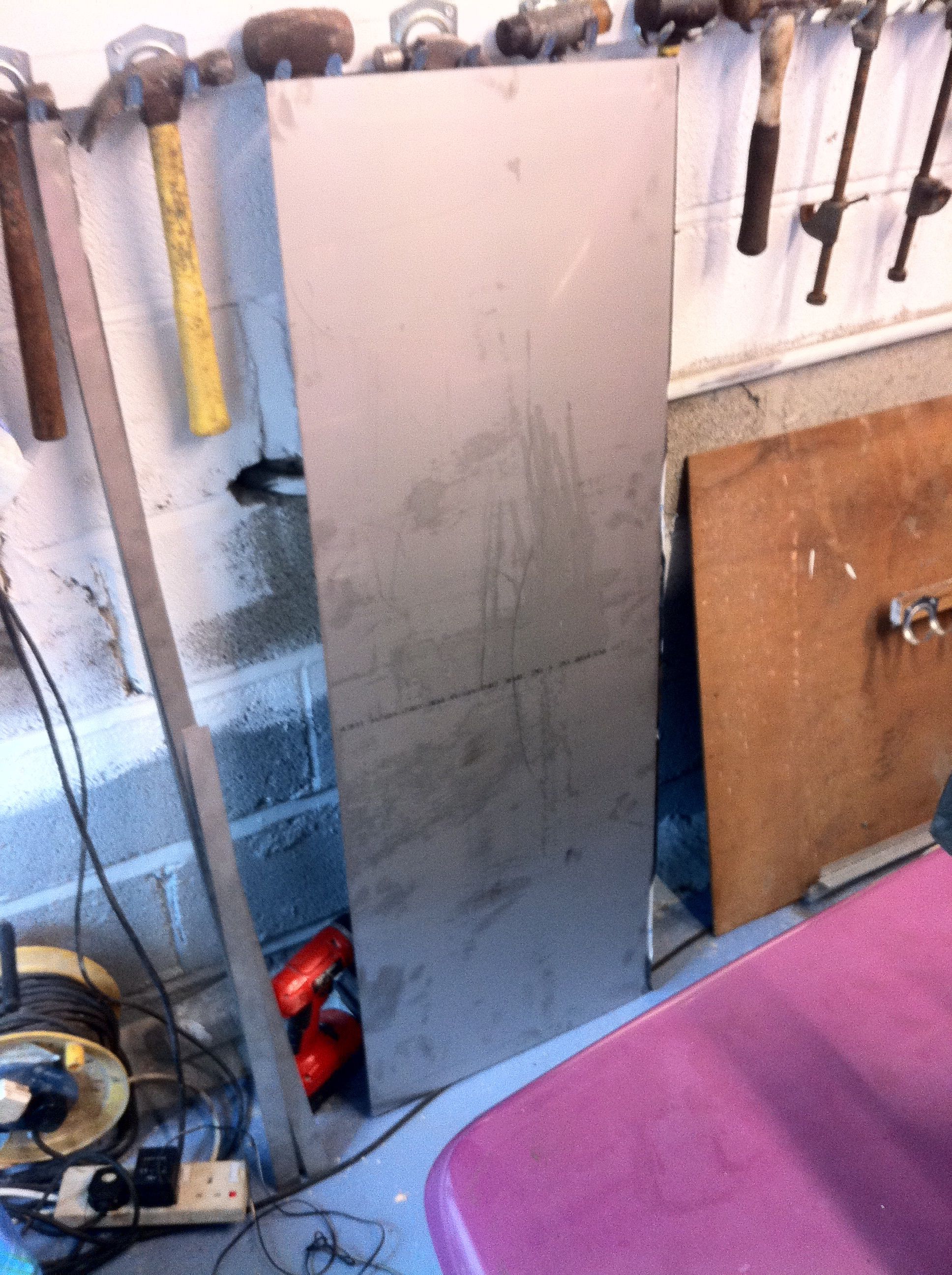

Stopped by the supplier and got myself a sheet to bend into shape to replace the heatshield , shouldn't be much of a job seeing as the original shield is made from one pressed sheet
Wish me luck !

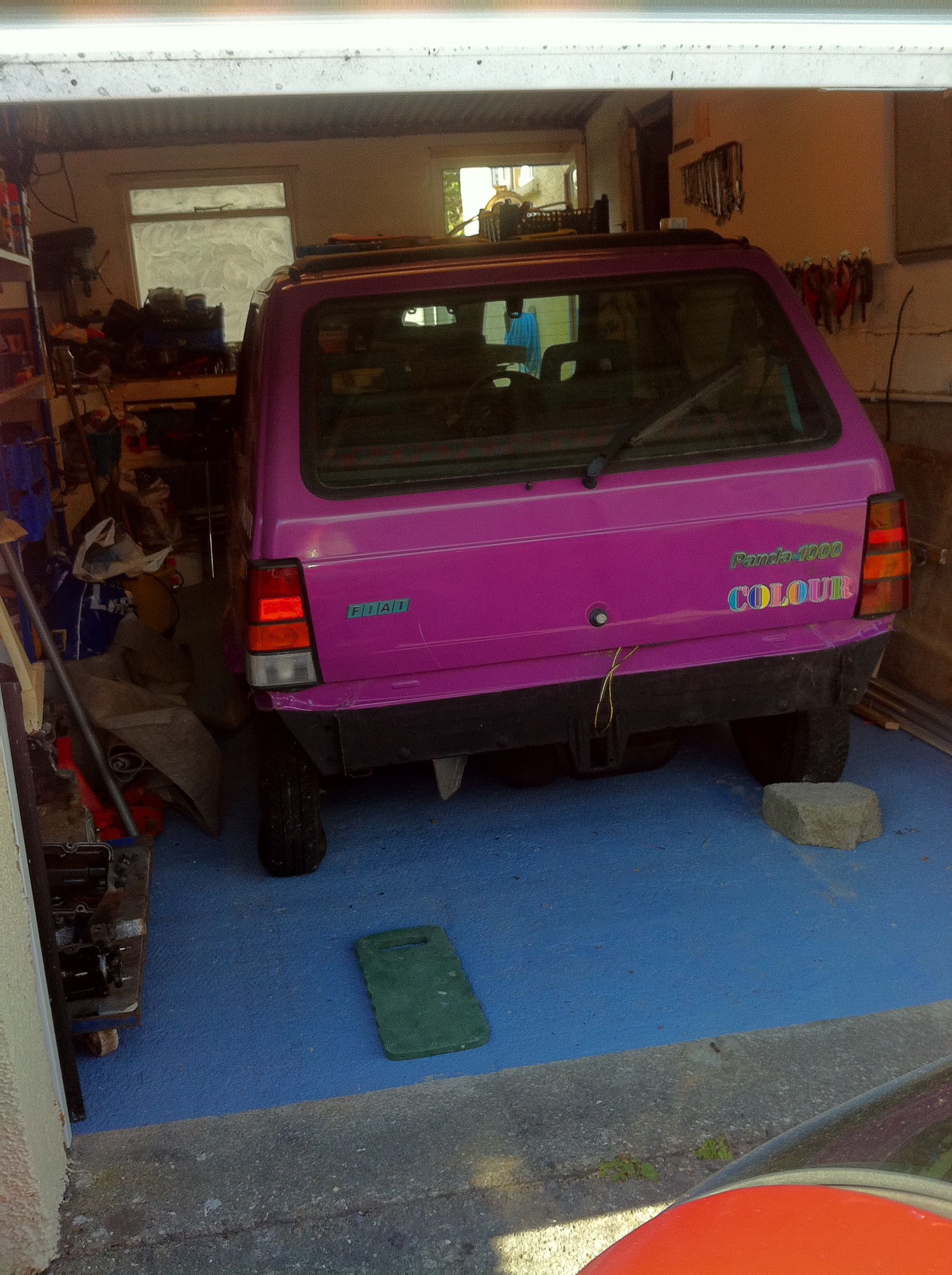

Been a bit slow with progress lately as I seem to spending all panda money on the garage at the moment , put some new flooring down
Also got the panda out in than to give it a clean and go rust hunting under the seals , incredibly the roof is like new , and the doors have very minor surface rust in the typical place

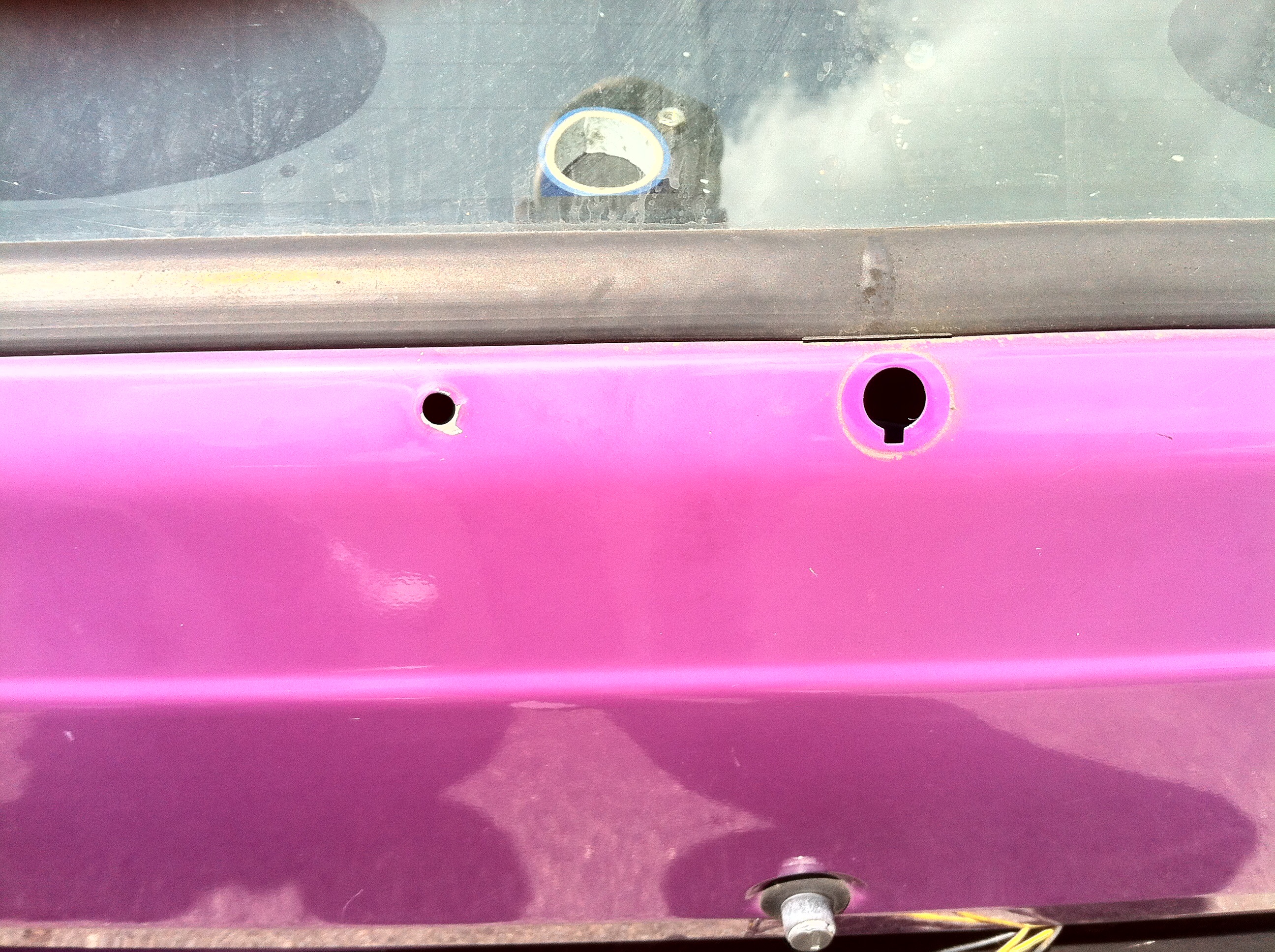

Also took the wiper off ready for the holes to be welded up . Rear wipers are overrated

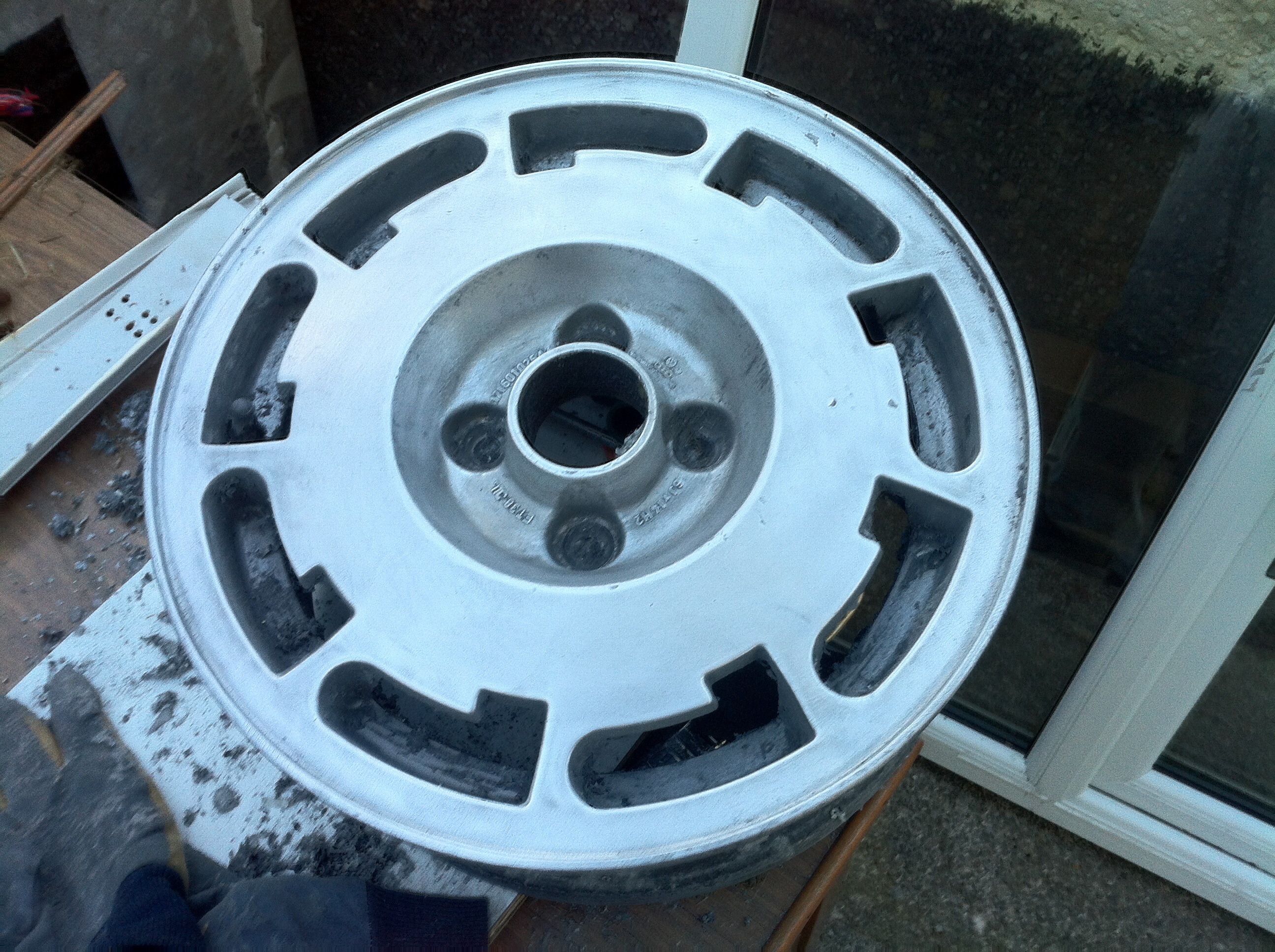

Then I finally got busy stripping the wheels ,
Just gotta polish them now :(:cry:

its either drill the bolt holes on the wheel enough that wobble bolts work.. or.. drill and tap the hubs and brakes 90degrees from the original bolt holes..
That is unless the offset is such that pcd adaptors can be used, they are pretty chunky though - 20mm i think the thinnest i have seen are.

Rather than welding the rear wiper holes you could put blanks in them, as that's what was done on the 750L's which weren't supplied with a rear wiper.
In was thinking of doing exactly that ,but as its getting a respray I'm going to go all out.:cool:

Those are VW wheels right? Have you checked they are ok at 4x100? Just don't want you putting work in before you get to putting them on.
Yeah they bolt straight on with wobble bolts, they fit surprisingly well.:)
4x98 v 4x100 - wobble bolts maybe?
Car and garage look great. "P" for Panda not Pirelli...
Thanks :) I like it , Panda P-Slots haha:slayer:
Yeah luckily I can get away with wobble bolts . Drilling would be a knightmare (n)

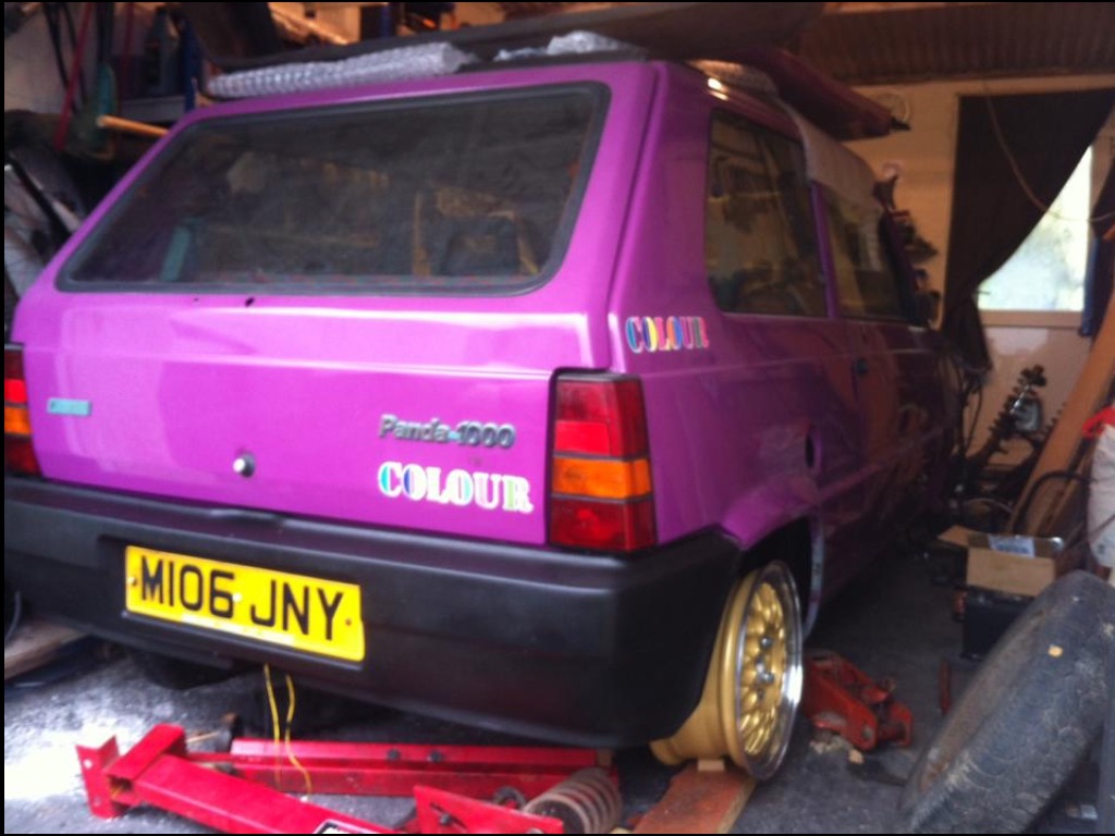

Also got rid of the Pirelli P-slots as the machine shop that were going to machine the centre bore to suit the panda wanted more to do it than I paid for the wheels, so they went on eBay and I picked a set of 14" MIM's that I had shipped from Hungary. Which I think work even better, gone with some 155 tyres on them to have a bit of stretch too so they fit nicely.
