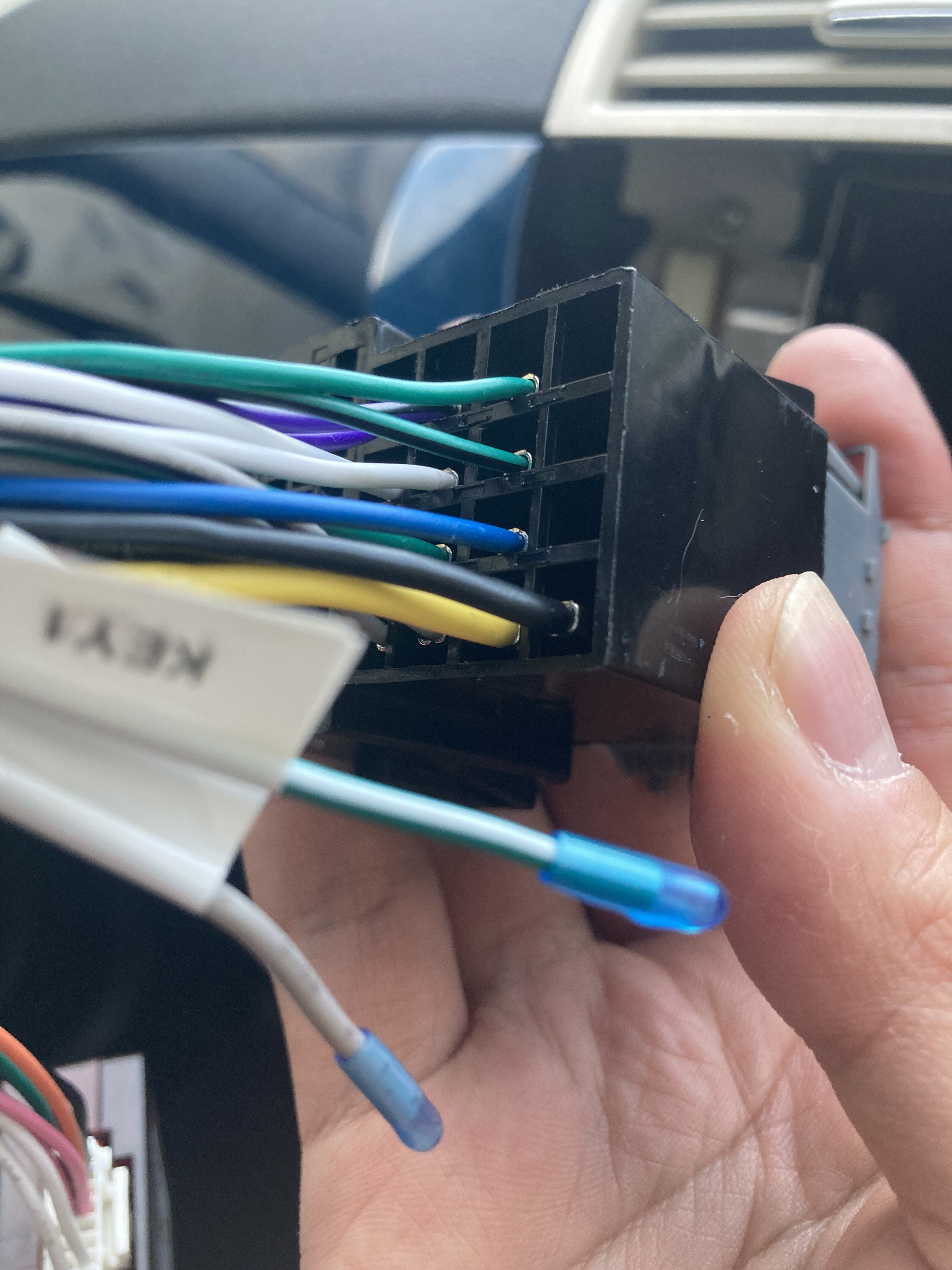

I did run into an issue with the unit NOT turning on at all. EKIY was reasonably responsive in trying to help me out, but at the end I compared the pin-outs of the wiring harness provided to the car's pinout.
Turned out the 12V power supply pin on the wiring harness that they sent me did not match the car's one.
wiring harness from EKIY (Yellow is power)
Car's wiring harness (Red/Green is power)
I found out that speaker positions of the EKIY wiring harness also do not match up correctly with car's wiring harness as well (wrong order), so I re-wired them all on the EKIY harness' side to match with the car's and sealed them up/wrap with electrical tape before I was done.
EKIY was willing to send me the 'correct' wiring harness, but I was not willing to wait it out, so I tested out an option ; splicing 12V power cable from car and connecting it to EKIY's 12V power supply wire.
