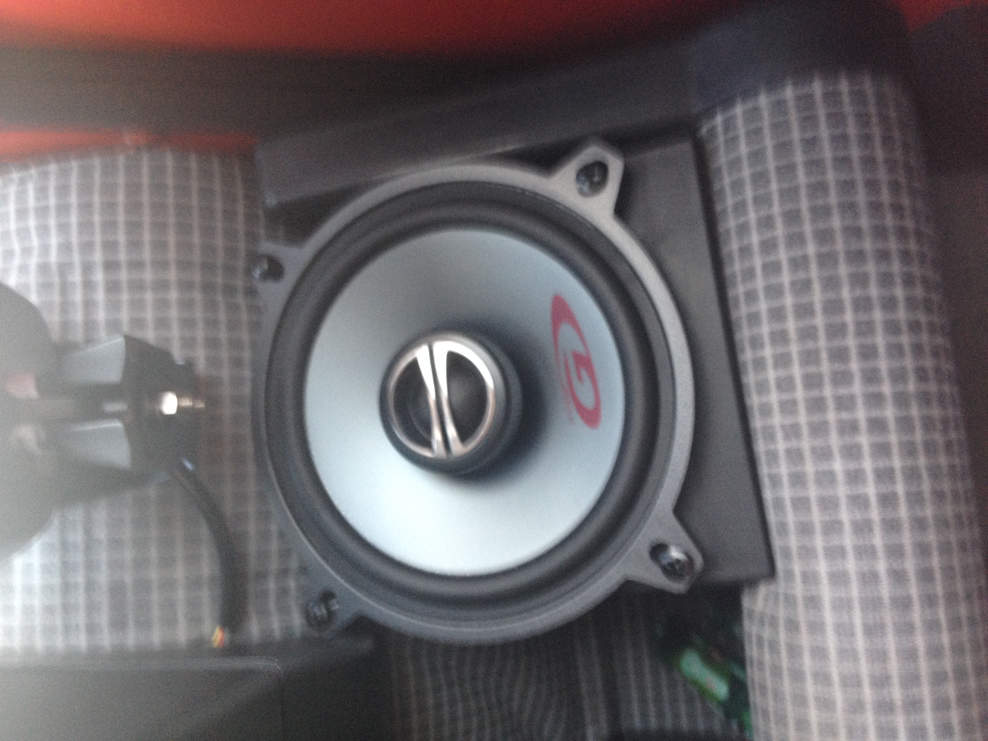

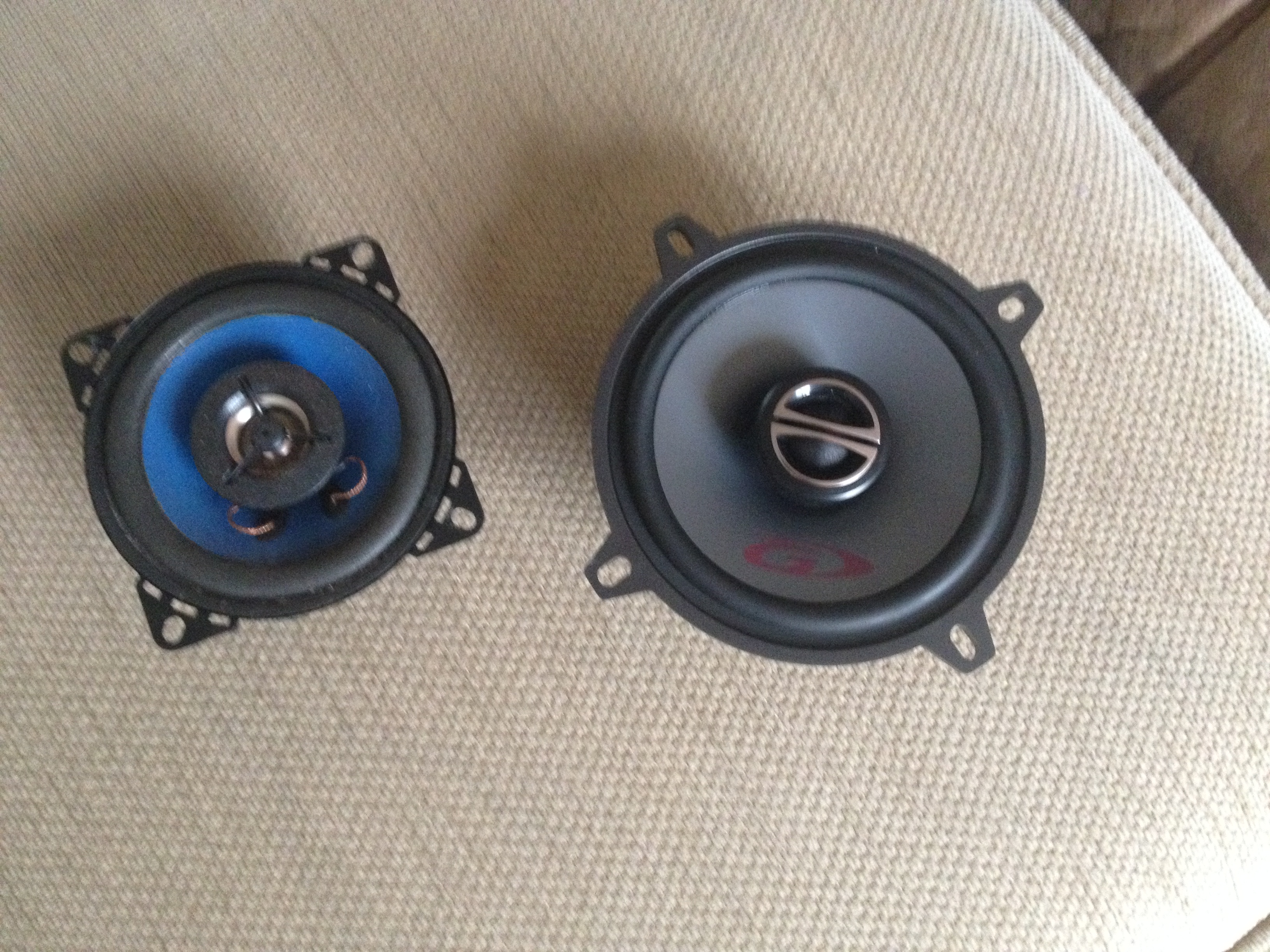

So the RM speakers that came with the car are somewhat puny and lack bass at any reasonable volume so I bought some new ones. I measured the pods to work out the biggest possible driver I could fit in, the actual hole is 10cm but with a little cutting you can get a 11cm woofer in, therefore the biggest size is a 13cm or 5.25" set of speakers.
Speakers arrived today, heres a comparison of the puny original speakers and the new,
After cutting up the speaker pods and drilling some new holes they fit well,
The only visible evidence of the hacking,
They sound good and are much louder (y)
You won't get better bass or sound quality from putting bigger speakers in those tiny pods! You need volume of space behind the speaker to get good or at least better bass. Your best bet would be to fit the speakers in your door pockets if you have them and then sealing the tops up (y)
Would be a shame to ruin some door pockets but that's your best bet up front.
Another way would be to replace your rare parcel shelf with an MDF one and fit some 6x9"s into it, paint it black and then cover the whole shelf in speaker material so the speakers can't be seen from outside. You won't believe the sound you'll get out of them!!
But I have gotten better bass? They sound tonnes better than the originals, I don't see why the size of the pods affects the sound of the speakers, they're just a bit of plastic the speaker screws to, if they were proper boxes like what you install amps into then I'd understand but they don't seal against anything. I could get better sound out of my speakers by putting them into better boxes but the upgrade from 9cm driver to 13cm has improved volume and bass notably.
When I was a young lad...much like yourself....I built speakers for my little bedsit. They were over a metre high. Doing this I learnt a lot about bass. I packed the boxes...that was to deadening..so I just lined it instead. Ended up building a vent in the bottom which worked well. Trial and error.
I believe yours sound better. After all they are better speakers so they will do. It looks good and you have done a top job.
As long as your happy that's all that matters.... Jamie is right though, the better the box the better the sound...even without amps etc....:D
I understood the better box thingy having bought and assembled a sub, box and amp system before but I'm not going for sound quality of that level. I did think about lining the speaker pods if only to reduce vibration (the entire dash vibrates with high volume)
