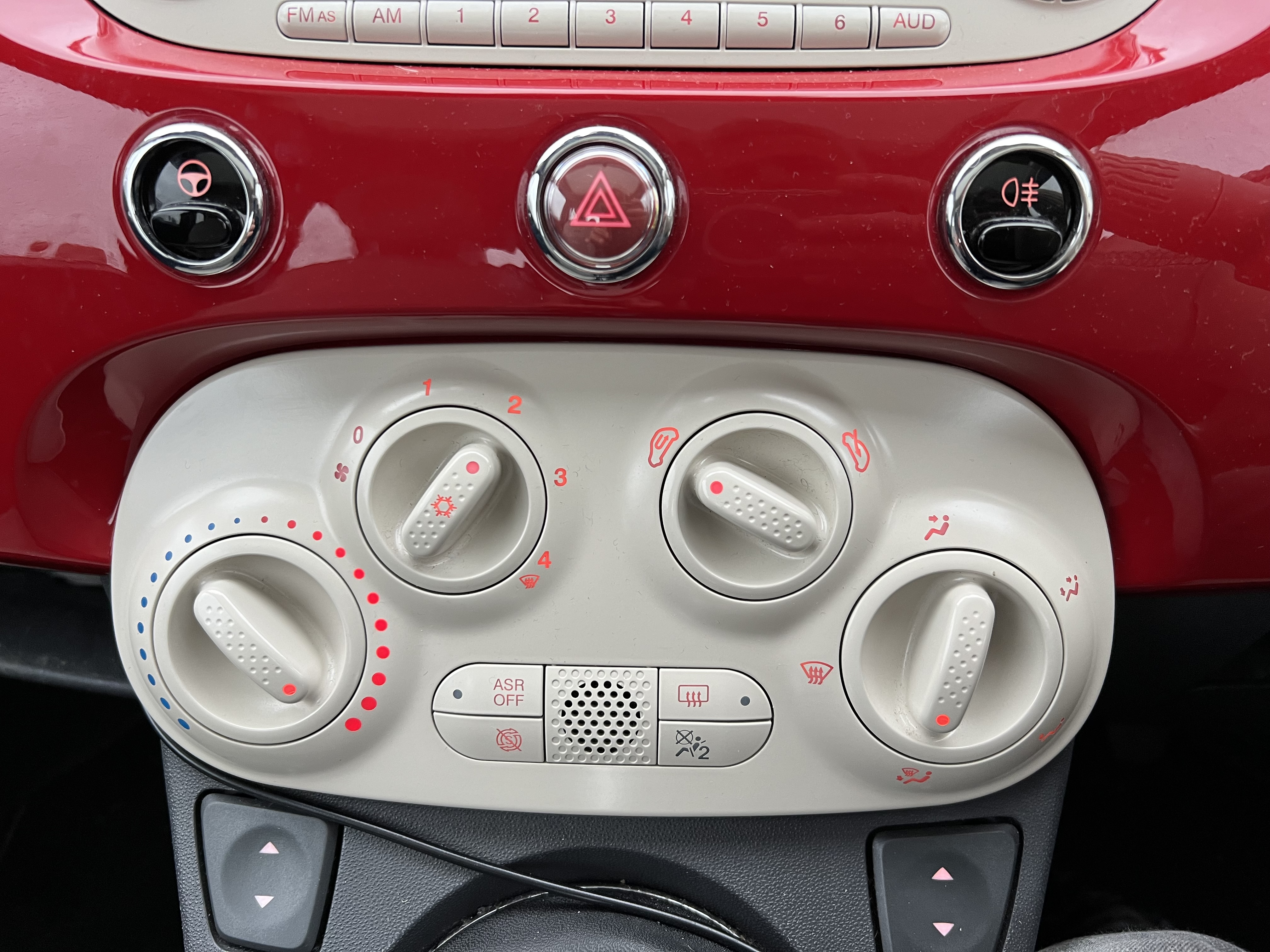

Hey everyone,
Question. Are the centre console, heather controls meant to light up when the lights are on? One would think that is the case but our ones do not.
Could someone confirm please.
Fiat 500 1.2 Lounge 2014
Here is a picture.
yes they should come on when you have the lights activated. In the Panda and KA there are 2 small lightbulbs behind the covers. Look for a youtube video how to remove the plastics to get to them.

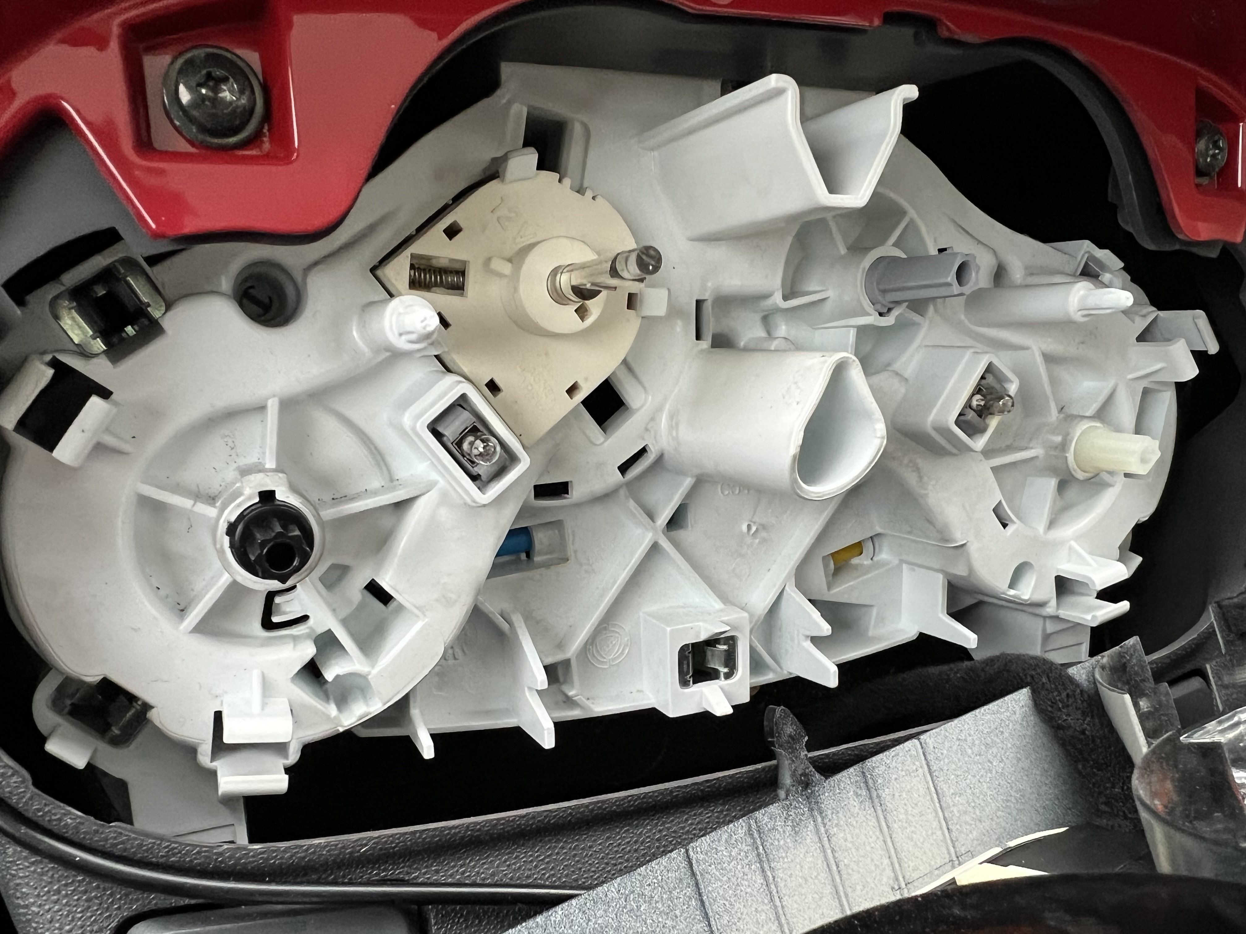

Done!
Nice little job, quick to do. It was more difficult to source the bulbs than the rest.
Tips:
- Turn all dials to 0 or one end as and reassemble carefully in the same position to match their function.
- Caution pulling the trim out, can hurt your fingers, use plastic tools.
- And careful with the metal spring retainers dropping behind the dash.

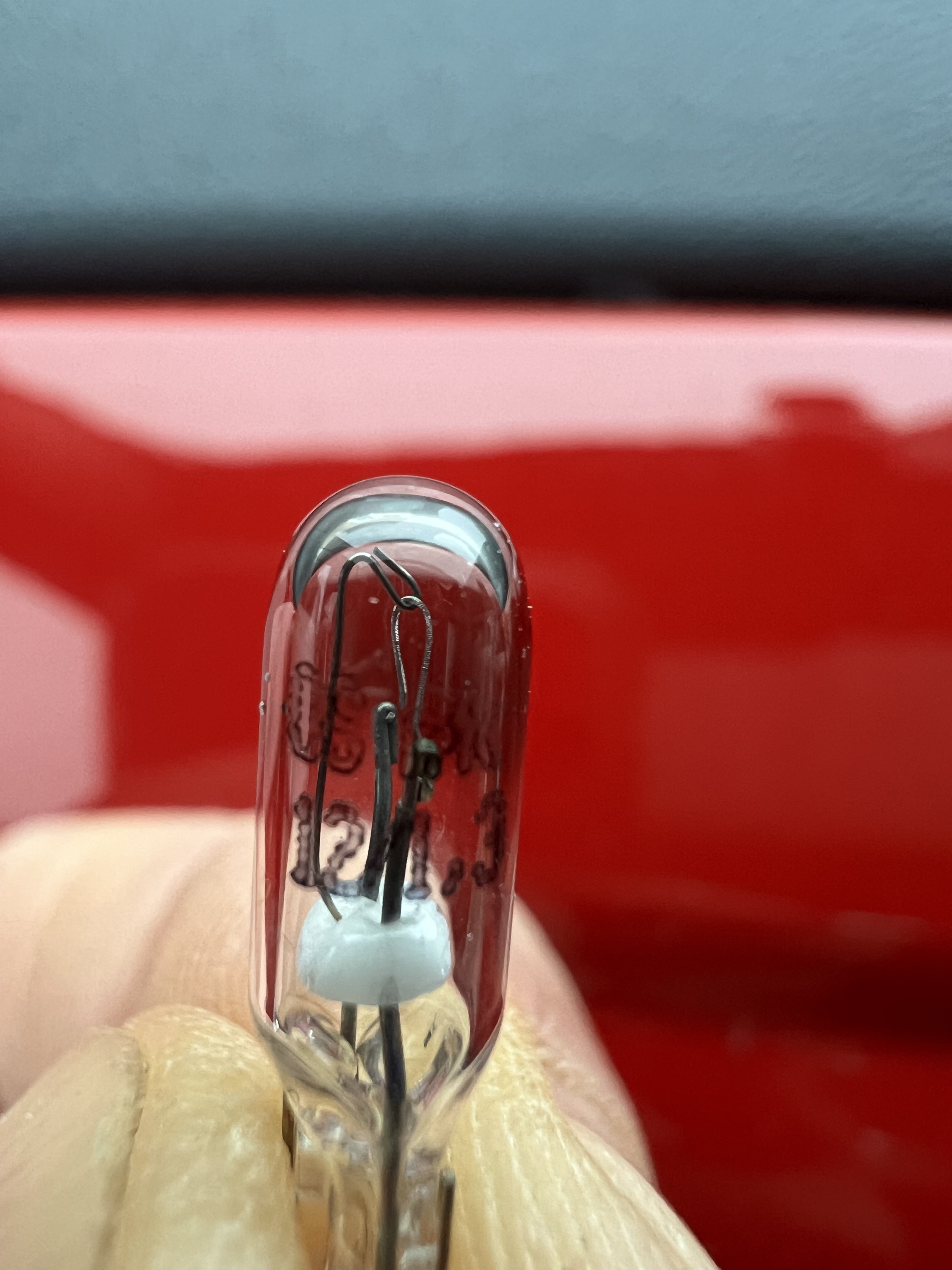

YouTube:
Bulb type: T5
Eurocarparts only had the single Lucas bulbs in stock.
Lucas 284 Bulb 12V 2.3W - Single Pack
The double pack was not available locally
Osram 2722-02B 12V 2W T5 - Twin Bulb
