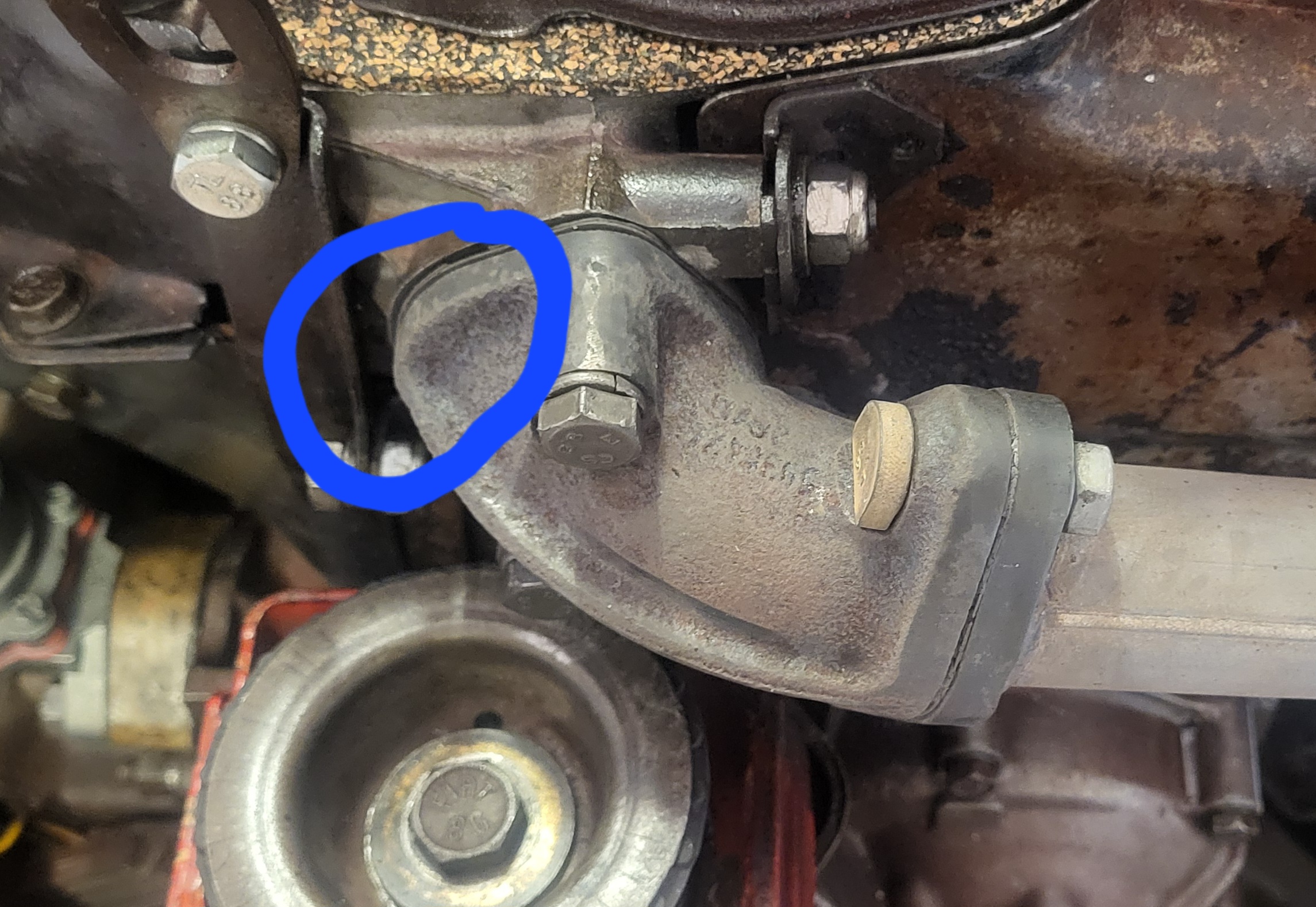

In reseating the rockers, I noticed that one of the push rod tube rubbers was pinched. Head off for the 3rd time, new gaskets and reassembly and the engine runs. The exhaust blows a bit from the elbow shown in the picture. The bolts are tight so I suspect the exhaust header is not straight, causing a bit of gapping. What's the best way of sealing it? The gaskets don't have much thickness to compress.

If that's as far as they go when tight I assume that the cause is most likely that there is something such as a piece of broken stud thread in the bottom of the threaded hole, or some other thread damage that doesn't allow it to be fully inserted, or maybe there is insufficient depth of thread on the bolt itself or the bolt is too long.
It would be best to investigate by removing it (or the pair of them) completely. If it will still leave plenty of threaded bolt inserted, you could grind off a bit from the end. Alternatively, how about a couple of flat washers under the spring washer, in order to raise it a bit?
Worst case scenario....use an additional gasket?
You're on a hiding to nothing if you use something such as exhaust putty, unless you are able to get the elbow and exhaust flange to properly seat against each other; in which case, you shouldn't need any sealant. :)

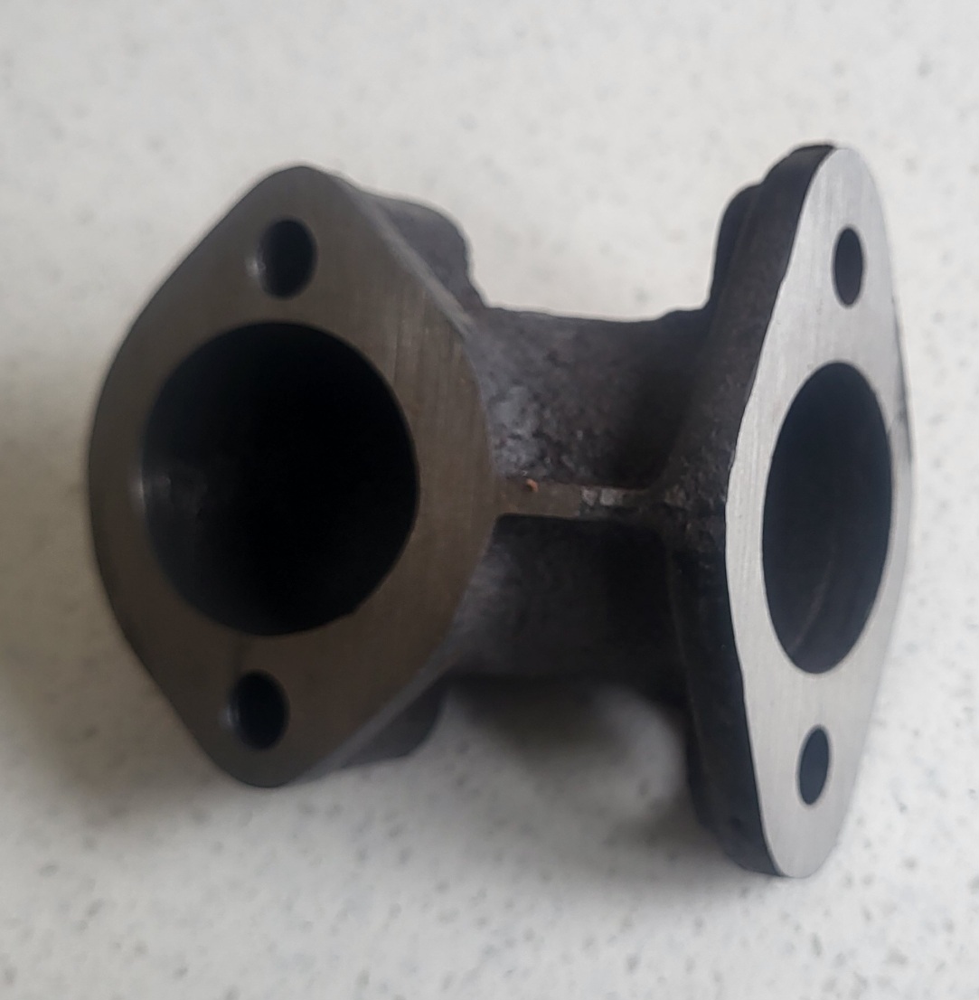

This morning I took off the elbow an offered it up to the head without a gasket. It rocked side to side on the head, and on a flat surface. That's easy enough to fix on a linesher. Motobambino posted me a new set of gaskets over night so all was set up for a simple fix.
The newly flattened elbow still rocked against the head. With bolts done up finger tight, a 0.23mm feeler gauge will fit in on the fan side and a 1.13mm gauge on the thermostat side. I'm now taking a sanding block to the face of the port. The new gaskets are 1.4mm thick and the old ones 1.0, so they should take up the difference, but I'll clean up the face anyway.

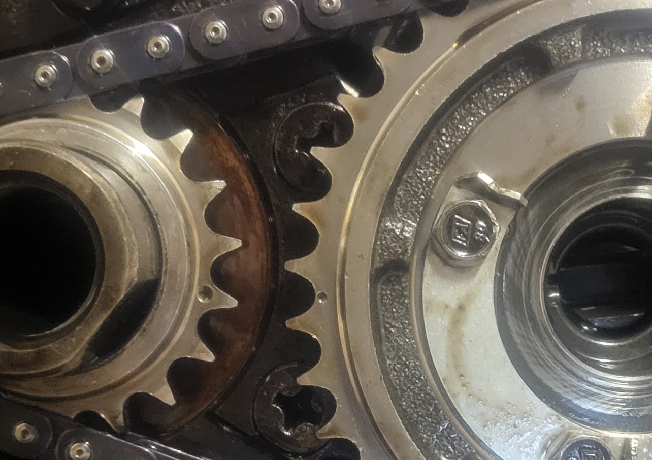

In a moment of self doubt, I've checked the camshaft alignment today. With the rocker cover off, you can rotate the push rods freely with your fingers until the cam pushes them against the rocker arm. The inlet pushrod stops rotating 60° BTDC and loosens off 79° ABDC. Assuming 14.5° of ramp, it suggested the cam was set to 45/65 rather than 35/70. With 38 teeth on the cog, I guessed that it was 1 tooth out.
So I took the cover off and rotated the crank until the dot was in the right place. There was a heart-stopping moment when the other dot didn't come in to view. A deep breath later and I worked out that the dots would only align once every other rev. One turn of the crank later and the dots were in the right place. While I was at it, I bent back the retaining plates and checked the bolt torques. I worry too much.
Don't forget that the 35/75 spec will be at a certain amount of cam 'lift', not the start of the ramp off the base circle.
Also measuring by checking push rods you have to take the valve clearances into account, the push rod will go 'tight' at a cam lift equal to the valve clearance. You need to take that into account and set the clearances to the lift the cam spec is measured at if you want to get close to accurate using this technique. Wit the standard 0.20 / 0.25mm clearances for the 650cc engine, that 0.05mm difference between intake and exhaust clearance will definitely make your measurements look wonky.
As long as the dots align, for a fairly stock engine I wouldn't worry too much more. 🙂
