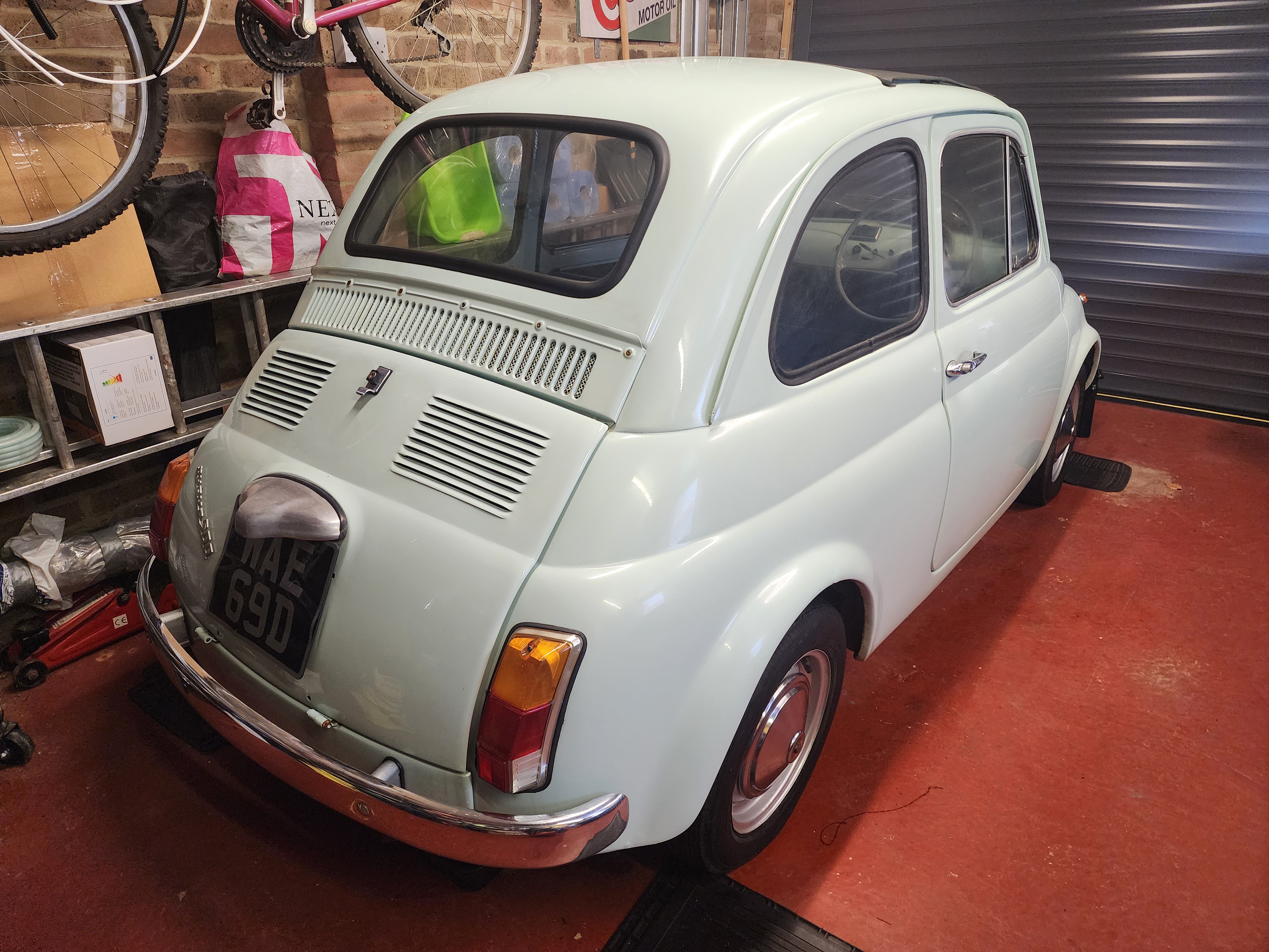

Hi Barry here and a newbie to the forum
The next project begins following many years in the replica arena building a Shelby Cobra. Always liked the Classic Fiat 500F look and the Mrs always had a hankering for a small car for her to take to car shows so garage time ahead.
It drives and appears to have had some restoration work done prior to the previous owner, would be happy to hear from anyone who recognizes the car that can add information of it previous life, its rhd but the speedo is in km/h. I know little to nothing about air cooled engines so no doubt will be bending peoples ears :) . Happy to be aboard
Bye for now
