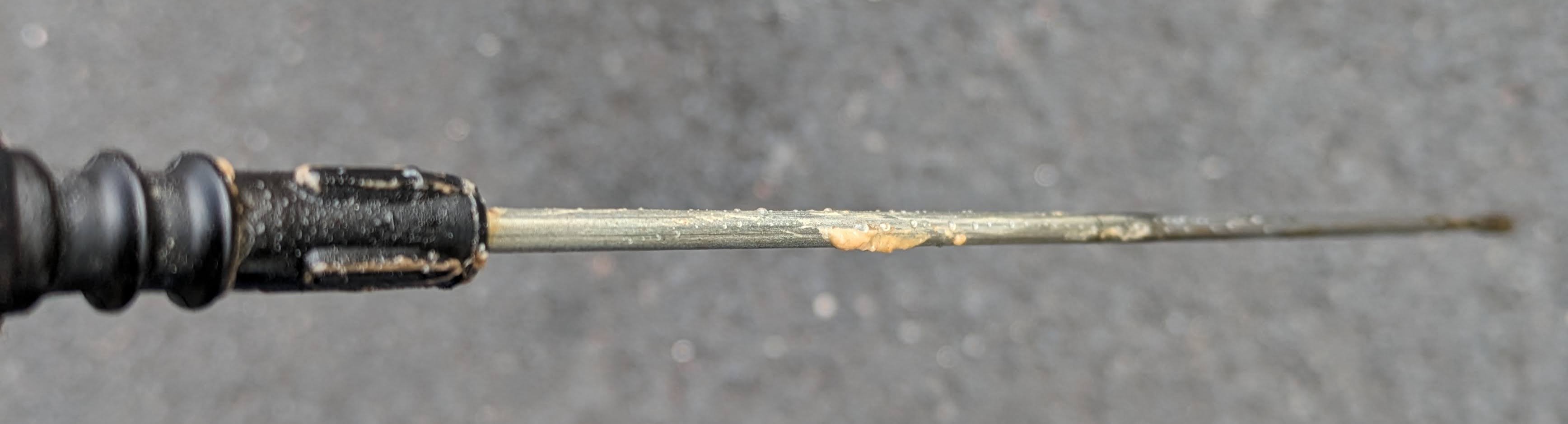

I've just checked the oil on my 2015 Fiat Panda Pop and the dipstick has some light brown grease on it, and some little 'water' droplets. It hasn't rained in a couple of days.
The battery also has some blueish powder on the red terminal.
I last checked the oil in September, and it was really, really low (nothing on the dipstick, that was the first time I've ever had to top it up). In October it was MOT'd and I told them I'd had to top up the oil and asked for oil change / new filter. I've never seen anything like this on the dipstick or battery before.
Should I be worrying about this, or is it just some kind of preventative stuff used by the garage?

The blueish powder on the battery terminal is corrosion, that looks to be the original battery as well, it's done very well to last 9 years if it is, as for the dipstick it could be either the car does a lot of short distance journeys where it doesn't get time to fully warm up or worst case scenario it could be head gasket failure as it looks like mixture of oil & water, typically known as mayo

The sealed crank case system on the Panda tends to generate mayo. I have a catch can fitted in the crank case breather system. It stops this building up in normal use and the water is collected in a little pot I empty weekly. The oil remoans dry. As long as its just condensation on the crankas collecting in the oil this will fix it.

In passing, another example of why only very short journeys and overall low annual mileage is bad news for cars in general. Engines need to get fully warm to evaporate away the natural moisture (basically condensation) that ends up inside them. What you are seeing is where that water mixes with oil vapours and forms an emulsion of slime. A 'decent' run at least once a week will prevent that. Very low use also means the exhaust will rot from the inside as it too will collect condensation. Brakes also need to be 'exercised' to keep not only the pads and discs, but all the moving parts too, in good health.
As to battery charging, as mentioned above, it's not the speed of the car but how long a run it gets in terms of running time that gets the battery recharged. A 20-30 minute drive on a variety roads (slow, fast, hilly etc) at least once a week is good for minimising all these issues.
