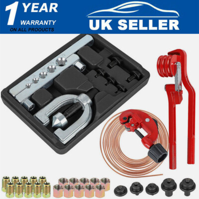

Do you think this would work, I only need to make 4 flares and comes with, I think the correct 10mm fittings
No!!! I tried one of those once and they are crap, Sorry:)
I was just going to say that. It looks like the one I had. Looking at the professional one there is an extreme difference. Maybe a skilled fitter could make it work but I never made a single successful pipe with mine. But! I did make a profit when my Mrs sold it, without the pipe cutter, on eBay a year or so back so nothings lost overall.

Sorry, but another vote for no, John.
Pure copper is a no-no for brake lines; for safety, you need to use copper nickel alloy (Kunifer) pipe. This needs better quality flaring tools than you're going to find for a few quid on ebay.
99% copper pipe work hardens under normal braking pressure and at some indeterminate point in the future, will almost certainly burst, most likely during an emergency stop.
