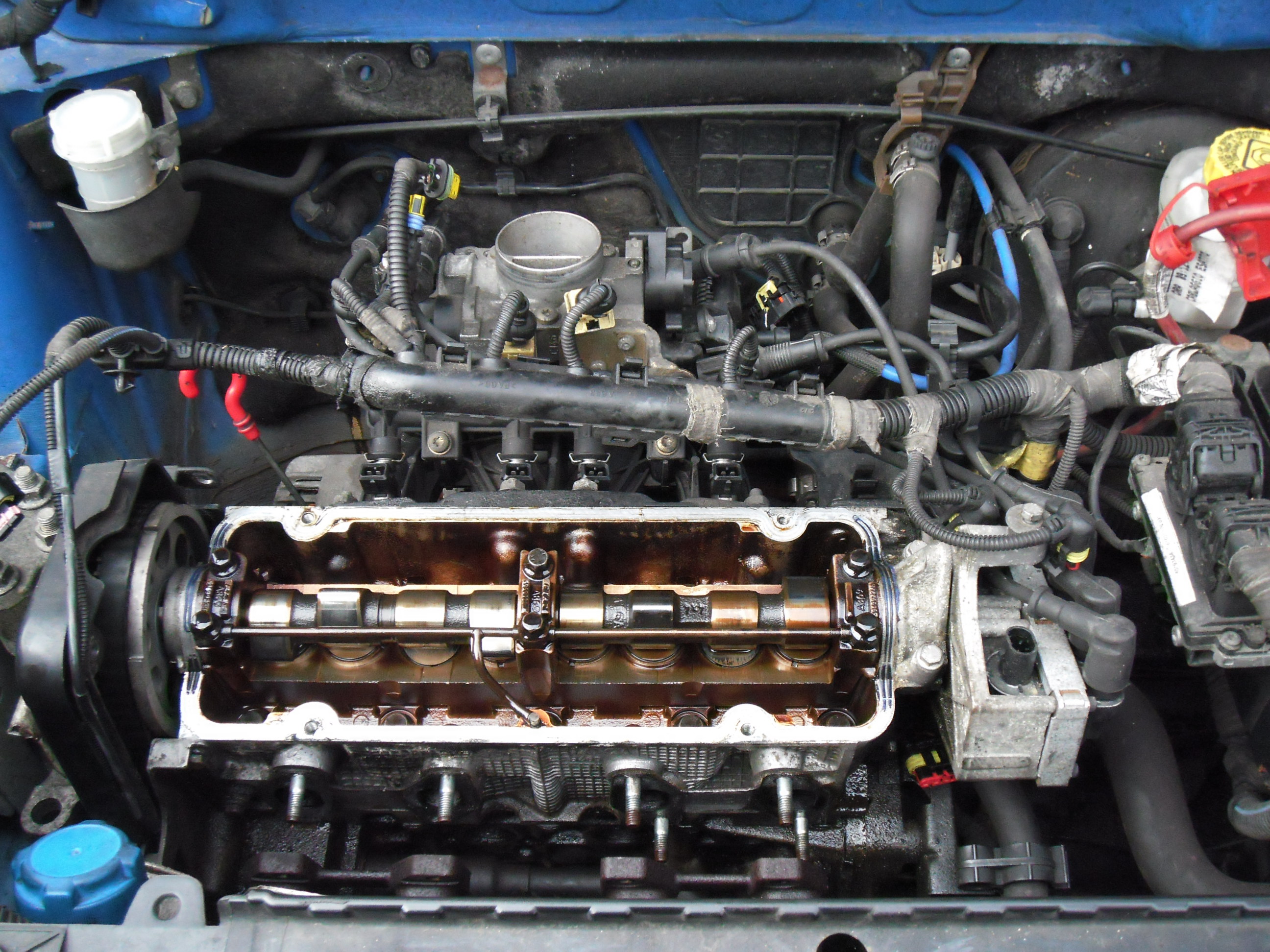

Hi Lorna,
lift the bonnet, and they are at the back of the enginebay
under the shiny DOME rivets at the TOP of picture,
slightly left of centre.. and under BROWN plastic frame + Rubber pipe 3/4 across to right,
all you have to do is reach it and squeeze the edges/corners IN..
this pic ;
will give you a clue.. but reading through the couple of other threads..in BLUE..;)
will give you other views,and more written info,
it should take you 5 / 10 mins to clear out the tubes..so well worth having a quick read..then doing it(y)
charlie
