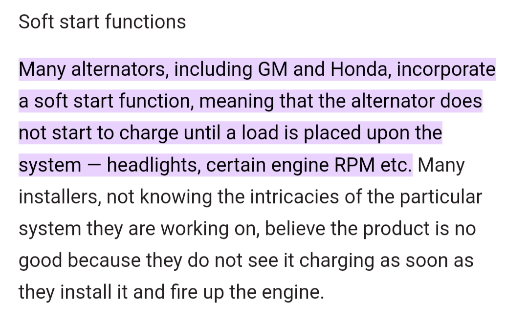

Are we sure there's even a problem
We need someone with the same same alternator and regulator to test theirs
According to the specs for the F00M144128 is got
Soft start 30%
Load response control
I wouldn't expect it to fire into life instantly
My 2010 panda does within 1/4 second of cranking
But a 9 year old Kia piccanto does not
Measured across the battery, there is a delay of around 5 seconds before it outputs any voltage
Soft start 30%
That a 100% working car that's never had a charging issue
Well this will be easy to test: instead of waiting until the engine revs itself to about 1000rpm I can go right to revving it a bit myself and see if the alternator is indeed soft-starting or really needs those 1000 rpm.
I thought of that
But then realised if the revs rise it's suppose to kick in if you raise the revs
So it's 50/50
If it doesn't kick we know it's supposed to be like that
But if it does kick in we are none the wiser

I thought soft start is to eliminate most of the drag from the alternator to make it easier to start, for vehicles with larger alternators
It then ramps it up slowly from 30% to reduce the snatch on the belt
And has little or nothing to do with emissions

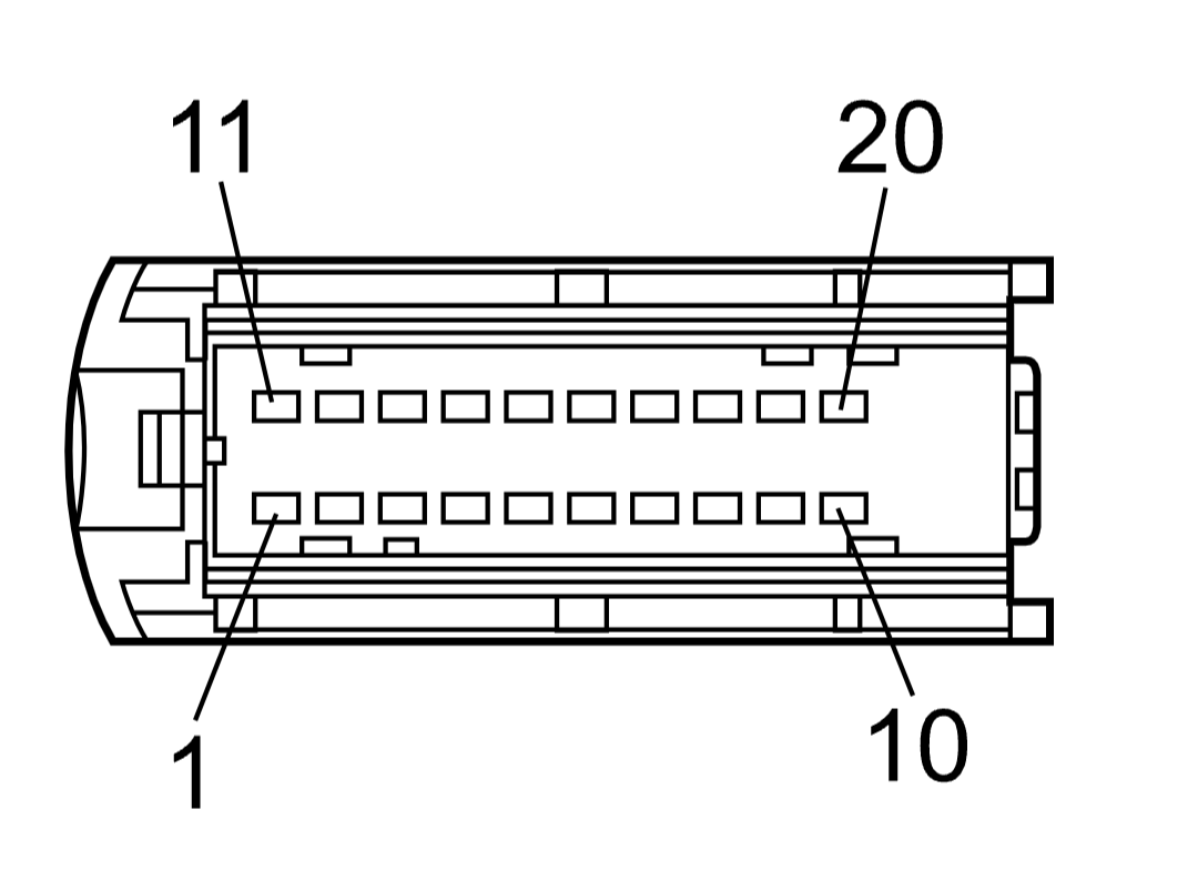

What's the access to D004 connector like
One side
Pin 1 do you have brown and black
Pin 2 do you have yellow and red
The other
Pin 2 do you have brown and green
Pin 1 should be the thickest wire in there
