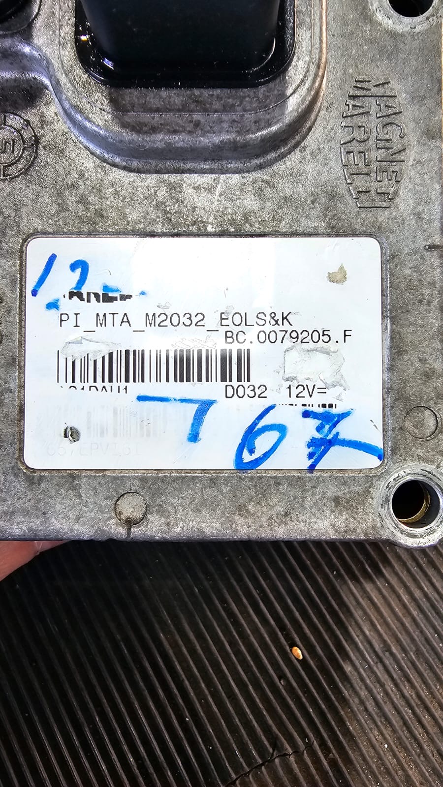

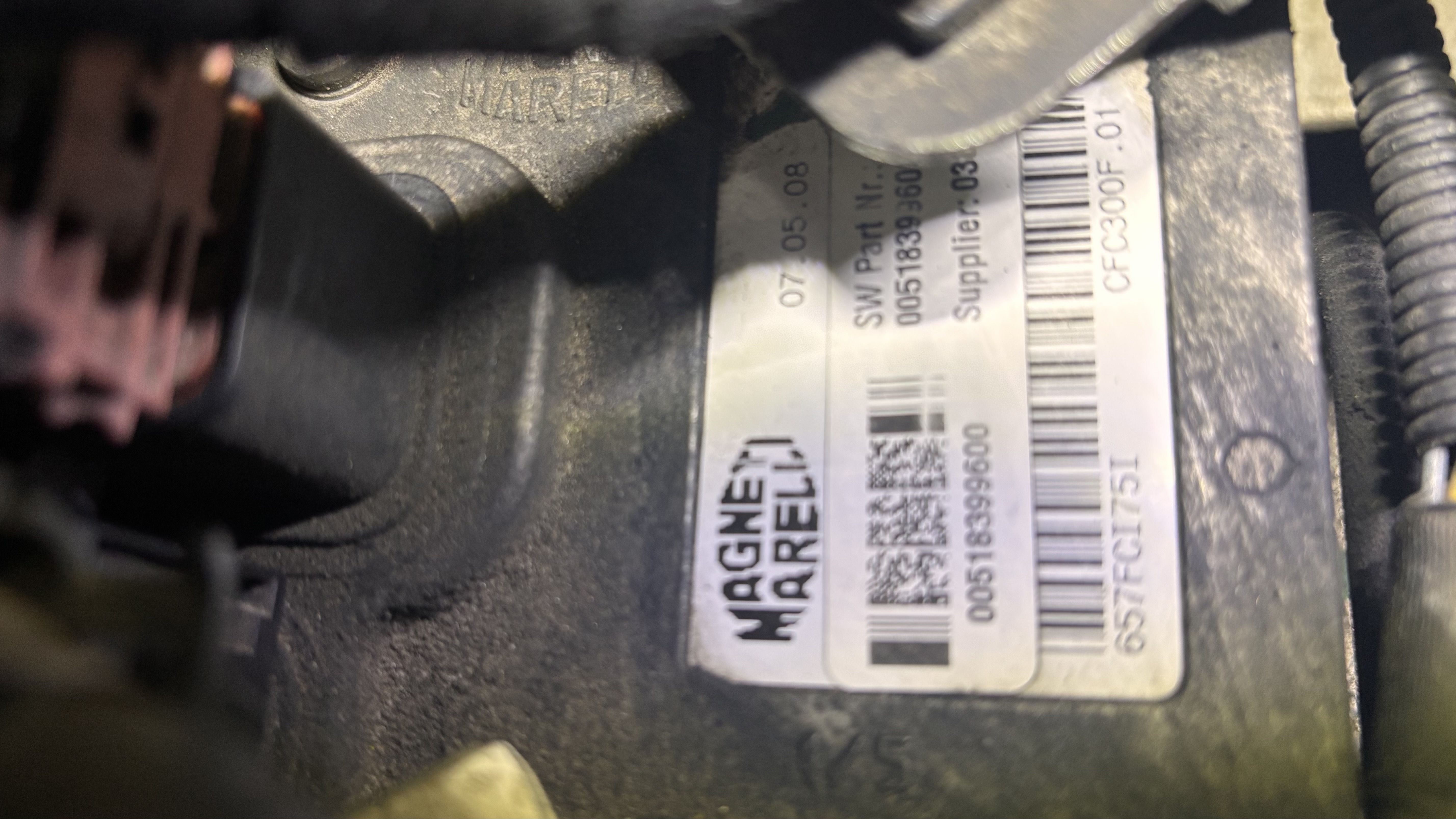

I removed the transmission module, but it from an Alfa Romeo 159. I wanted to know if this module would fit on a Fiat. I аm thinking about trying to replace it and check.
Ofcourse its a different part number…
Good afternoon, today I replaced the robot module, turned on the ignition, and nothing changed. I tried to clear the errors, but it didn't work either. Everything remained the same, U1601. It started up, and even the gears switched..
