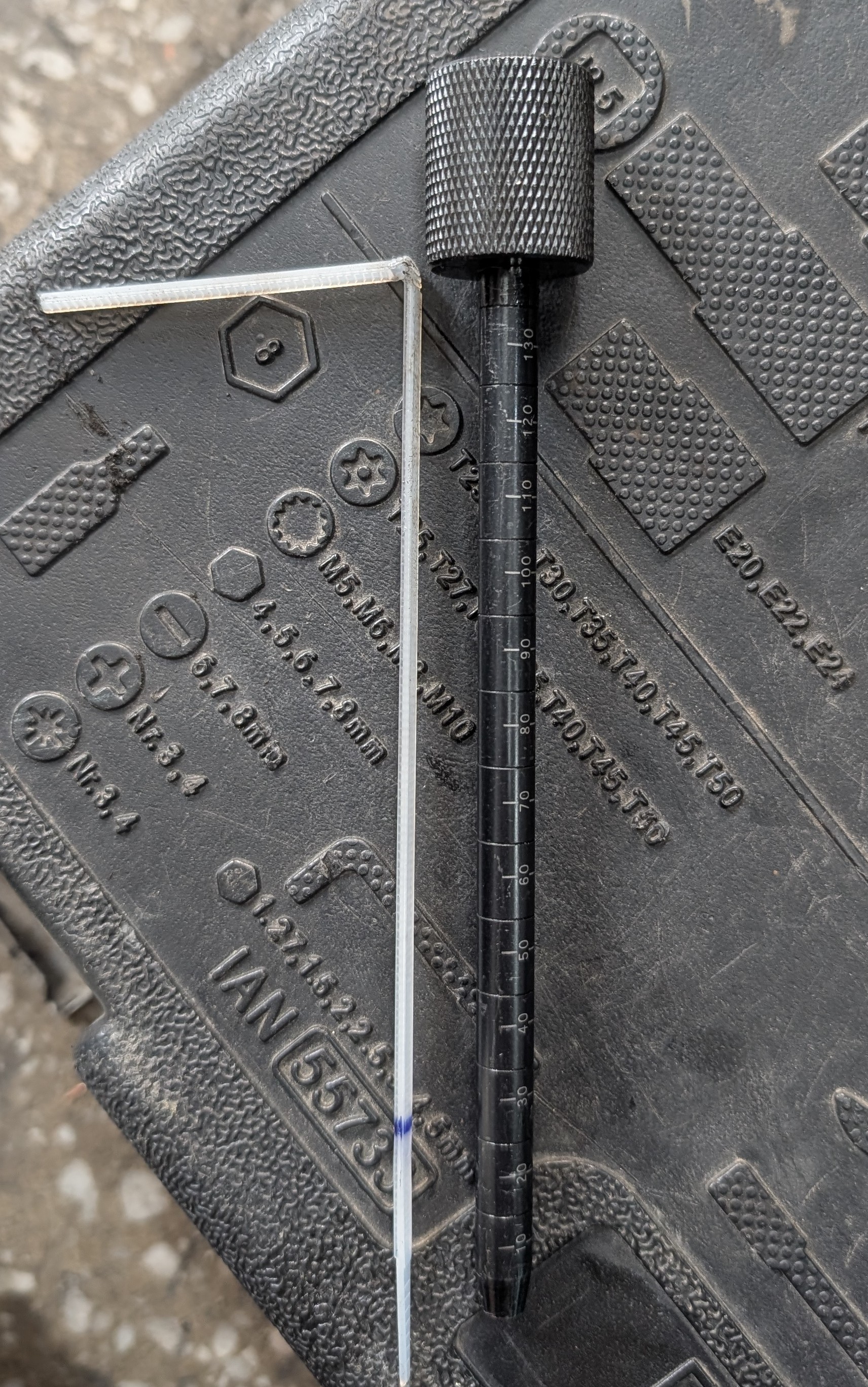

I've successfully check the oil level using this chart. At 50 degrees with engine running in P need to have 26mm on the dipstick. According to a guy from internet I've choose a plastic zip tie marked at 26mm and it was better to see the oil. Good luck!
