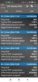

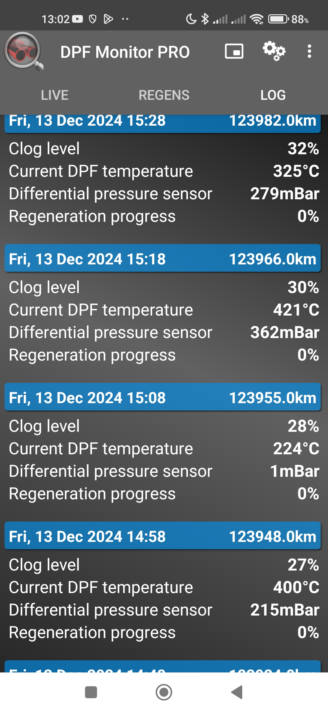

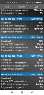

Watching the differential pressure sensor readings in the wonderfully useful DPF Monitor app https://play.google.com/store/apps/details?id=com.kapron.ap.dpfmonitor&hl=en
I was able to ascertain that the pressure readings go off the chart. Here's some examples:
I took it for a long old drive on Saturday (with P1206 still present, so progress was slow), belted up and down the M1 a junction (J26->J25->J26) and parked up at a quiet industrial estate with the idea of clearing the P1206 quickly and forcing a regen with the pedal press trick. No dice. Mind you by this time the blockage was showing as 107%.

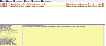

After getting the engine to temperature, I popped open the bonnet, fired up Multiecuscan, connected to the new OBD port which forms part of the SGW bypass cable.
Cleared the two codes (P1206-22, P2002-22), selected Forced Regen and execute and away we went (sorry for poor quality photos, done on my phone as I didn't want to touch the laptop in case I broke something) :
The engine then revved gradually up to 3500 rpm where it stayed for a good 10 minutes or so.
All it was doing at this stage was a normal regeneration as the clogging level got down to 10% . Eventually the forced regen began and started ticking upwards, with the DPF reaching an eye-watering 632 degrees C
Finally the rev counter dropped down to idle. Note the EML came back on during the process but the forced regen ignored it - in 'normal conditions' this would have stopped an active regen.
The screen I wanted to see:
What concerned me a little was the clogging reading now said 85%.....which was more than when I started. However, I had faith. I deleted the P1206-22 code which had popped up again (no P2002-22 this time, strangely).

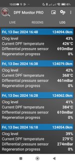

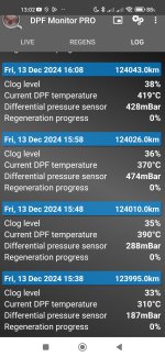

So, I took the van for a long old drive yesterday as part of my job. I didn't have my laptop with me so couldn't log on MultiEcuScan but I wass running the DPF monitor.
I did one quick Nottingham->Leicester->Nottingham job (71 miles) during which time the van did another little regen itself, all good, no EML.
Then I did Nottingham to London. During this time the back pressure shot up, with differential pressure sensor readings way too high. Eventually, the yellow light of doom came on. (earliest on the right, newest on the left)
Screenshot_2024-12-14-13-03-20-726_com.kapron.ap.dpfmonitor.jpgScreenshot_2024-12-14-13-03-10-527_com.kapron.ap.dpfmonitor.jpgScreenshot_2024-12-14-13-02-55-878_com.kapron.ap.dpfmonitor.jpgScreenshot_2024-12-14-13-02-39-190_com.kapron.ap.dpfmonitor.jpgScreenshot_2024-12-14-13-02-13-076_com.kapron.ap.dpfmonitor.jpg
Same codes as before, cleared whilst in London using CarScanner. Nope, popped up straight away again. By the time I was near home the pressure readings were silly high.

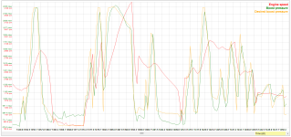

Just a small sample size of the turbo pressure at around 2500-3000rpm. In the short time I've owned the van it's never thrown an underboost or overboost pressure code - no turbo codes at all. The only codes are 1206 and 2002 - 1st level clogging exceeded (1206), 2nd level clogging exceeded (2002)

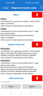

Van is now at garage (overnight stay) for a proper DPF assessment. On the way there, it chucked up two turbo codes (P234 and P2563). The technician who's working on it suspects the throttle valve is sticking. Brief diagnostics I did on this (no records as I was trialling a Mucar Driverscan dongle) confirmed the same.
Turbo replaced plus oil feed/oil return and an oil/filter change (annoyingly I did one myself less than a thousand miles ago).
Differential pressures now reverted back to 'within limits'. Also did a passive regen itself at slow speeds on the way back from the garage - clogging went down from 75% to 20% or so : good to see.
Smoke test by garage found no leaks at all, but did discover turbo was completely goosed. Pulls like a train again now.
