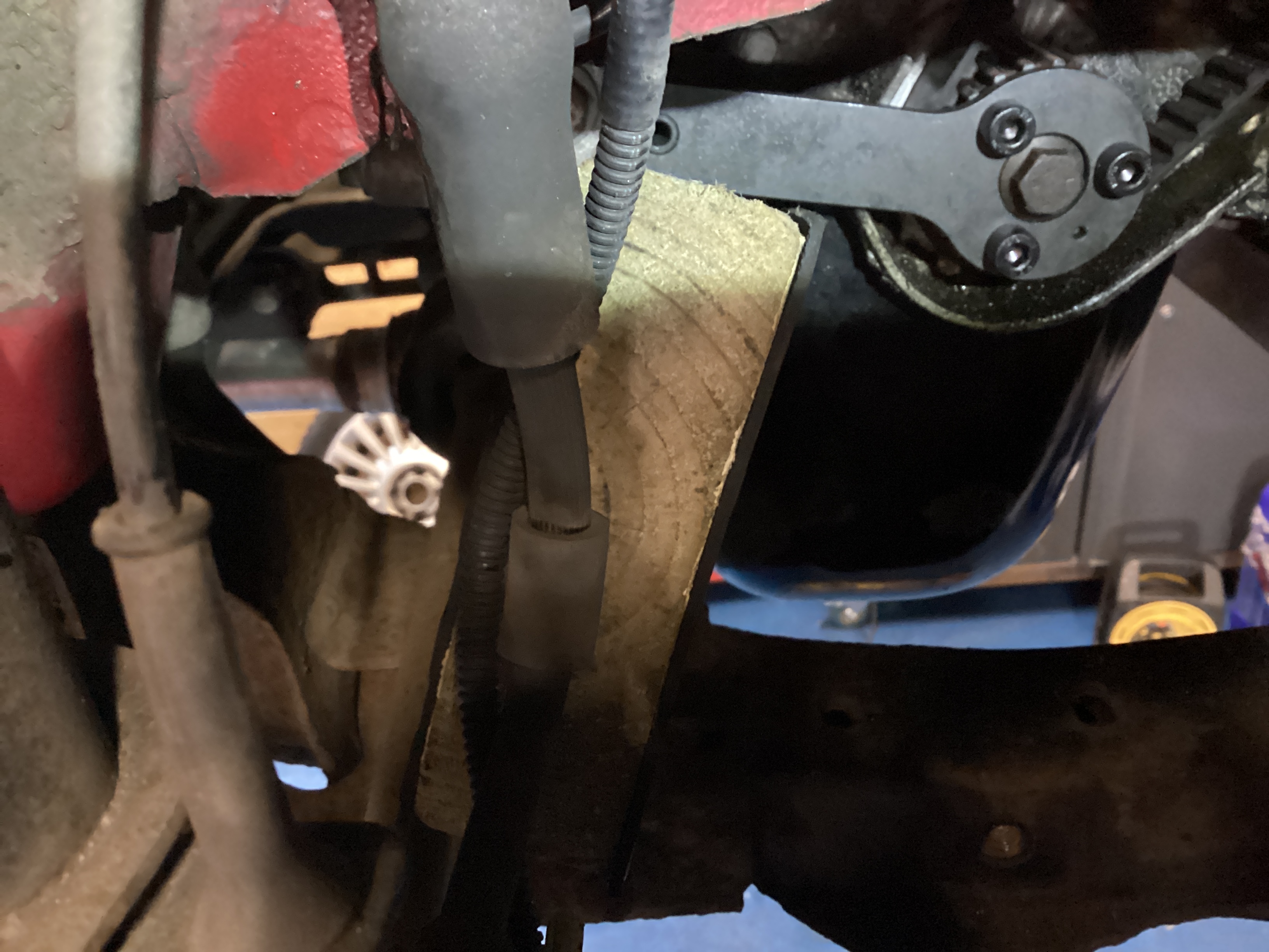

First job timing belt, once the drivers side covers were removed, you can get to the pulley, didn’t take any pictures of that but when it was off I could see that the pulley main seal was leaking so ordered a main seal, marked both pulleys with tippex for alignment at TDC before removing the crank sprocket in order to get to the main seal, was surprised that the factory manual said to use the crank locking tool to use as a lever, it showed to place it against a bolt but on my engine that was too far away from the end of the tool so I improvise with a block of wood, turned out it wasn’t very tight, it’s torqued to 20NM plus 110 degrees, I’d guess about 140 NM
