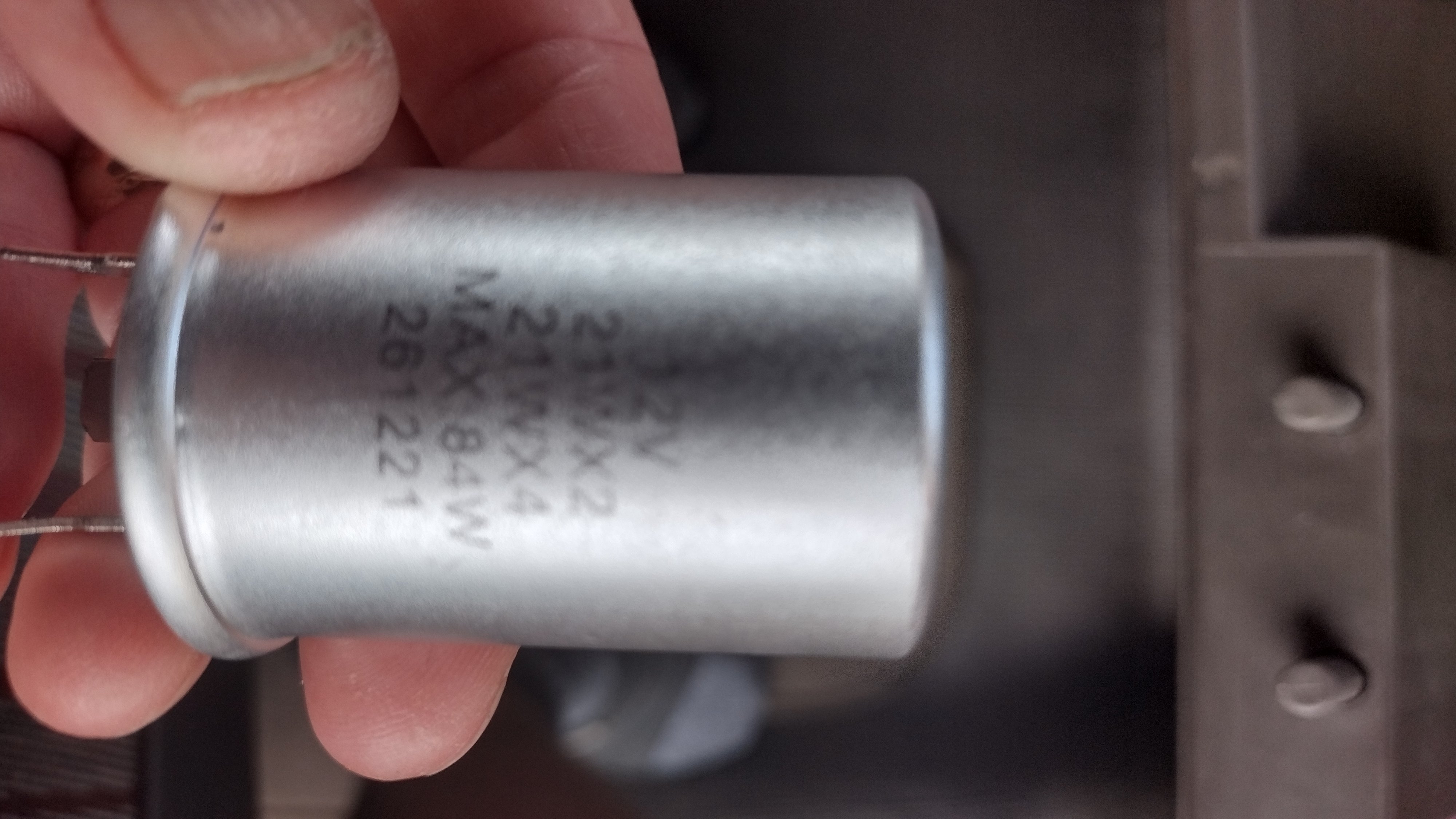

Hi folks thanks for the info. I'm gonna look at the old and new relays when I can and let you know. Also get a test lamp. I've also been in contact with a auto electrician local to me and have quoted £114 to diagnose and hopefully fix the problem but will still have look myself first.
Hi , photos attached of the relays. The silver cylinder one is the new relay and the black cubed one is the old one
The new cylindrical unit is rated at 4 x 21W (bulbs) or 84W maximum. The old black cuboid is able to supply 4 x 21W bubs + 2 x 5W side indicator repeaters (if fitted). The old one is the higher specification unit. KEEP IT!
Both units will support 4 off hazard flashers, but the new one is not fully adequate if you have side repeater indicator lamps.
