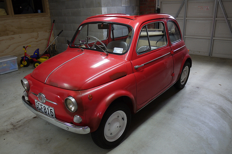

I bought the car in about October last year through an online auction. It was in a different city so I didn't view it first. A friend had a quick look and I took a bit of a leap of faith. I's a 1963 D model, which has had the rear roof unbolted to make it a "Transformable" of sorts. The existing roof just used the standard roof frame and some extra cross bars. You had to fold it back by hand but it worked well enough. The car ran well and I had a blast driving around for 3 months of summer.

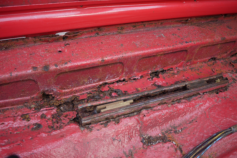

It was pretty obvious the car had rust but I ignored this while I had fun. Earlier this year the car failed its warrant of fitness test so it was time to go and see my mate Dan, who's a panel beater, and figure how bad the rust really was. The pics here show some of what was in the sills and floor. The car had a "makeover" in about 1990, and was probably quite god then, but 22 more years on the road and the rust had slowly done its job. Front panel, battery ray, drivers door, floor, inner and outer sills all needed replacing...
Faced with either a full resto or a trip to the dump I decided to save the car. And so the learning curve stated! I'll post up soon with some pics on whee the panel work has got to so far, some details of the fiat 126 donor I found and some of the work I've done on the rest of the car while the panel gets done.

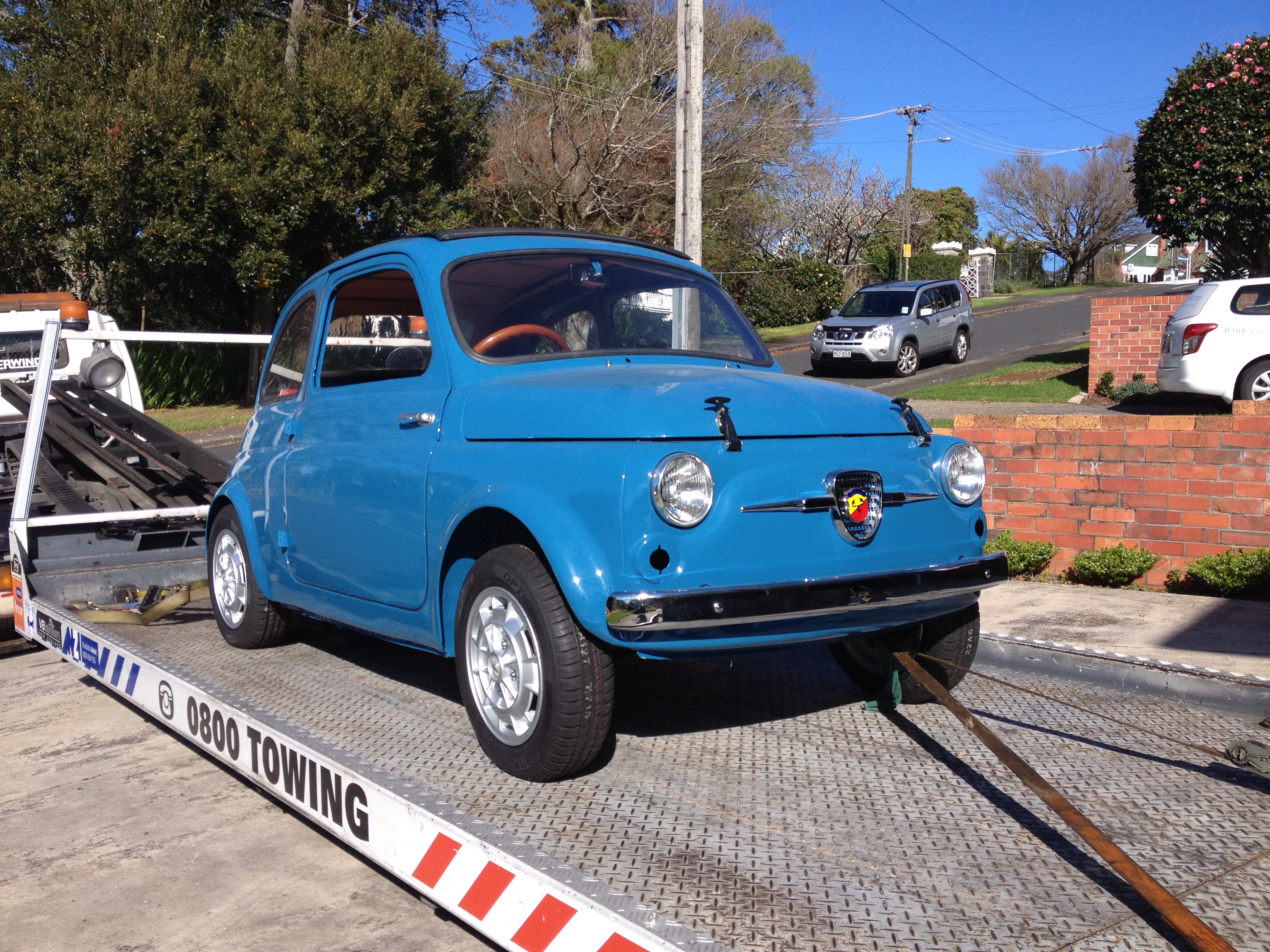

Shifting the car was a laugh. I was planning to trailer it, but when the moving van turned up with a tail lift we simply put one guy in the car, rolled the back wheels onto the lift and then had 3 guys lift the front as we raised the lift. So the car travelled in style.

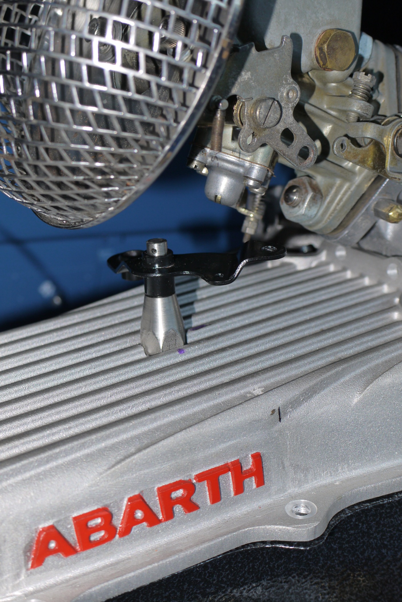

The next problem was to mount the throttle cable for the FZD carb. There is a problem here because I am using an Abarth fan cover, which has no air filter box etc, and also has no mount for the carb activating arm. I had orginally intended to use the mount from the old cover, carefully removed and cleaned up, and then fixed onto the alloy cover. However, my mechanic friend who is helping with the car was rightly horified at this "bodge" and insisted on turning up a nice stainless steel pedestal with a spindle on which to mount the activating arm. Much better! All that's left is to fabricate a bracket to hold the end of the cable.

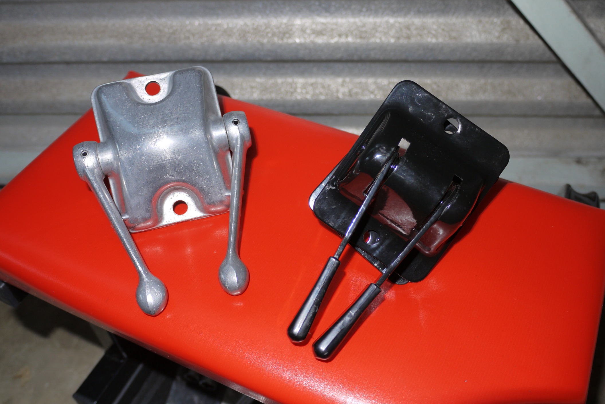

Speaking of cables, I have also at last found an original alloy starter and choke cable lever set from the early Nouva and D models. These are just so much nicer than the pressed steel used in later cars.

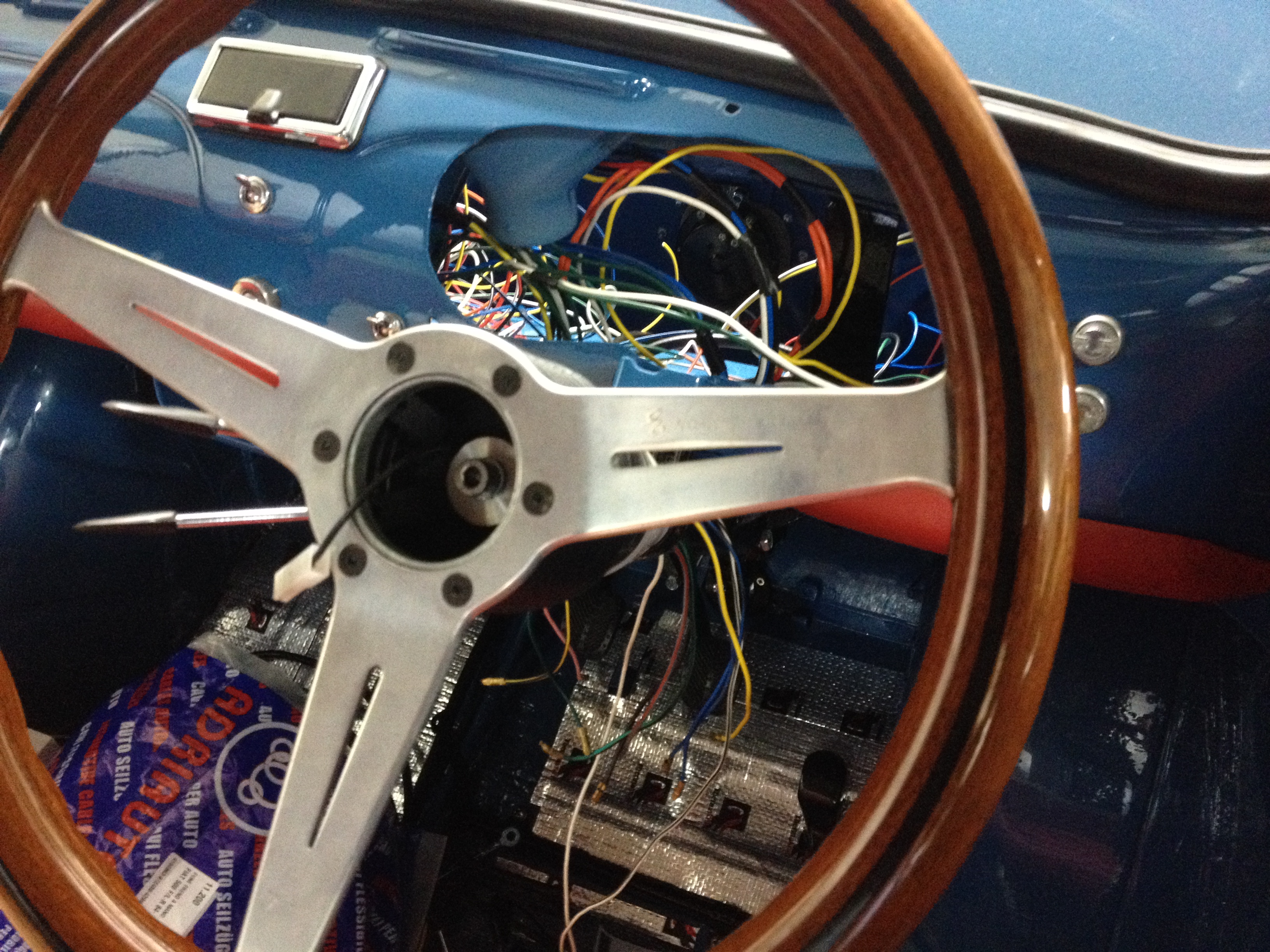

Still waiting for the auto electrician to complete my new wiring loom, so next job is the windows - which looks fiddly - and to mount the oil cooler radiator. I'll post an update on that job as I know a lot of people are interested in adding one to their car.

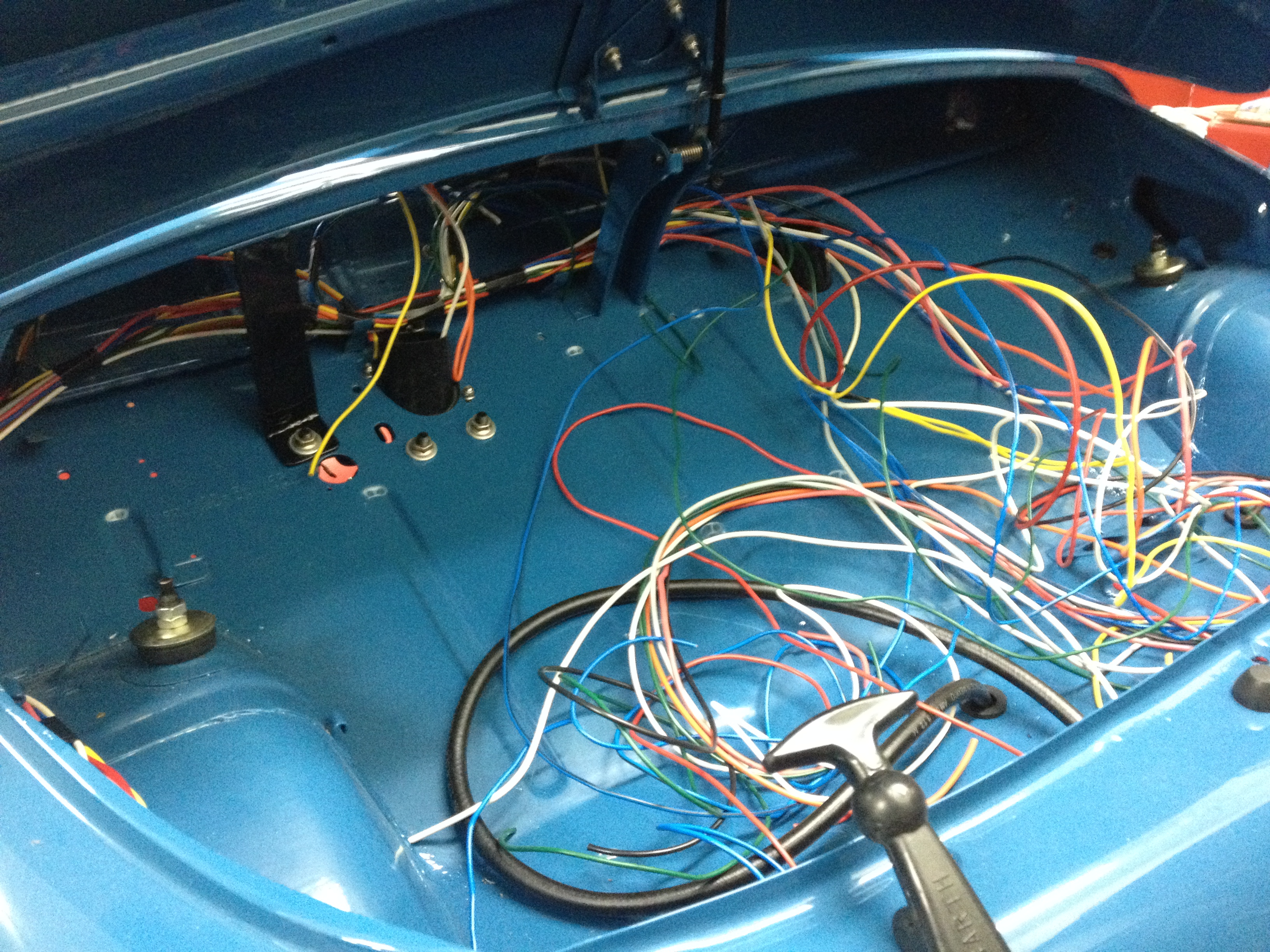

Jeez, I just realised it is six months since my last post! I'm embarrassed to say very little progress has been made. Things stalled while I moved house in Feb and then the only stuff I had time for was small, boring jobs like refurbishing the window winders and windscreen wiper gear etc. Hardly very photo friendly. The auto sparkey called and said he was ready to put the loom in the car, so off it went on the back of the truck... that was three months ago! He's building a complete new custom loom with lots of small mods, as well as sorting the rev counter etc, and since he's only working on it between his more lucrative day jobs it's all taking a while. I went to see the car today and despite it being far from finished he reckoned it was not too far off. Here's hoping! More soon.
Cheers
Roger

Yeehaa! After being held up for months while the auto electrician worked on the custom loom I finally got my car back last week. Best Christmas present EVER. After mounting the carb and sorting some temporary leads and coil we were FINALLY able to start her up. She started on the 2nd try! A bit of fiddling to get the timing into the right ballpark and she's running well, although I have limited myself to low revs and not more than a minute or so total running because I want to get the engine under load as soon as possible so everything beds in right. The exhaust sounds awesome and the cam is not at all lumpy. The engine balancing obviously paid off too since the engine remains very stable under power - I guess the stronger mounting spring is also playing a role there too.
Next steps are a full check of everything from brakes to wheel nuts and then a brief road test to check clutch and gearbox are working as they should. Wow, nearly three years after I started I can hardly believe this project might actually be finished soon! I've posted a very short video of the engine running on youtube, link listed below. Sorry about the low quality, I'll do something better when I get a chance.
