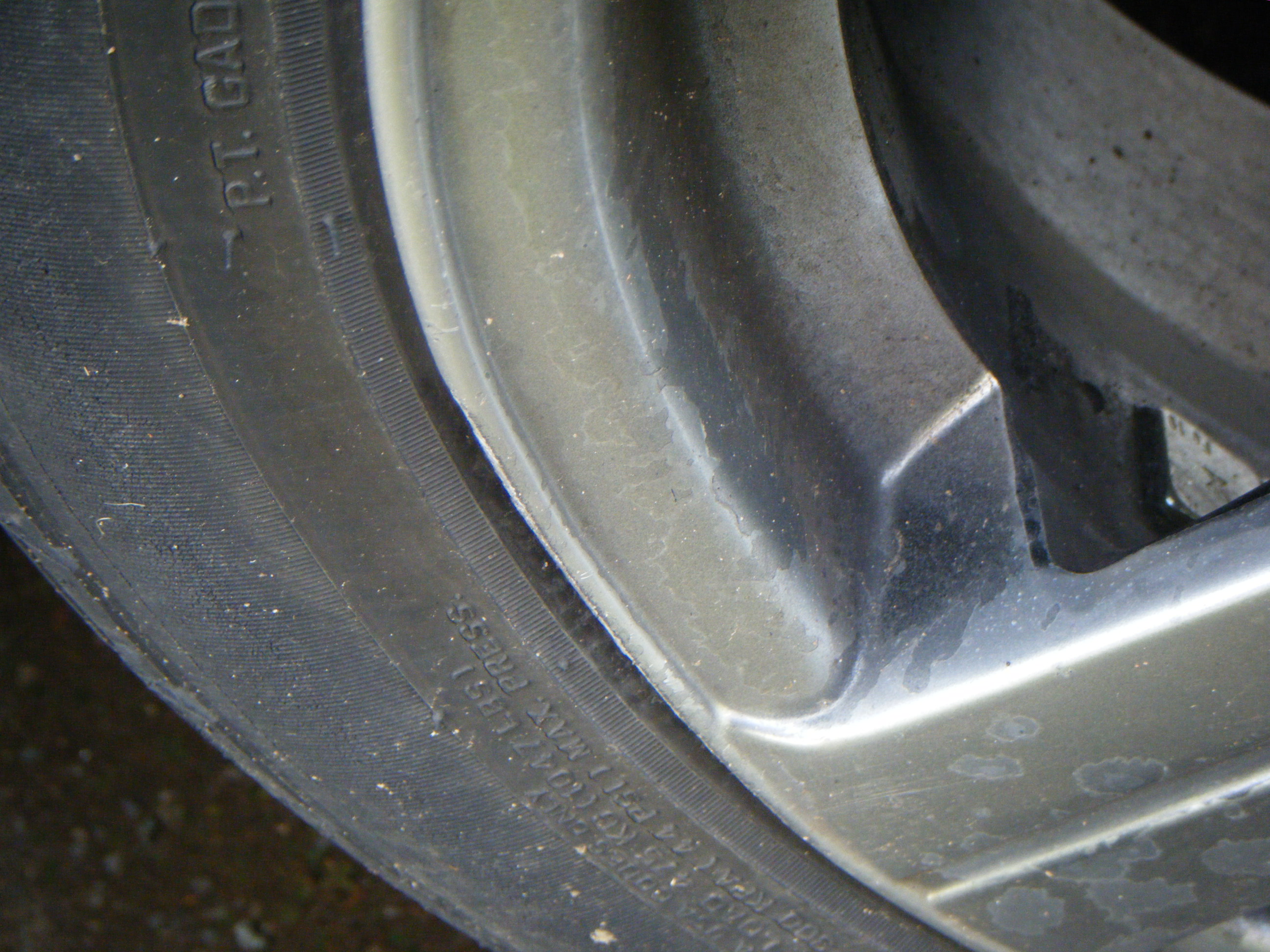

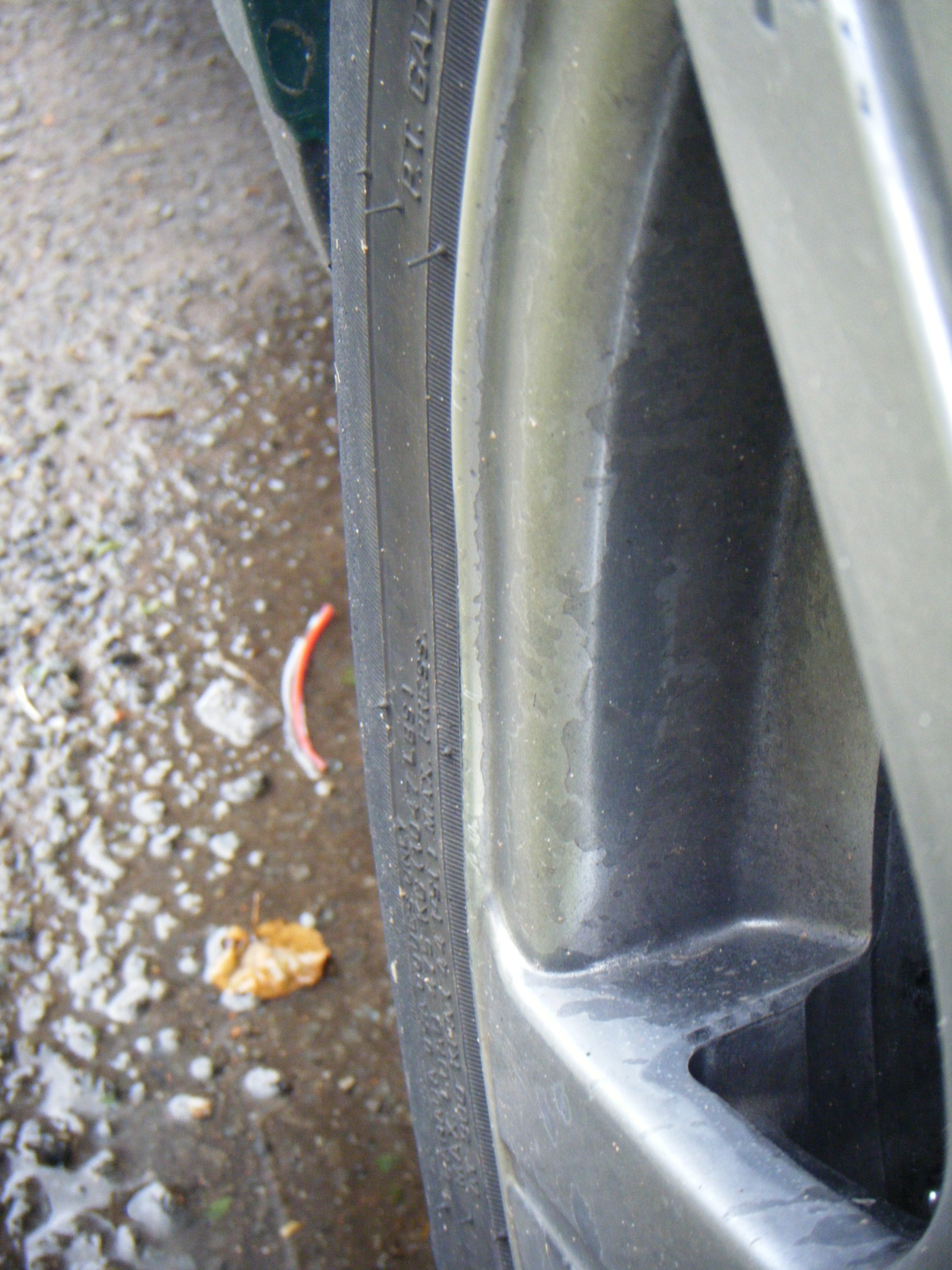

think it might be sorted. i swaped the wheels back to front and when doing it i noticed a little dent in the rim of one of the front wheels the dent hasnt gone through to the inside of the wheel but im sure it might have been that. so i tried up2 around 65mph because theres no good fast roads close lol and that was a 50mph road :( and no shake as i could feel anyway. off down donington park in a few days and ive told the tomtom take fastest route so fingers crossed lol just thought id let ye know.

The dent looks like a machine has pushed it in? There no damage to the metal/paint and the tyre is holding air. Will take a piccy show ye.

Dave,
I would say that that wheel has suffered a blow-out whilst cornering, and the exposed rim has been slid across the tarmac. That's the ony rational explanation I can think of for the scrapes being perpendicular to the wheel face.
As a rule of thumb, if the dent leads to a depression in the tyre wall at that point, it needs sorting. It presents a weak-spot where the tyre can unseat the bead.

Least its on the back for now. I had to ditch mine to the kerb in snow/ice once, either that or hit the silly cow who pulled out on me, which left similar scrapes as it crunched down the kerb, but yeah, something not so nice has happened to it...where did you get them from? Is there a buckle on it, would have thought so with that bang and dent, should be able to get it repaired tho.
EDIT:
remember tho, you wont have got rid of that wobble, you just moved it. O and there is a good referb company in Stroud in Rochester, dunno what they are called, would have to google, but you can send off to them for fixing.
