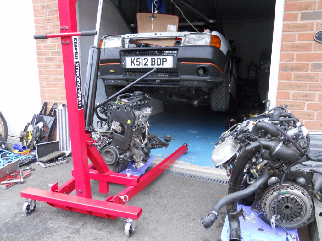

Tested my wiring outside of the car with the dials and accelerator pedal on the engine and fiatECUScan on a laptop. It's a good result, with the immobiliser deactivating correctly and power going to coils and injectors. Response from the pedal is fine and readings seem normal, etc. Should be good enough to start the engine with in the near future.

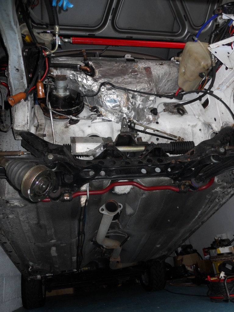

Took 1st T-Jet engine out and have been dressing the new engine in preparation to put it in tomorrow.
Need to make a flare and put a union on a trimmed T-jet clutch hydraulic pipe to connect to the existing line and facilitate the use of the "hydraulic bearing" on the T-jet gearbox. Don't have kit and am loathed to spend £150 on something that I probably won't use ten times, so might actually have to pay someone to do something for me!
On the subject of clutch hydraulics, I was investigating throttle pedal mounting and realised the clutch master cylinder was leaking very badly. Hard to believe it worked at all a couple of months ago. It actually squirts out when you press the pedal. Bit strange.
Tomorrow
Wash the engine bay
Dress engine and mate gearbox
Put new engine and gearbox back in
Put oil in engine and box (if I can find gearbox oil)
Hook up fuel lines
Mount intercooler and pipe it in
I may go for a start. There won't be cooling, so it really will be a 10 second affair. If successful, it would be enough for me to be able to go ahead and make a little loom up for the electronics.
