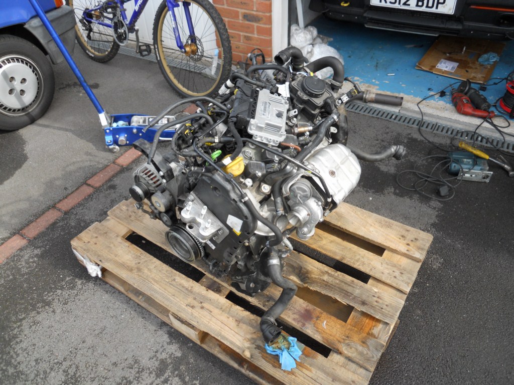

Some unexpected complication arrived on a pallet. An Abarth spec T-Jet:
Handy uprated cams and only 10k on the clock. With the sort of boost I want to run, airflow is an issue and the the cams will really help, so looks like the GP T-Jet will be coming out to be replaced by this soon. Got its own set of ECUs and key as well and I have seen the engine running, so know the fuel cut-off issue does not apply here as it still does on the other set.
So, although I have plans to fit my hybrid turbo to this engine of course, I am thinking I could run the engine as it is for a while, just to get things off the ground. It is feasible that I could have it ready for a pre-booked trackday on 14th Nov at Mallory Park. This is mostly because I don't need to worry about a remap and new injectors in the very short term, which pleases my bank balance as much as anything else. I have thought about selling the "old" engine, but it's a bit difficult to sell right now without a turbo. Obviously the idea of a spare engine seems like luxury peace of mind, but they are worth a few bob.

lewey, good news on the punto abarth engine! Good work! What BHP are these out the box? im guessing u didnt pay anywhere near the 2.5k of the 500 abarth engine? Are there any differences between the 500 abarth and punto abarth engines?
Also, it would be damn cool if you got the Abarth Red engine cover too, so it looks like the 500/punto abarth engine when u open the bonnet of ur uno! Uno Abarth! awesome!
