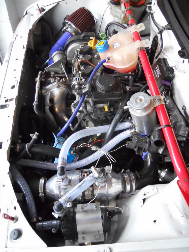

  • Engine temps are fine. Original Uno radiator and the well designed T-Jet cooling jacket are great at this power level. With a cool down period on track, there was no fan on when stopped.
  • Charge cooler system was getting far too hot. Header tank too hot to touch. It seems to be working and water is moving, it just isn't enough. Will need a better radiator I think and possibly a position for it away from everything else. Because of the heat, I was only getting 0.5bar boost after the first lap.

A couple of shots of the engine bay as it is now. Obviously a few things are a bit last minute and untidy as they were done for the trackday. Going to have to factor in a much larger radiator for the charge cooler. This will impact other things. Air filter will be placed down low in the wheel arch perhaps, which will make room for the main coolant header on the drivers wing perhaps.

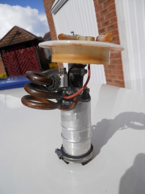

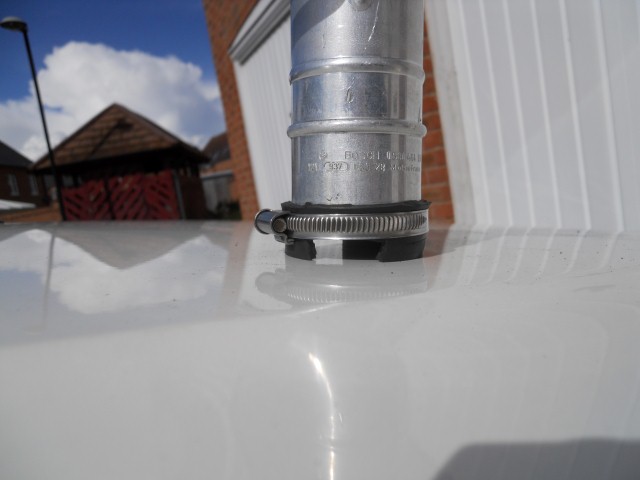

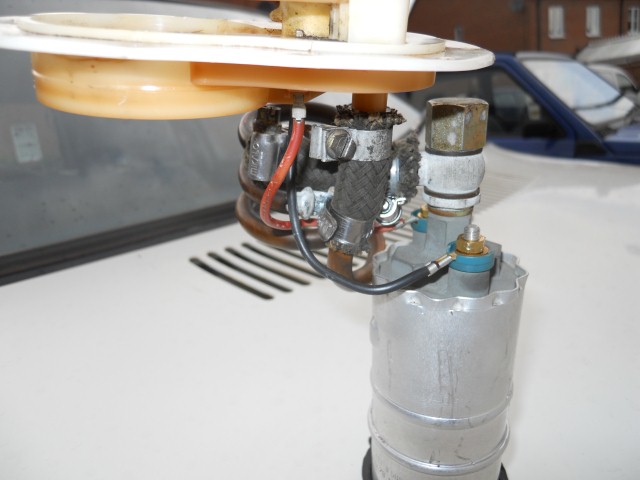

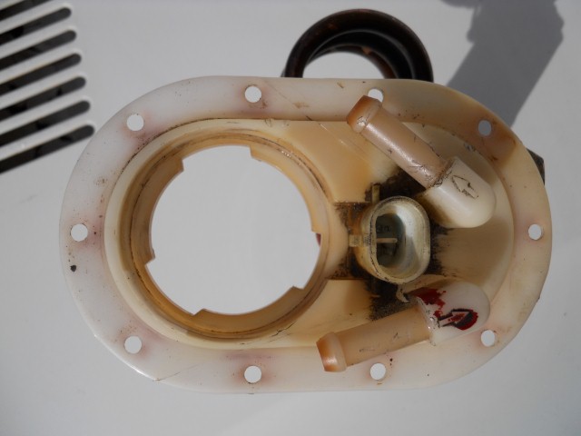

I wasn't happy with the old UT fuel tank setup, so I sold the tank and I have just made my own setup that fits into a standard SPI uno tank. I've used an old Lancia Thema fuel pump with some copper pipe from the same to provide a little swirling. It all fits into the impossibly small gap in the tank and allows fitment of the level device sensor still. It will sit in the 4 prongs that come from the bottom of the tank just like the original unit did and is elevated off the floor using some rubber pipe with two cuts in it. The SPI tank has the same little bowl baffling in the bottom as the UT tank. I don't know if it will all work or not.
