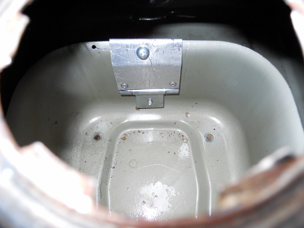

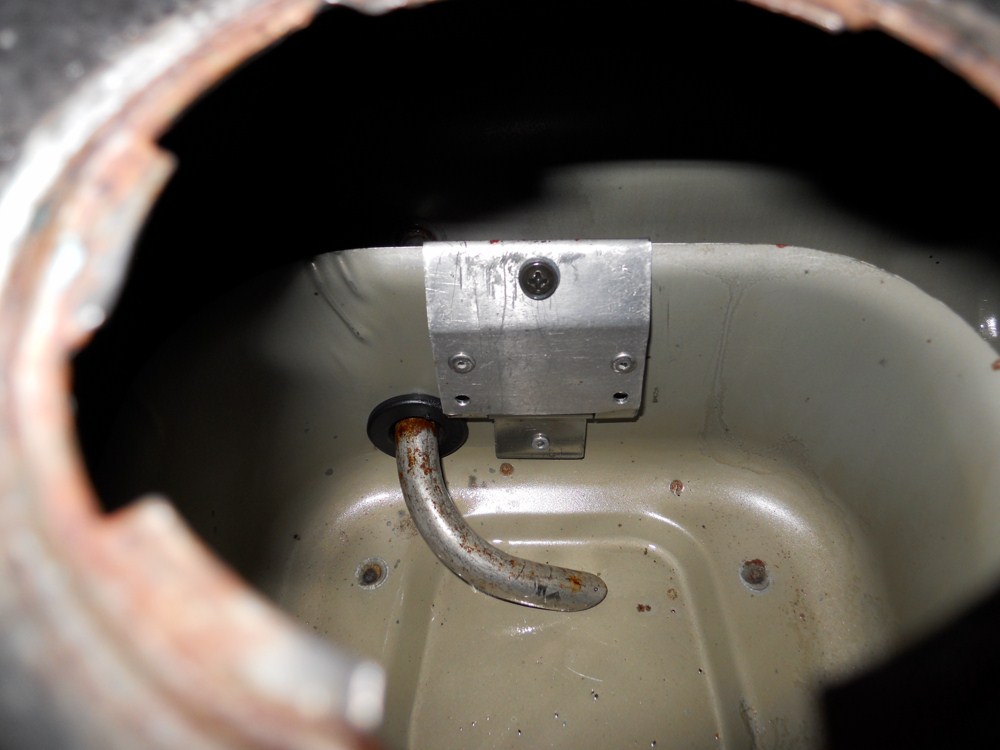

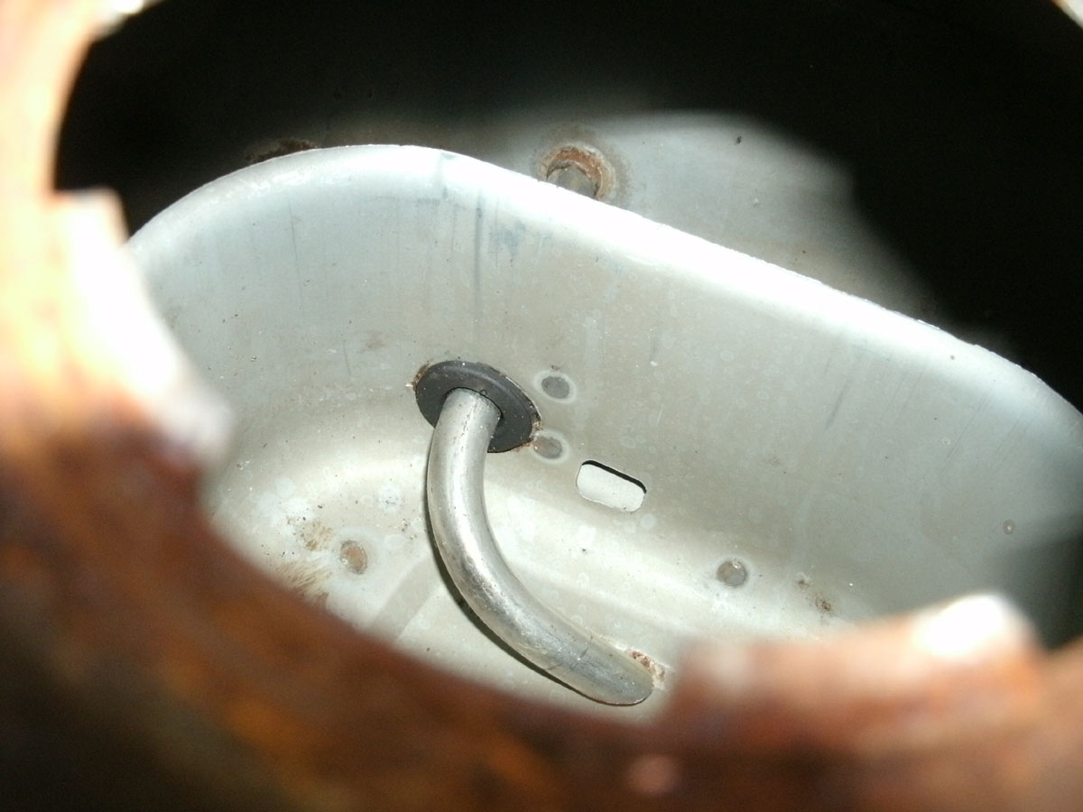

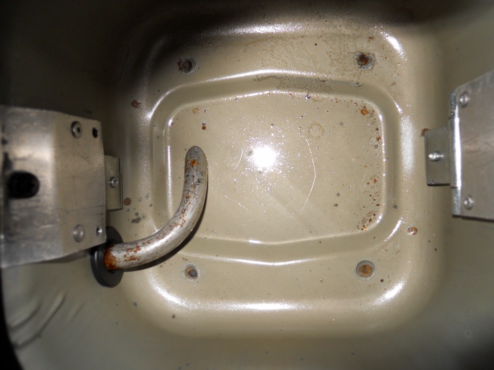

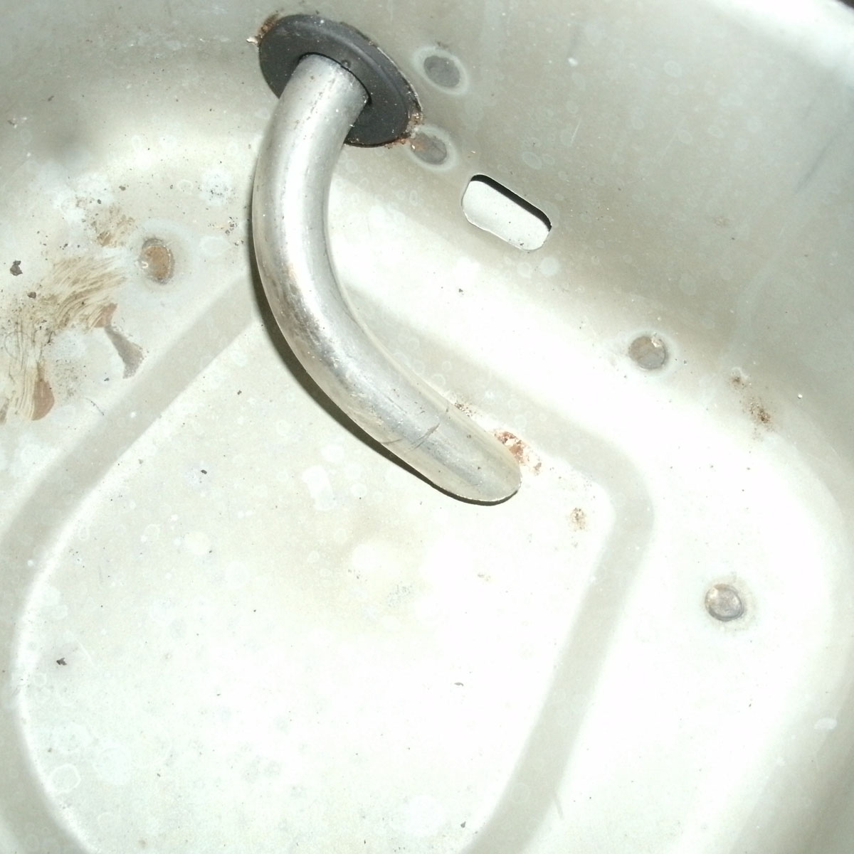

The tank is off and as I thought is in excellent condition inside and out with little or no crap in it. Photos with flash on to highlight things as much as possible; most of the little rust specs aren't visible in daylight. As you can see, the outlet pipe comes into the little baffled box and almost rests on the base of it. The only thing I can think of to do it maybe bend the pipe up slightly to allow easier input of petrol into it as the gap is current very small. Will leave me more open to starvation potentially. Also, I don't see how I can could clean the inside of the tank at all with the access I have. I'm curious to give it a wipe in the baffled section, but afraid to lose anything I put down there!
The rear trapdoor is slightly reluctant to close under gravity like the front one, but the lightest tap sees it move, so pretty sure it would move with petrol anywhere near it. Again, hard to fix with the access!

Anyway I’m not sure your tank exit is faulty. what’s the point of having a 12mm pipe if the entrance is restricted?
Acutely I just dug mine out and perhaps it’s the angle that mates it look like it’s stuck to the bottom of the tank??

Any signes of impacu to the tank bottom? An easy way of increasing the gap could be with an extra long punch when your sure no vapour is in the tank. Don’t want an explosion no do ya?

I am tempted to bend the outlet tube up slightly. If I don't, I basically have definitely not fixed the issue, which is a bit annoying! I will try to make a device to measure the gap it sucks from in case it is more than it looks!

Gonna bend and put back in this weekend. Thought about another tank. There was an SPI version of the car with familiar in tank setup, but doesn't appear to have a swirl pot as part of the design like others do! I really can't be bothered to fit something else though otherwise as I don't actually have a fuel problem in terms of engine performance, just a suspiciously struggling-sounding, cavitation-ridden pump (whichever pump I use).
