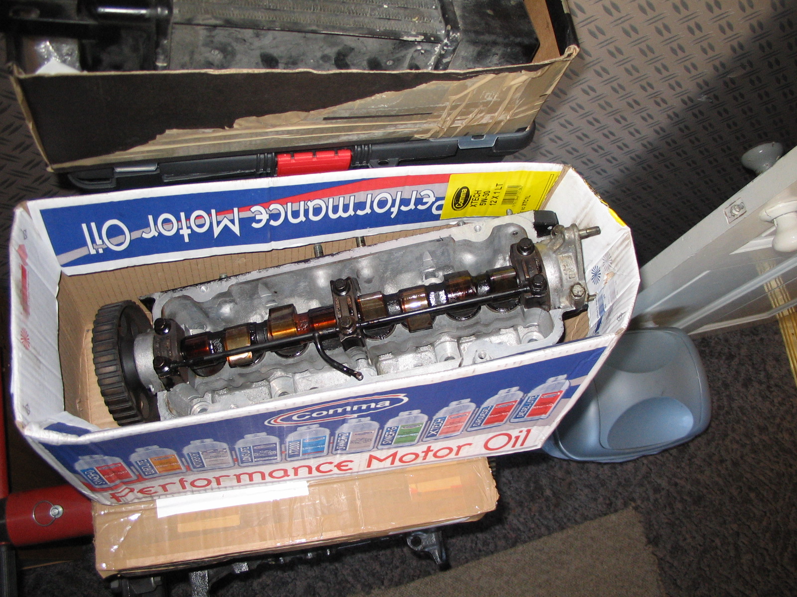

Further update, engine bay is all clean now, and the abarth front bumper is off (will get some pics of this tomorrow), cylinder head is rebuilt and shimmed and i have a set of chrome 7 spoke 14s to be fitted when i get around to it! will be changing the tyres for 195/45/14s. Any recommendations besides conti sport contacts or uniroyals? i've heard good things about the uniroyals.
