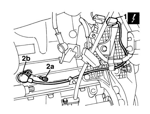

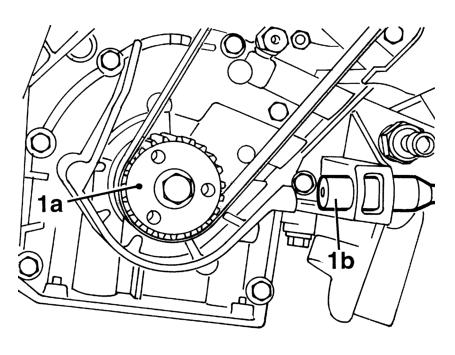

Yes I'd go initially for the connector of the crank sensor (item 1) and give it a clean up with some contact cleaner
But after that then it would more likely be the sensor itself as it's an internal phonic wheel pick up off the flywheel with the JTD (similar to the ABS pickup)
unlike the mag pick up straight off the crank pulley of the petrol versions (apart from Abarth)
Looks good - pardon me for being thick, but which side of the engine does the JTD 115 drawing refer to? If it's only a clip and a bolt to shift to replace the crank sensor, I can do it at home.
