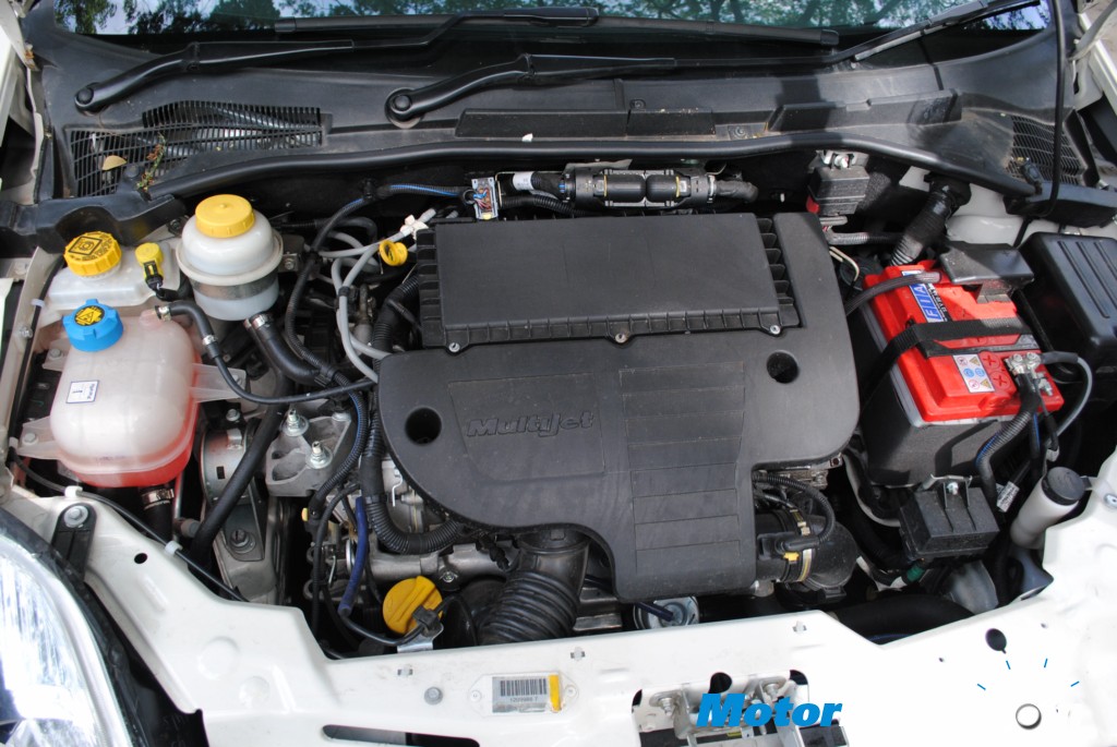

My multijet 1.3 has similar issues, loses power around 2500 rpm. I had a hard time locating the turbo(and wastegate). Can anyone point to/mark the exact location I need to look at, attaching the pictures of the engine bay.
Also, when should be replaced (alternator, power steering etc) ?
Thanks.

I think I got it now, this is shown from under the body. Will try and report back. The punto is fitted with a underbody guard (heavy metal sheet), might have to remove it first.
Thanks a lot Koalar :)

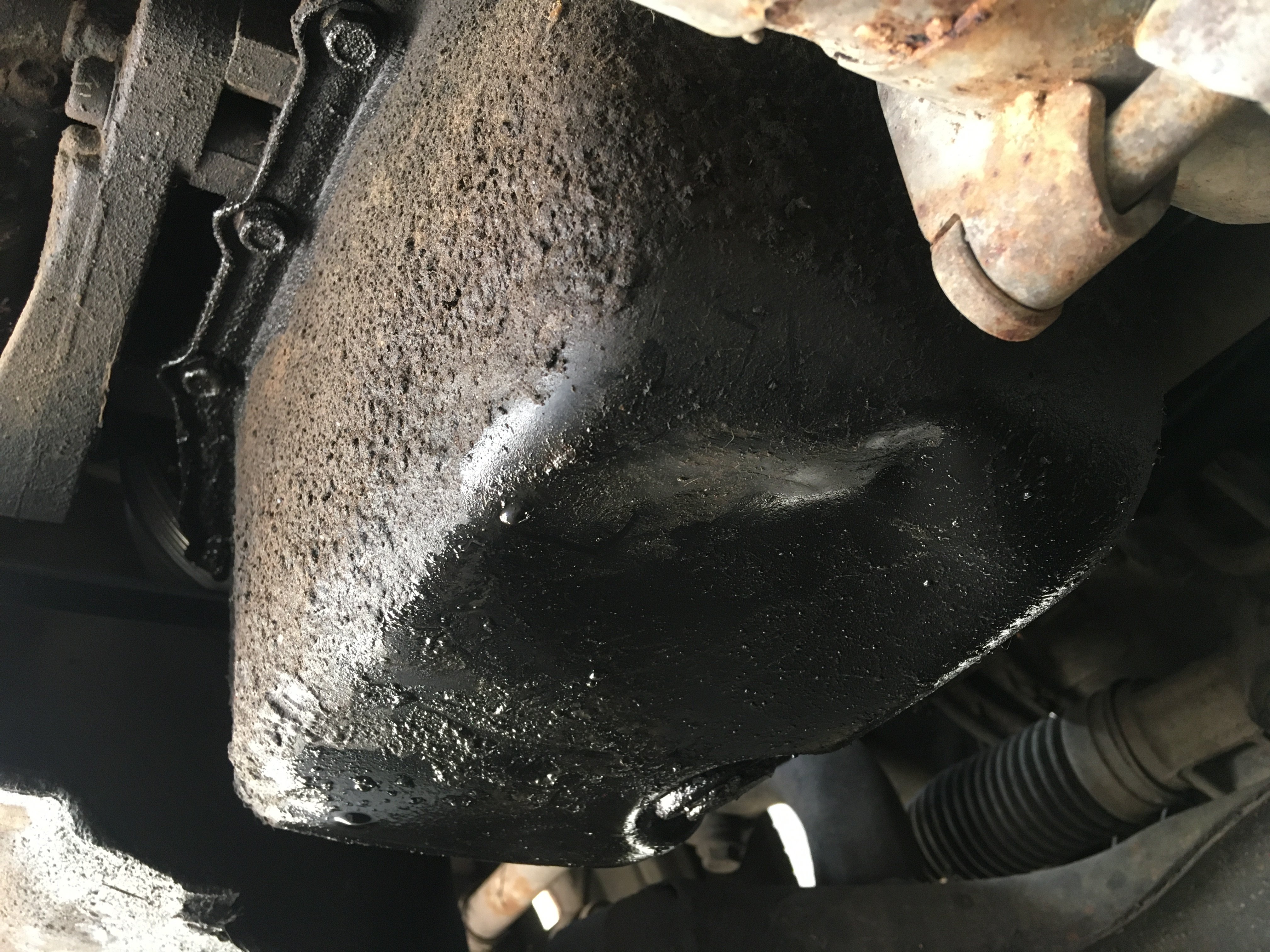

Can you pls take a look at the images below, and confirm if the actuator is located in the highlighted portion. The pictures are taken from under the engine bay, a little bit towards the passenger side. I did remove the air filter box, but unable to locate the turbo/linkage from above.
Off topic to the post, In the process noticed a dent on the oil sump (3rd image). Is this seriousDoes it need to be replaced or can i leave it be?
