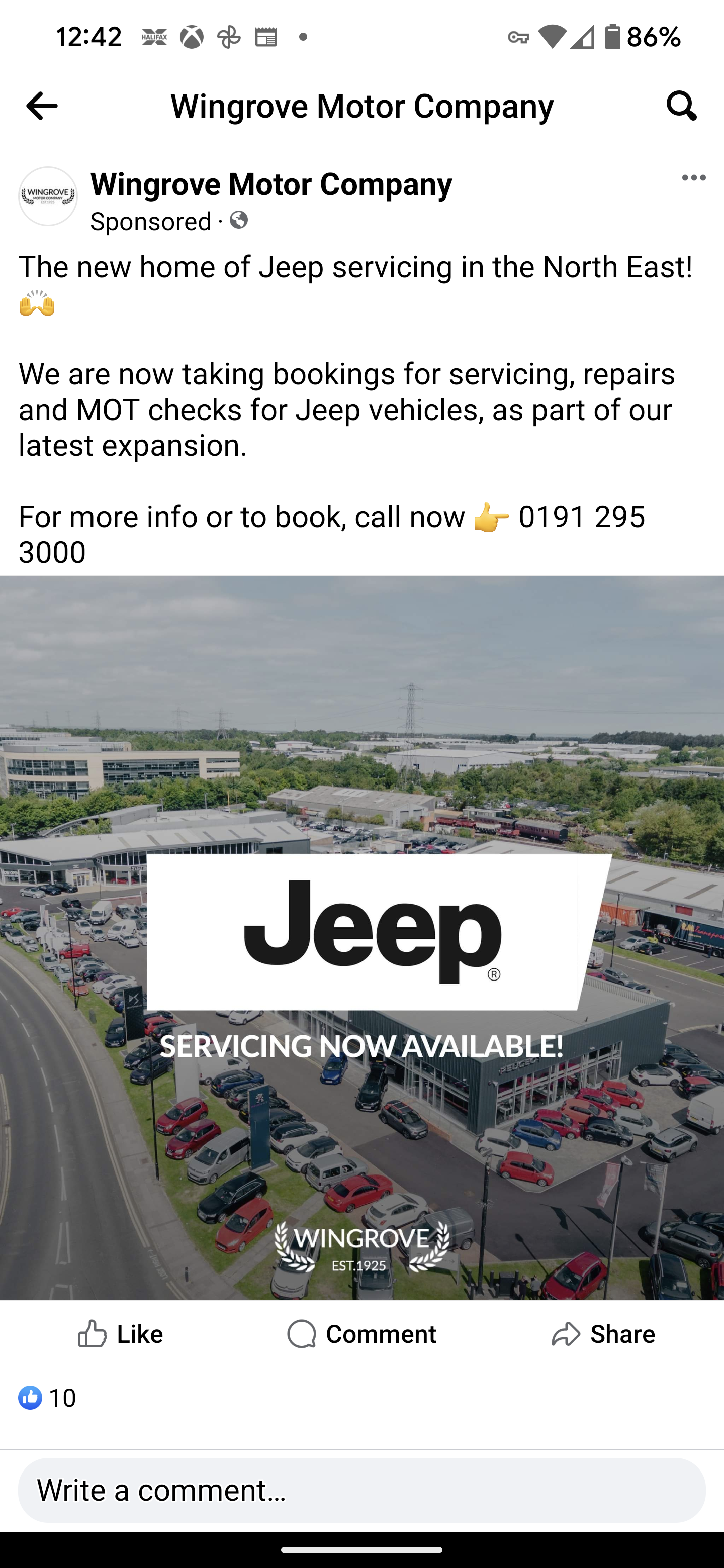

This appeared on my Facebook feed.
For those unaware of Wingrove...it started as a Citroën dealer (it's also where the C3 is from)...it now sells Citroën, Peugeot DS and..
Wonder if I'll be able to buy a Fiat off them shortly...
