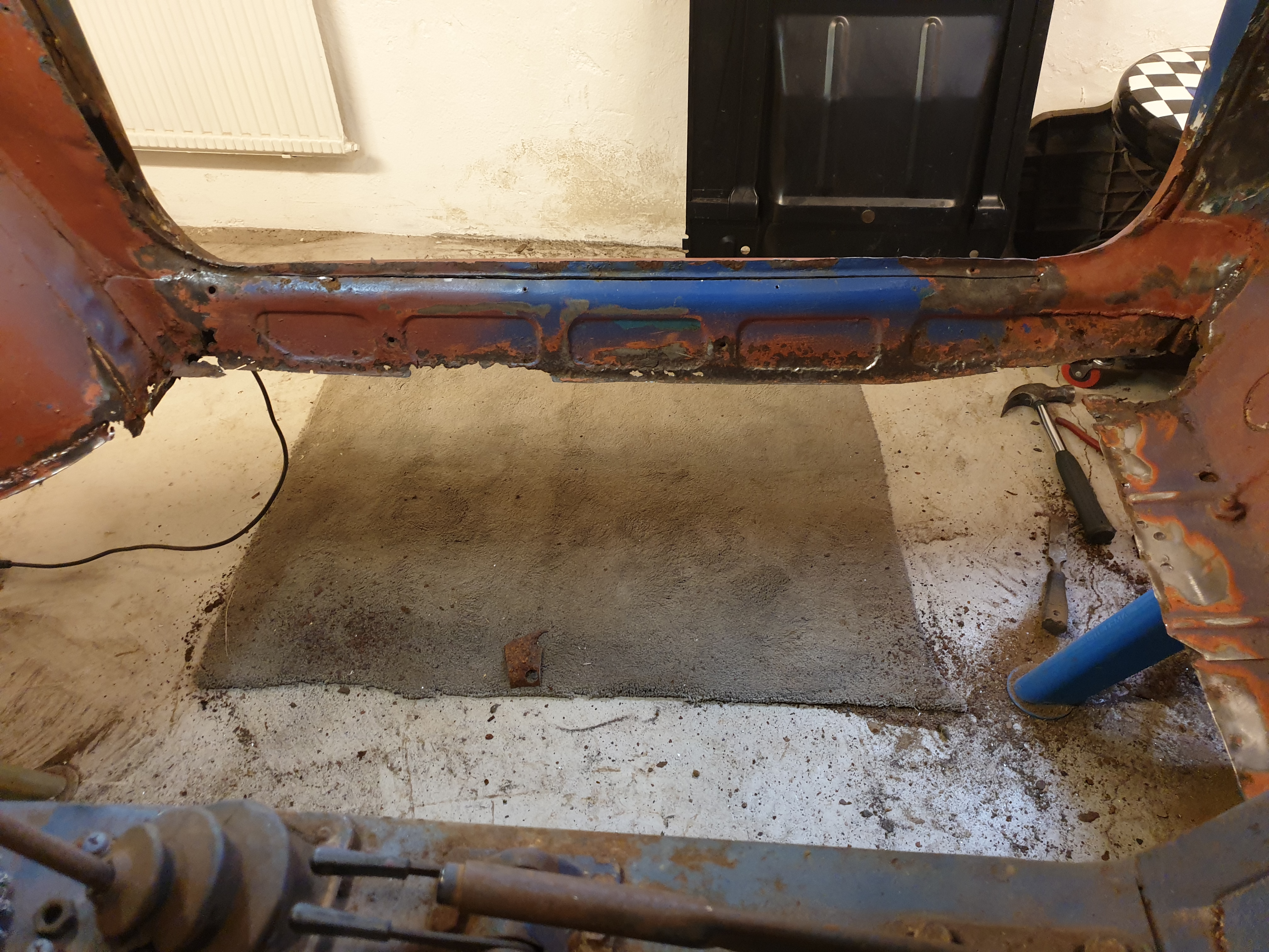

My 500F (my first 500) is in need ofa major restoration/rebuild. I´ve started small, removing doors and interior and cut out the right hand side floor board so far. The rust is far gone :( Some holes, but what is worse is that all the all surrounding sheet metal has serious surface corrosion. So mutch that I fear it´s to thin to be weldable. (Is that a word?) :rolleyes:

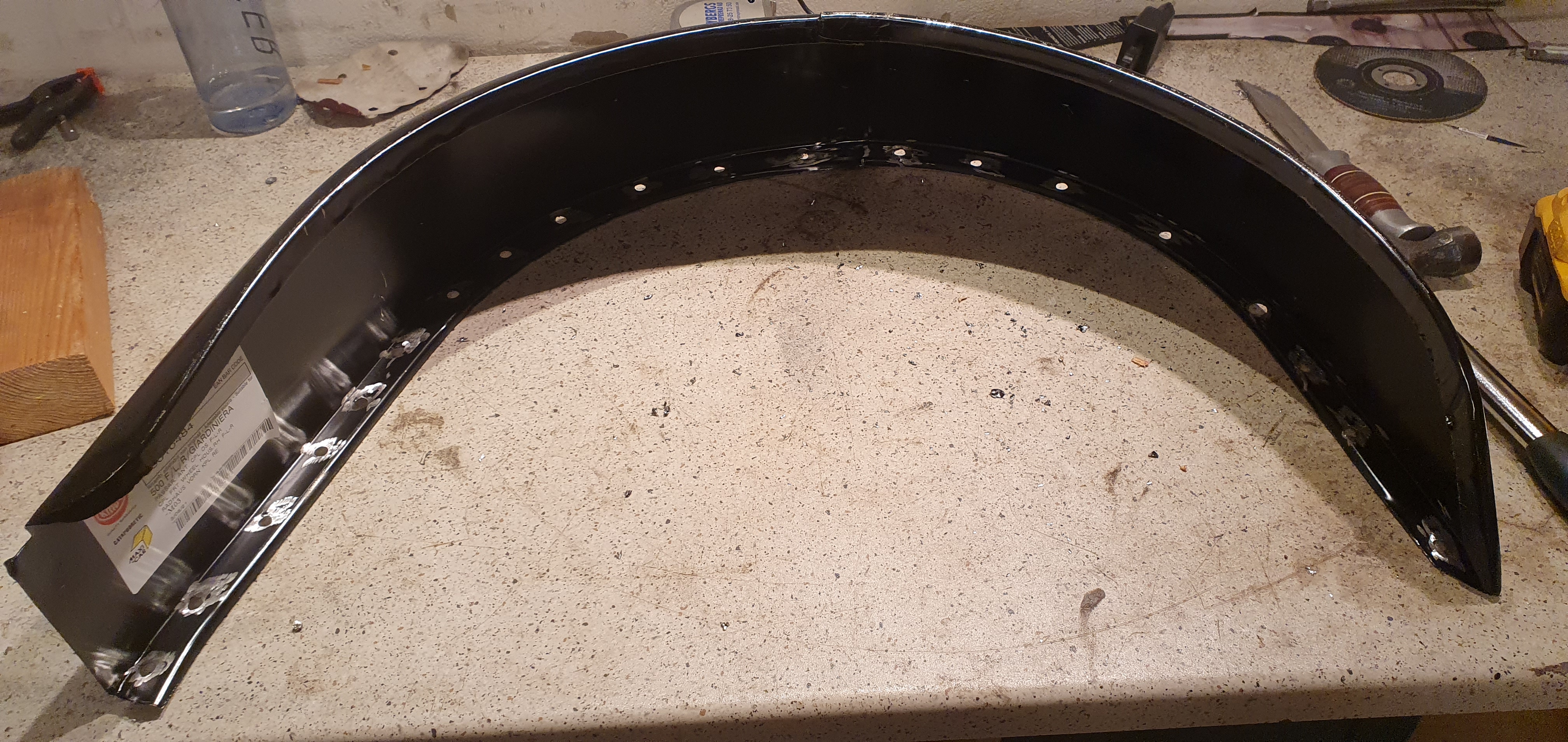

Next inner wheel arc in place. As allways drilling for spot welding.
Hopefully time for the things thas shows soon; front & fenders. But probably the other half of the floor and the sills first.

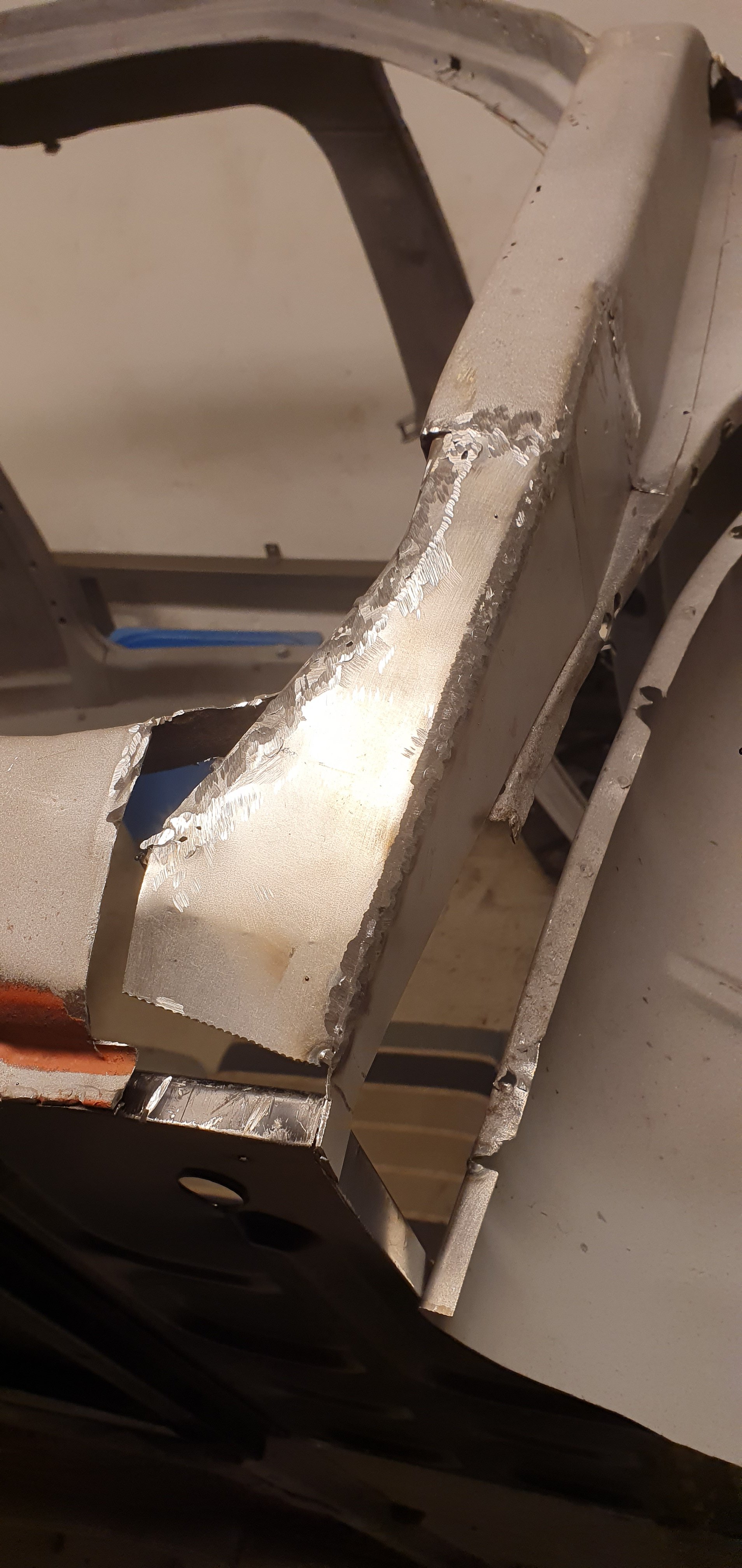

There is so much to do, so I´m just doing stuff, big and small. Concentrating on right front side at the moment. A-pillar and door sill. The metall is like Swiss cheese in many places, so I´ve started replacing some of it, there it is totally rotten.
Some pics for ya´

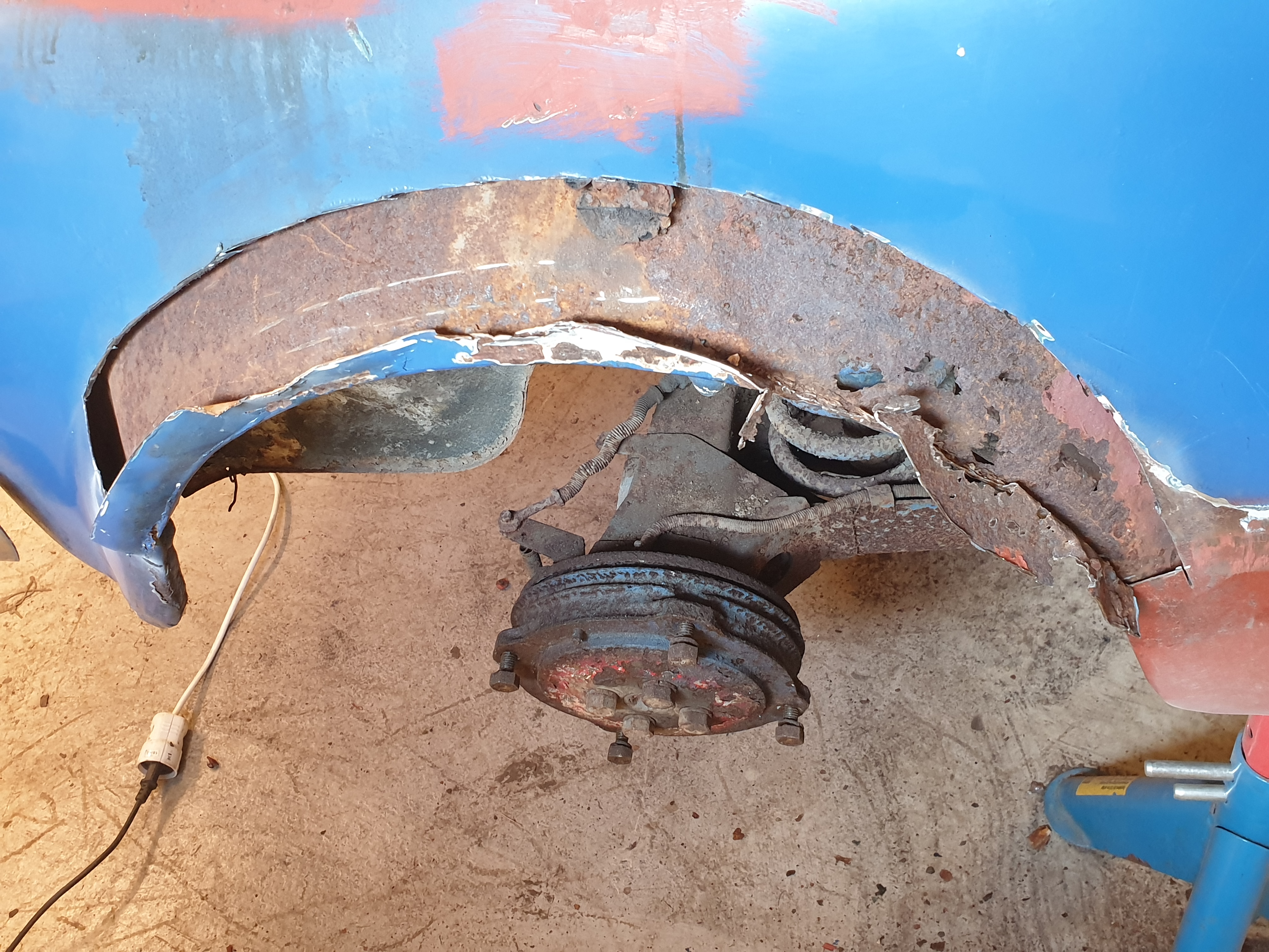

A few pics från sunday´s efforts... the metal is so thin in places, it´s allmost inpossible to weld it.

Awkward little sections there! Looks like you've got some neat repairs though (y)
When you say about the metal being almost too thin to weld too, that's something I've come across many times. Usually it means I should have been braver and cut back more of the original metalwork to get to good solid steel rather than just trying to cut a small section out around the visible hole. Clearly looking at those pictures cutting out larger sections was either not possible or would have lead into a world of problems with complex curves, so I think you made the best compromise there!

Thanks for your comment!
In my case, the thin metal sometimes is a result of the sand blasting, I think. He went bersek in some places and it shows.
But when its possible. cutting out bigger areas helps. Curving surfaces makes it hard sometimes as you say.

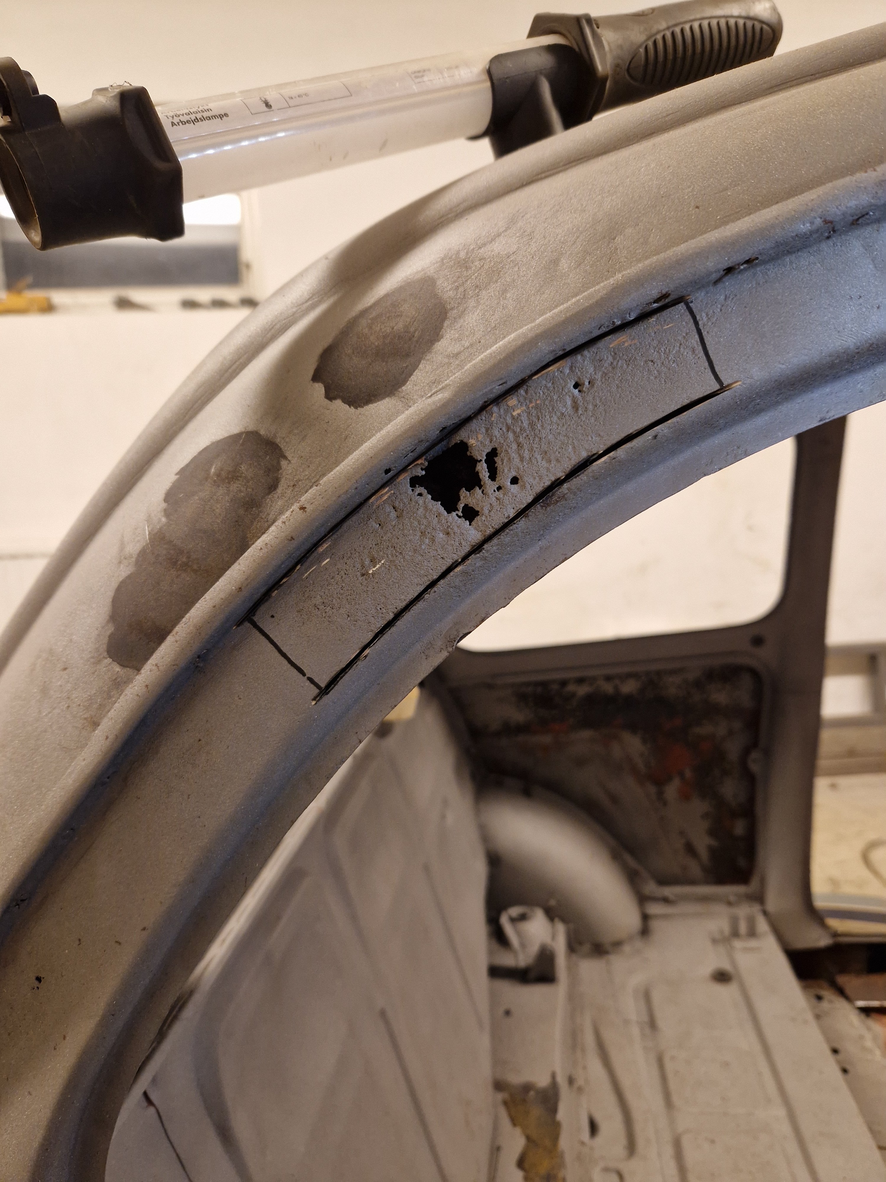

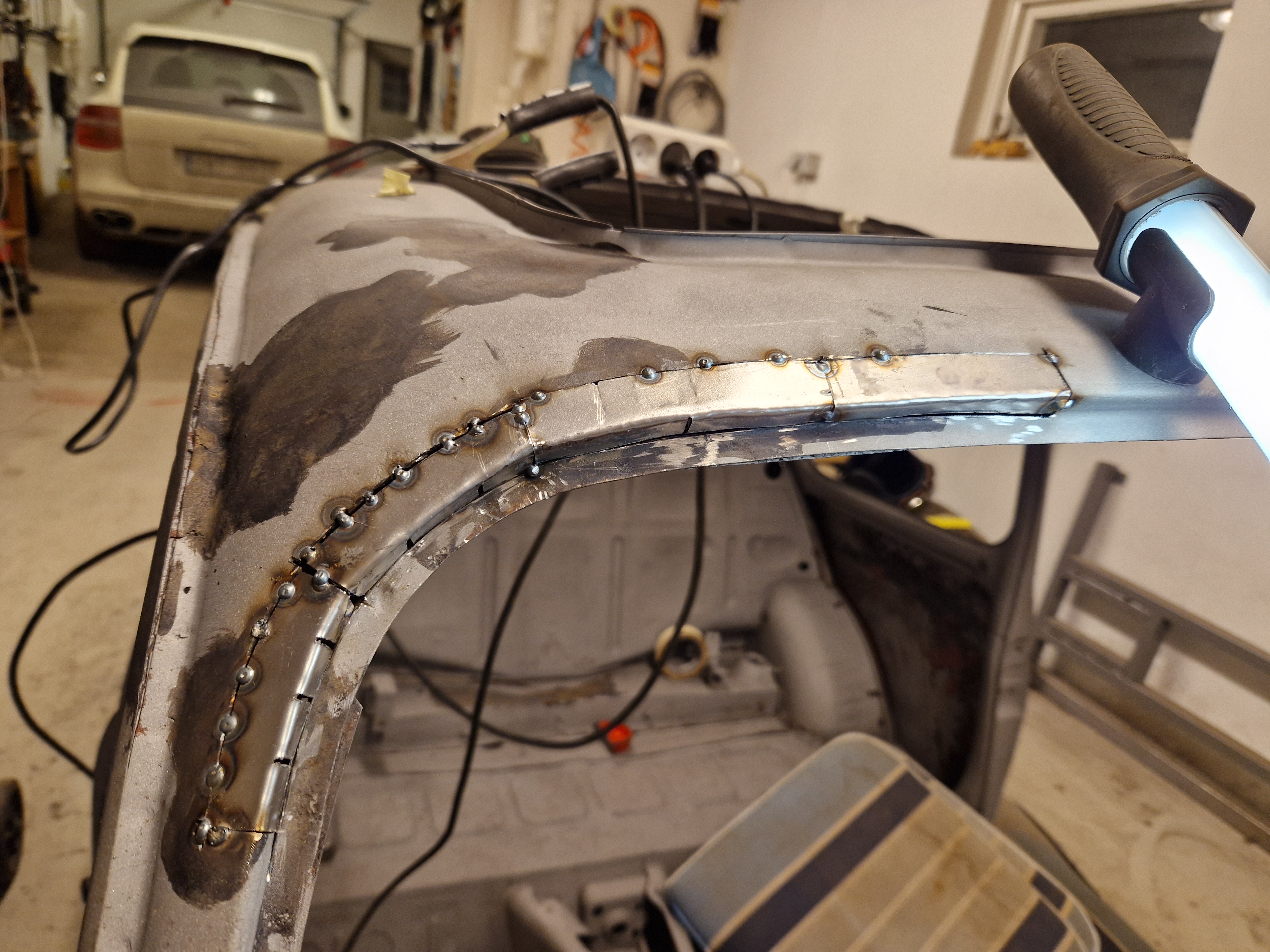

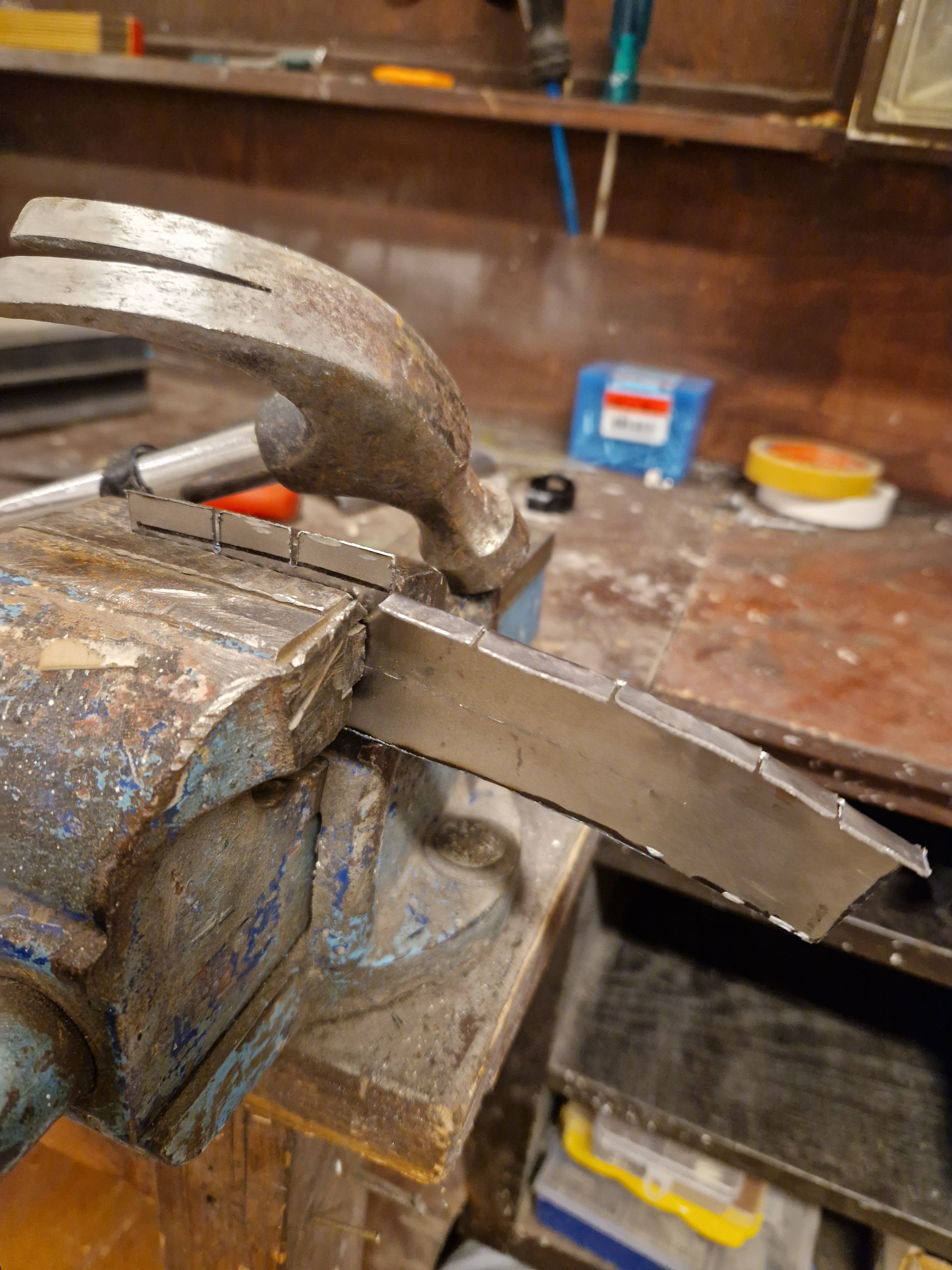

Next "not-so-easy" spot attacked. A bit more complicated than the pervious side, as the rust/thin metal had spreead to the underside of the lip.
In lacking of the proper tools, a hammer and some metal shop memories provided some kind of solution :D
That's a tricky area as I well know. I had the entire drip gutter to replace on one side. Great work.

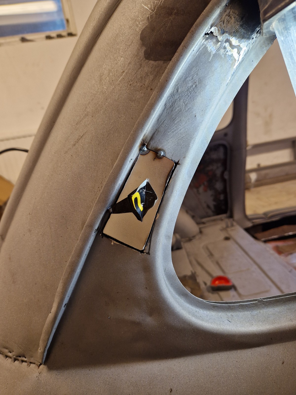

Still waiting for the ordered parts, I continue with the small jobs. (area wise) But it doesn´t feel like small jobbs doing it though 😜
The curvature around the windscreen was tricky to figure out to handle. Lacking all the proper tools, I do what I can with a hammer, anvil and some vice grips :D The fine stuff I will have to do with filler later.
That looks good. I bought a few special tools towards the end of restoration. A shrinker-stretcher was quite useful for things like that and I sold it afterwards and got most of my money back.

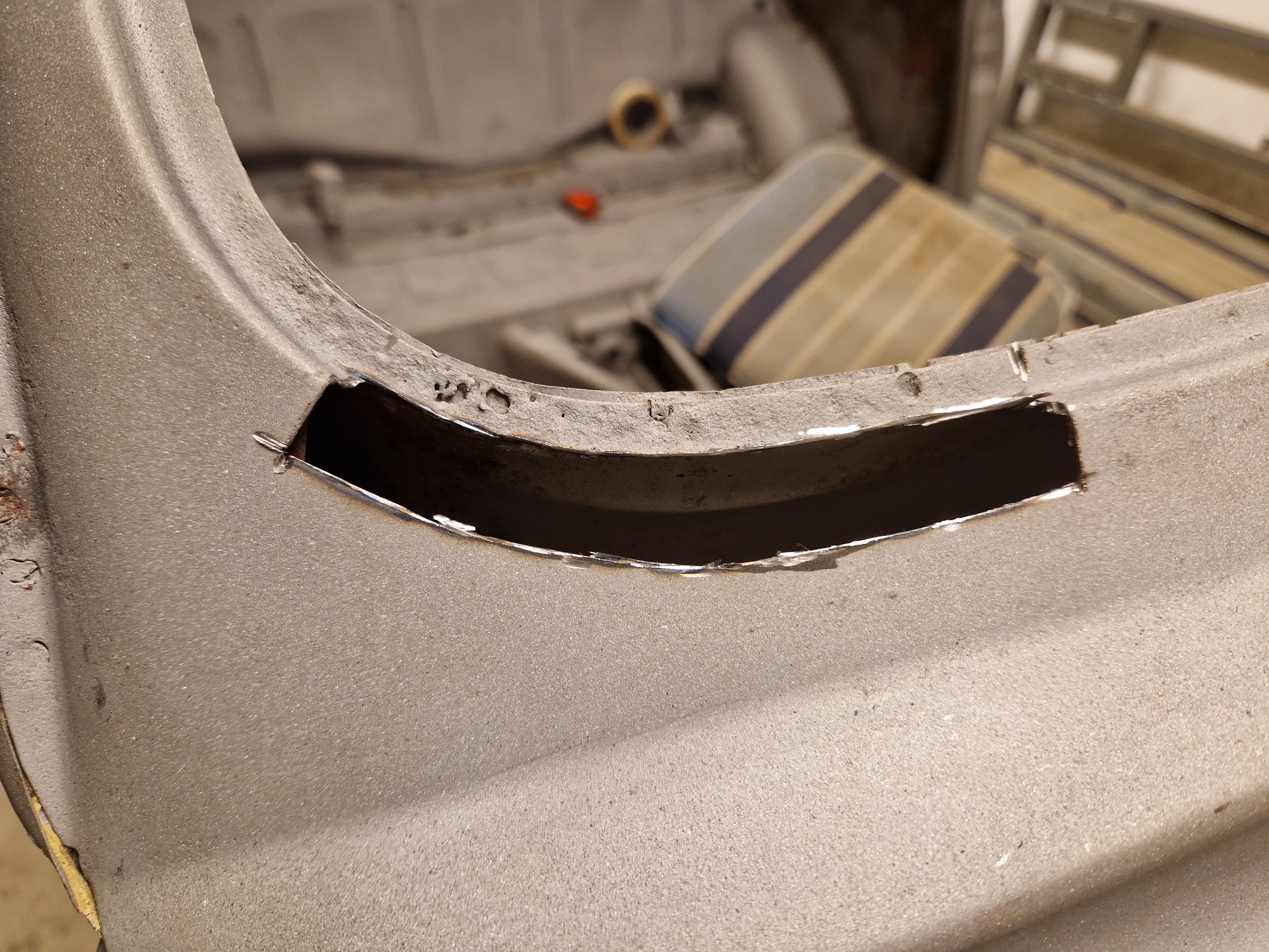

Next problem area... lower wind screen corner. Curves are nice, but not in metal work 😜
For the rear window I´ve ordered the bottom repair panel :D
