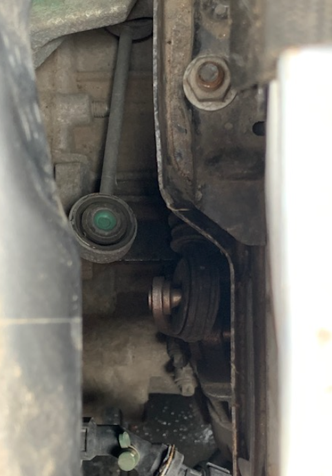

Today the partners 500x engine warning light came on. There is little to no accelaration which makes me think the turbo is gone. Any suggestions appreciated. I have ordered a fault scanner which arrives tomo.
Opening the hood not sure if anything is out of place as per below. Diesel 500x approx 47K miles 2016.
Thanks
Chances are it’s not the turbo gone, sounds to me like it’s picked up on a fault and gone into limp mode to protect the engine. Not had any plooms of smoke have you? As long as the code reader you’ve ordered is up to the job it should put you right

Got to the bottom of this apparantly common problem. Pressure sensor was replaced- it sits at the back of the engine and is quite difficult to get to for a 500X - costs £16. Problem solved- hopefilly for good.
Spoke too soon- issue back- engine waring light on, same fault code as before- engine in limp mode. Anyone have any ideas?
