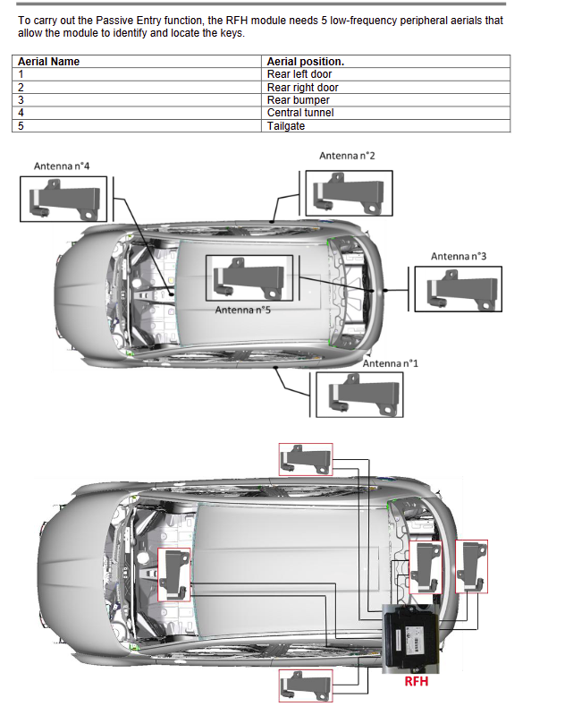

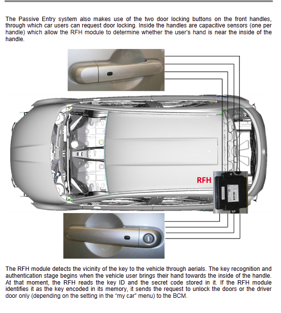

Out of general Interest for 500X owners with a more tecnical bias :) It often helps to now how a system works and where the major compoents are even if you are not able to work on the system yourself. Least when a garage/dealer starts rambling on you know what they are talking about, or even if they know what they are talking about!

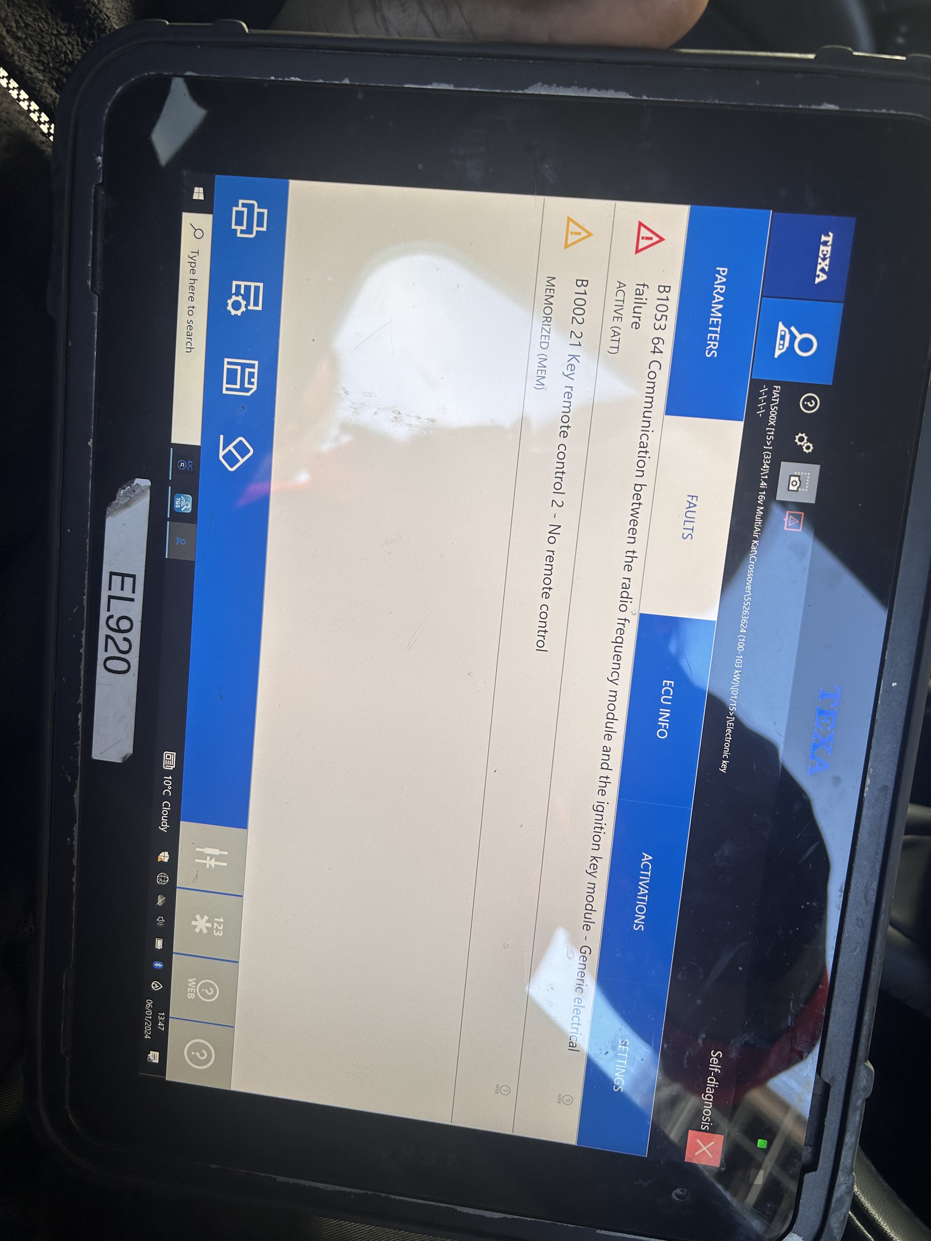

Hi,
Have you managed to find any solutions? I am having the same problem.
The message won’t go away but everything seems to be working fine.

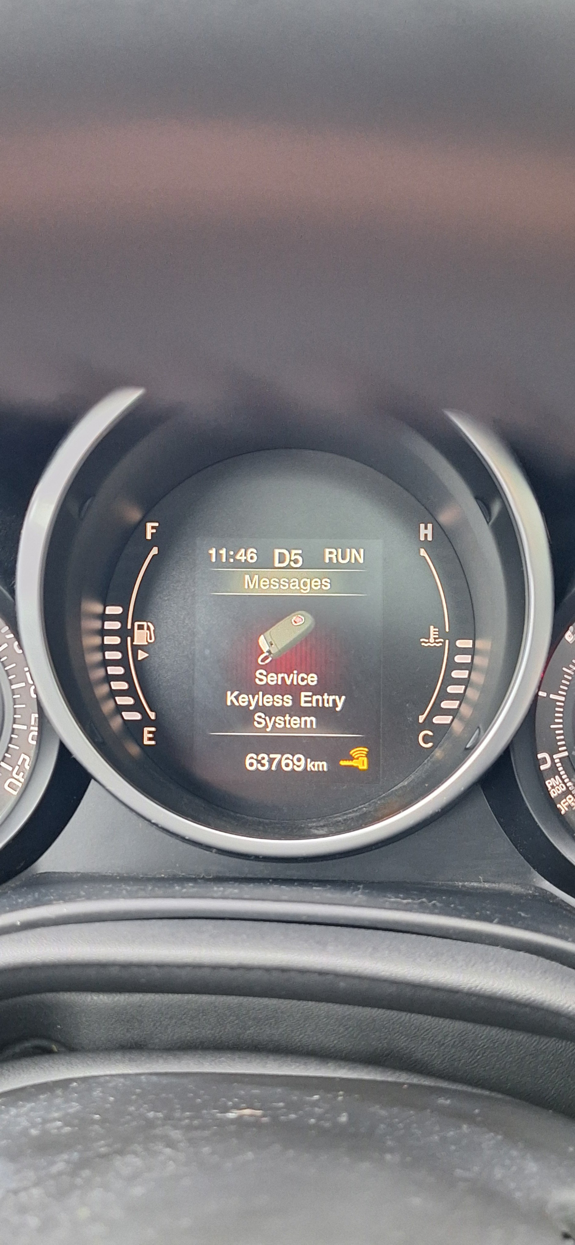

Had a test run and the error code has come up but I’ve tried one garage they didn’t understand what it meant.
This is way above my head, but I learned something I think. Thank you!

My FIAT service centre in Vancouver, Canada replaced the RFHub radio frequency hub module. The shop discovered water leaking into the RFhub which caused the malfunction. I understand the RFhub is located on the driver's rear quarter panel of the vehicle. they also replaced the passive entry module. They repaired the water leak. Everything now works correctly but after spending almost $1,000 Canadian. They also had to reprogram the two keys.
