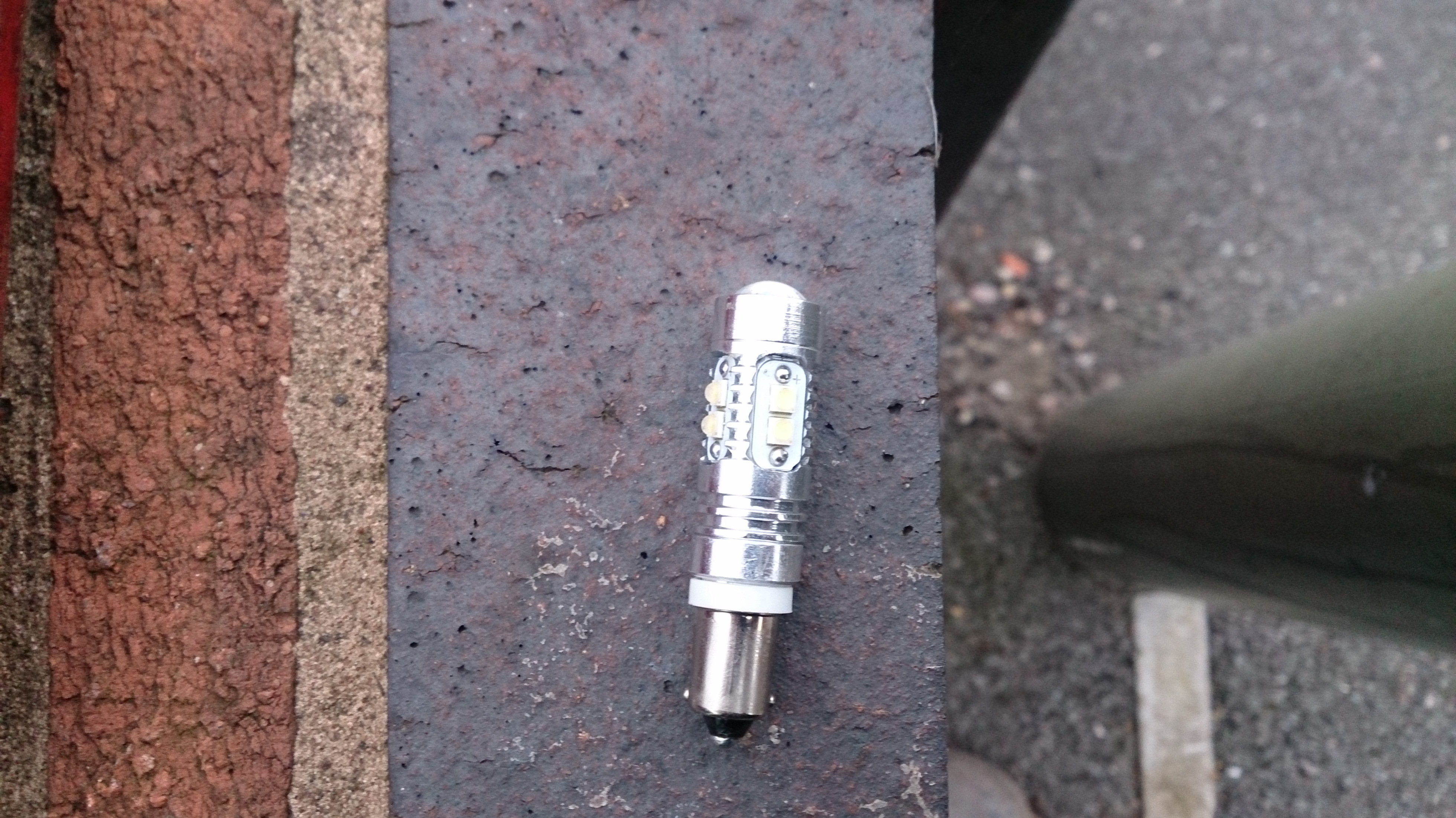

have some nice LED side lights now. the old bulbs had gone rusty in the holders.
i had to take the headlamp out, put the bulb inside the headlamp and get it so the base of the bulb sits through the hole then wedge it in place and put the base cap on

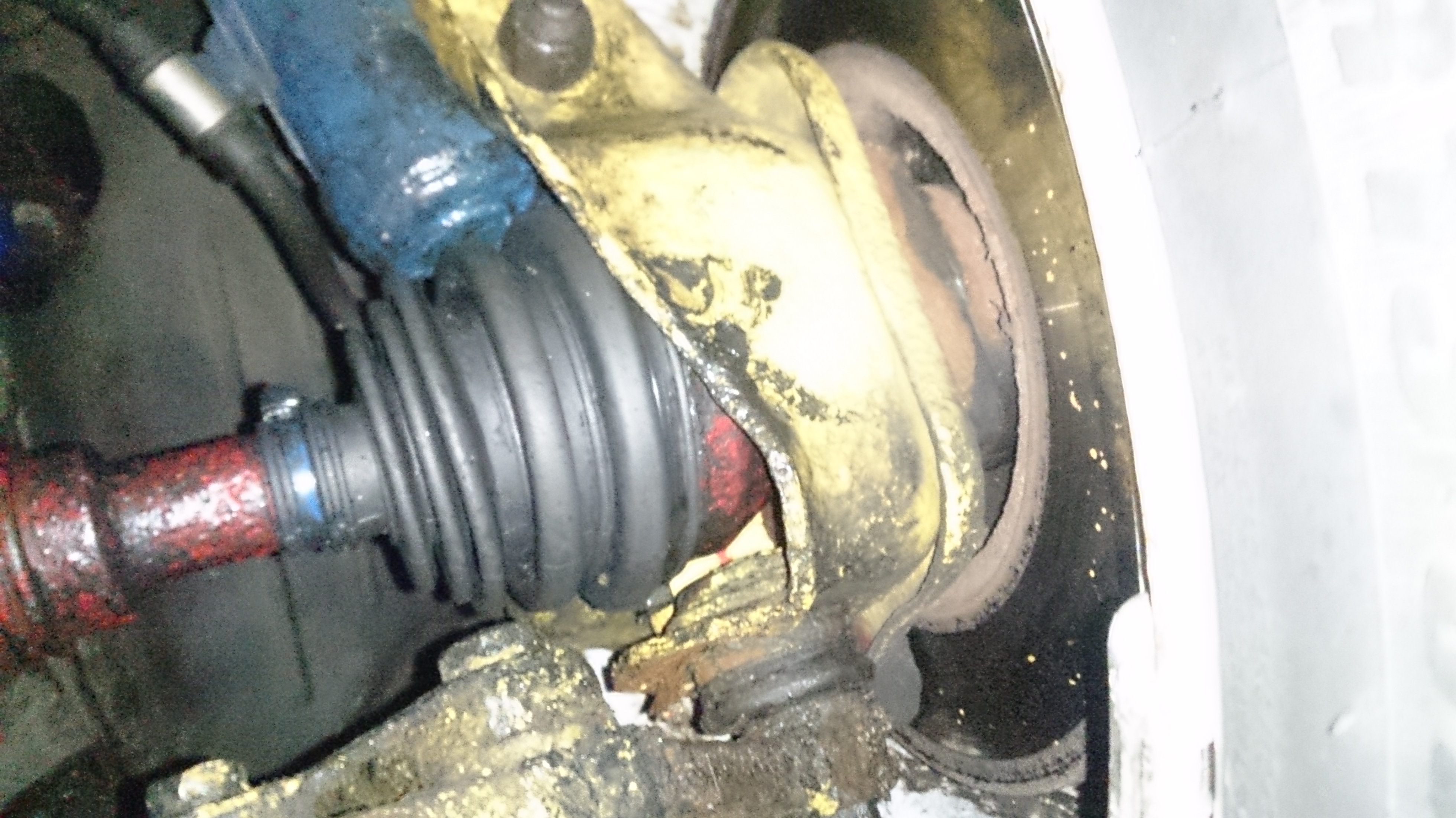

Another day, another CV boot. this time hammering was involved to the bottom of the strut.. and yeah it has dented it in quite a bit. (i really did not want to grind any off it)
rage strength worked well and now the CV boot is not close to the strut bottom :D
there was still loads of grease inside the CV joint so i did not add any extra. the hole was only a pin hole so nothing got into the joint :D
just a cheap universal boot sadly, however!!!!
i did find out that a Nissan Micra (2004) outter CV boot fits the panda perfectly! and is WAY WAY lower profile than a proper panda CV boot. the only reason why i did not use the boot was because it was an old one from a nissan micra gearbox change i did on a friends car.
if this cheap boot rubs, it will be the boot i will use as a replacement.
i never took any pictures of it fitted Ahhhh but i did fit it and you have my word that it fits snug with no gaps :D(y):slayer:
i have a panda CV cup somewhere.. ill stick it on that and show you guys.
ahh so, i have taken a picture of the 02 plate Micra CV boot fits on the panda CV cup. as you can see, it is much much more lower profile than the standard CV boot.. oh damn its not standard.. best tell my insurance...:rolleyes::rolleyes::rolleyes:
and here is the CV boot on Talon, about 130 miles later:
looks all good with no signs of rubbing!

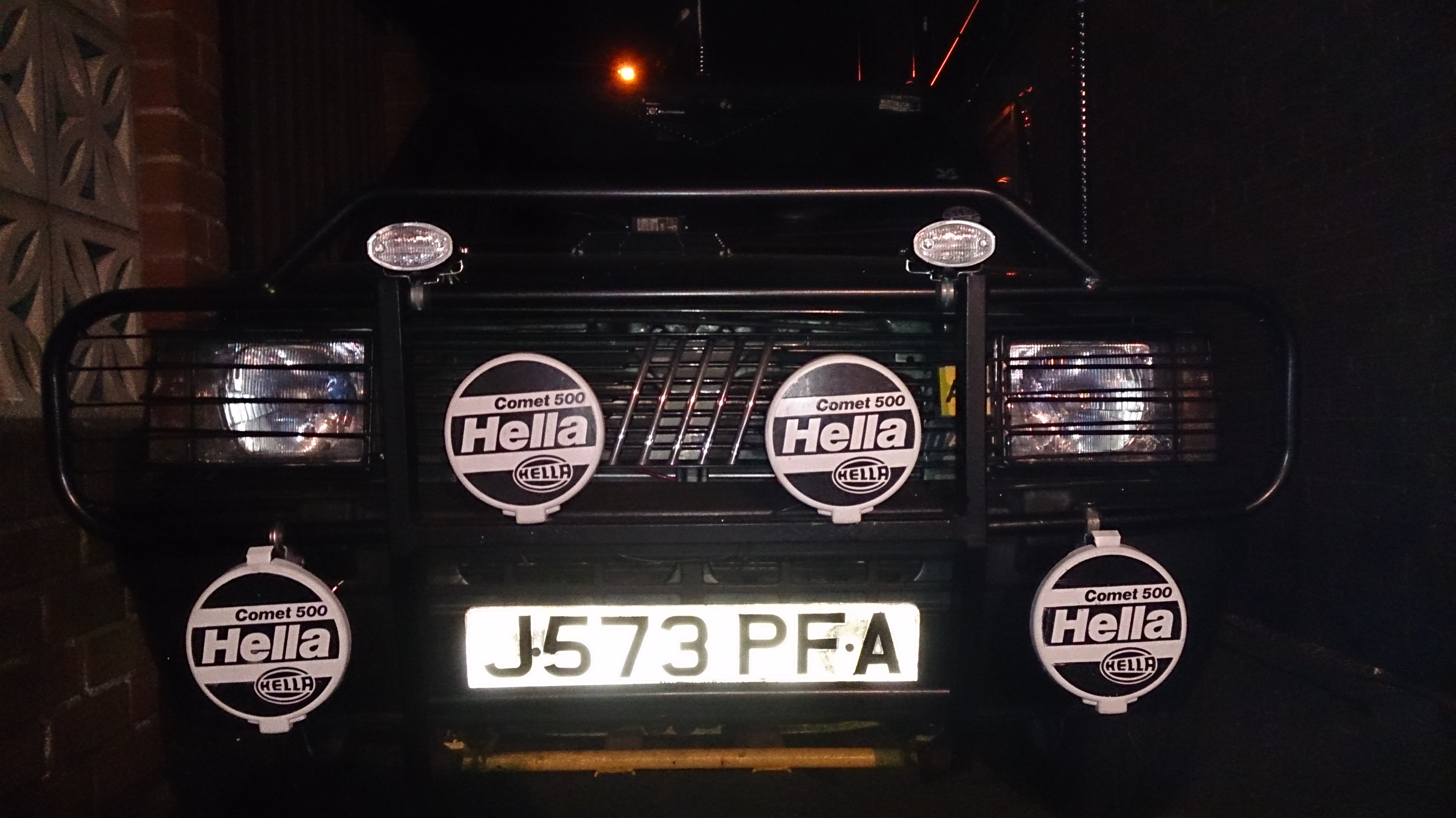

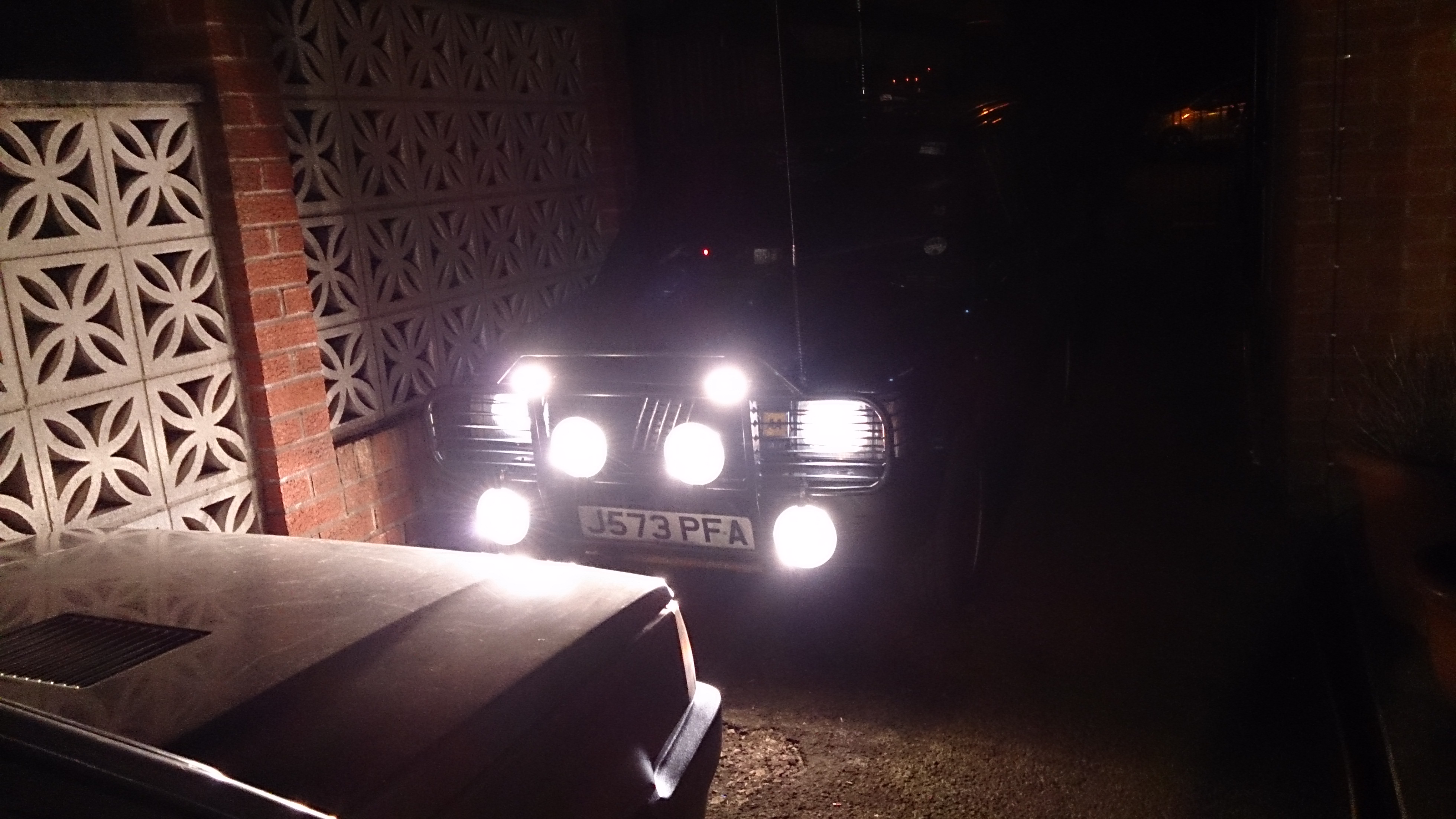

i dont think Talon has enough light output..
see.. just not enough..
so, you see where the top 2 small lights are (fog lights, which is what they actually are), i am planning on removing them and putting them elsewhere, maybe on the outer side of the bar that the 2 bottom spot lights are attached to..
that would make a nice large gap..
a gap that will be a perfect size for.. well to put it lightly, a 23 inch LED light bar.

all this hype on LED spot/flood bars.. well i guess it was time to "shed some light" on the subject and actually try one of these things out..
if i swapped all of the 55 watt halogens for 85 watt HID's i would be at about 750 odd watts...
should i make 1Kw light output a challenge?:idea::devil:
You'd probably want to seriously upgrade the electrical system with a much bigger alternator and split charging...... 1kW is going to be something like 86A
Do that anyway ;)
Do that anyway ;)
yep i have already got both! theres a 115A leisure battery in the boot and the alternator is rated at 95 amps. only issue i have now is that the single V belt really struggles. i need to use a multi V belt. its as simple as just swapping the pulleys around though.. i do have them somewhere its just being arsed with all this rain and cold >_<
