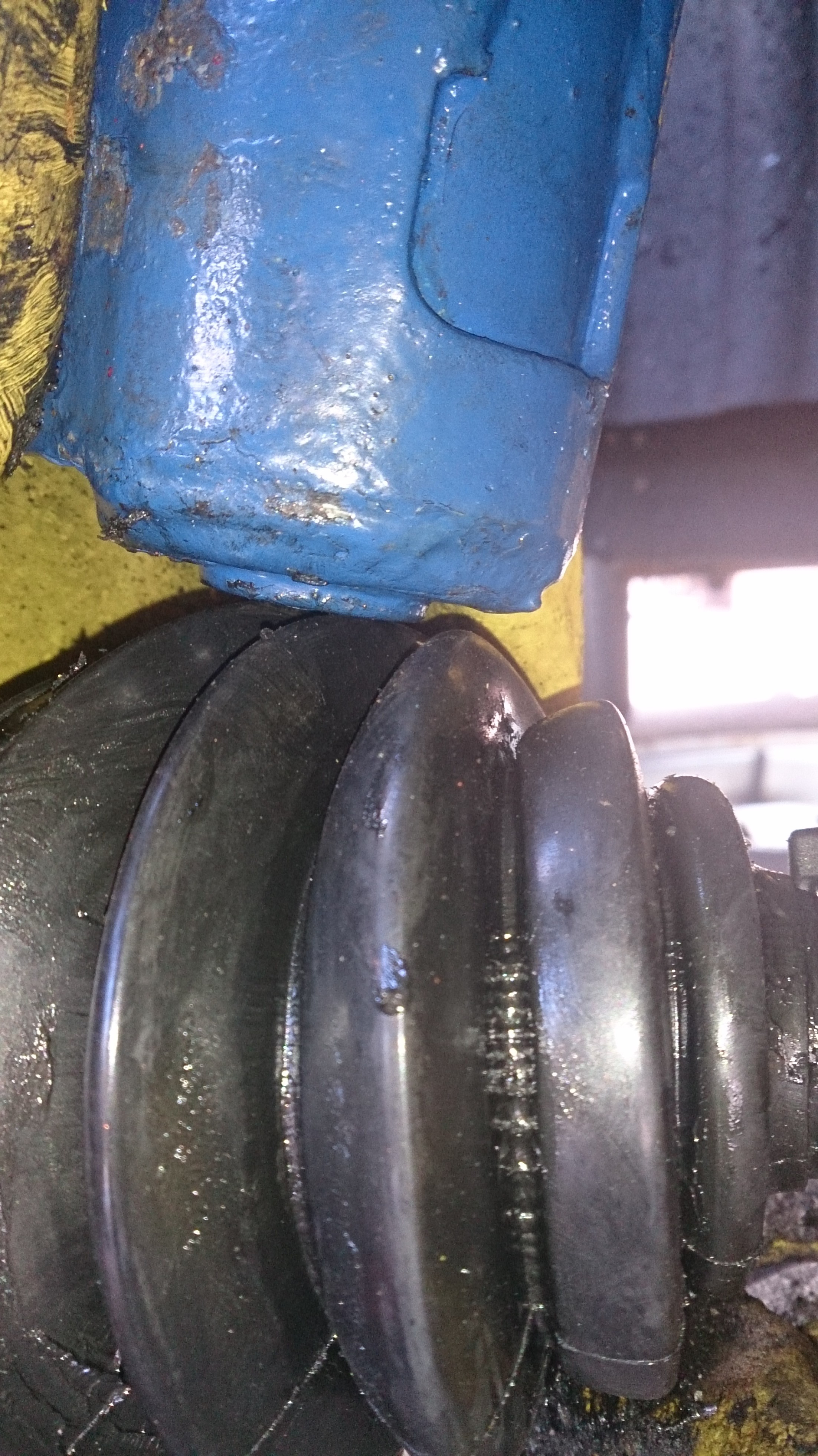

hmm talon needs yet another drivers side outer CV boot.. i wish i could figure out why it rubs on everything. i have tried them in all positions but they always rub and ware through.
this is its 5th CV boot... one "universal", 3 lucas, and one which cost me a fortune direct from fiat. every one rubs and eventually spills all the grease all over everything.
i think its going to be one of those things where i will worry about hiding it come the MOT and just leave it. sadly i see no way of fixing the problem.
any such thing as a low profile CV boot?
A temporary "fix" until you work out what if causing it could maybe be to fit a cheap universal boot over an official one (basically reinforcing it)?
If nothing else it would buy you more time until it leaked because whatever was wearing it down has more rubber it needs to get through.
i dont think theres any crash damage.. i did have to replace the strut on that side but i did replace it with one from bex that was quite new. it was a 4x4 strut i replaced it with.
i was thinking of just filing the holes bigger and sliding the whole strut up.
talon needs 2 new front struts but they are super rare to find and i just cant afford them.
never messed with a 4x4 panda but generally speaking front shocks are bolted to the spindle (or some mount that attaches to the spindle) making it a fixed point and the driveshaft goes through the bearing in the spindle. This makes all these things fixed in relation to each other..... So this to me can only mean the mount on the bottom of the shock (or mount that sits between the shock and spindle) is either bent or wrong or the shock is somehow damaged or not the right one.. Spindles generally being cast won't bend, they would snap so unless the spindle is the wrong type i doubt its the spindle itself. Have you had both struts off and next to each other to compare them before???
This is all conjecture being that i don't really know the setup but hope that makes sense.
I must admit I have noticed a lot of 4x4s shocks/struts are different at that point on the base of them. When I replaced both of mine it originally had one gas strut and one oil strut on the front - they were both different on the base of them.
With my suspension being lifted I have to use the universal "cut-to-fit" CV boots, and cut them down quite far to clear this issue (as the angle on my shafts is greater than standard) maybe give those a try John?
If you buy new front shocks for the 4x4 they come with the strut new anyway, they don't come as in insert. They're about £60 a pair and involve changing the top bearing and coil spring over from your old ones before bolting them in place.
As far as I remember there is "one finger" gap between boot and suspension components in my 4x4. Something is bent or shock absober does not meet OE fiat standard sizes. Quick repair is one mnute job with a grinder and a grinding disc to the base of the shock IMHO;)
I've been through a few different shocks and boots on the front of Grumbleweed and had the same issue a few times, just some boots that are bulkier and some shocks a slightly different shape at the base. Not much clearance as standard so doesn't take much to upset it.

as far as i can see nothing is bent.. the CV boots have all been fiat ones.
i had it all apart again today to see if i could fix it, but i dont think i can.
i am looking to get new dampeners for the front, and also will be adding the Felicia springs. this means that i will have to alter the camber.. while i am doing that i think i will drill the holes out a bit and make it so the gap will be bigger.
its a pain because its preventing me from doing any long distance travel. even after a quick drive around the estate, all the grease has come out and anything metal is bone dry again :/
im thinking of swaping the whole arm over with fallouts.. i just wish it could hold on just a few more months.. then i will have fallout road going.

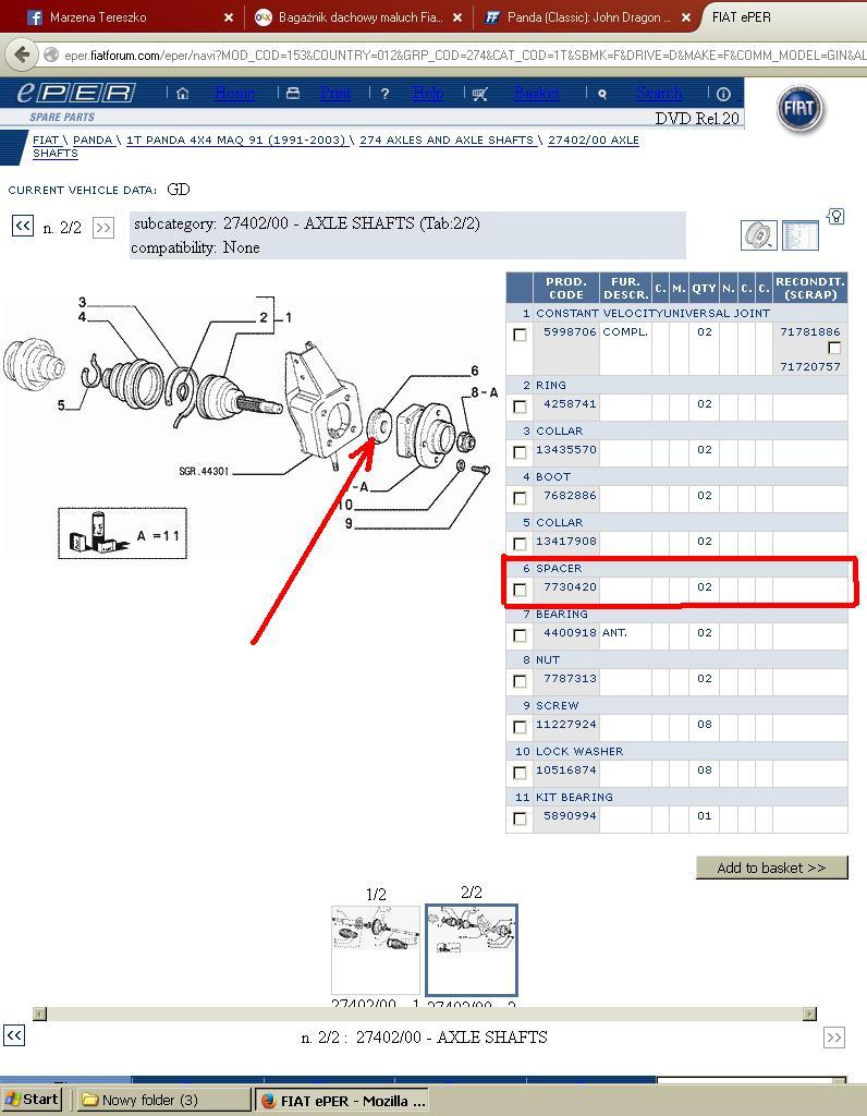

Thinking about your CV boots problem John, is the part number 6 , the spacer present on talon? I think it is still possible to fasten the big cv nut without this spacer, and it moves the cv 1 cm deeper= boot closer to the susp. components. It is easy to forget about this part when you disassemble the whole front susp like you did some time ago with talons.
PS: I used this spacers in my 127 mk1 with swapped 1.0 fire engine and box from y10, I also used shafts from y10 on 127 mk1 and to "make them longer" I used this panda spacers to push the driveshafts towards the gearbox by 1cm.
