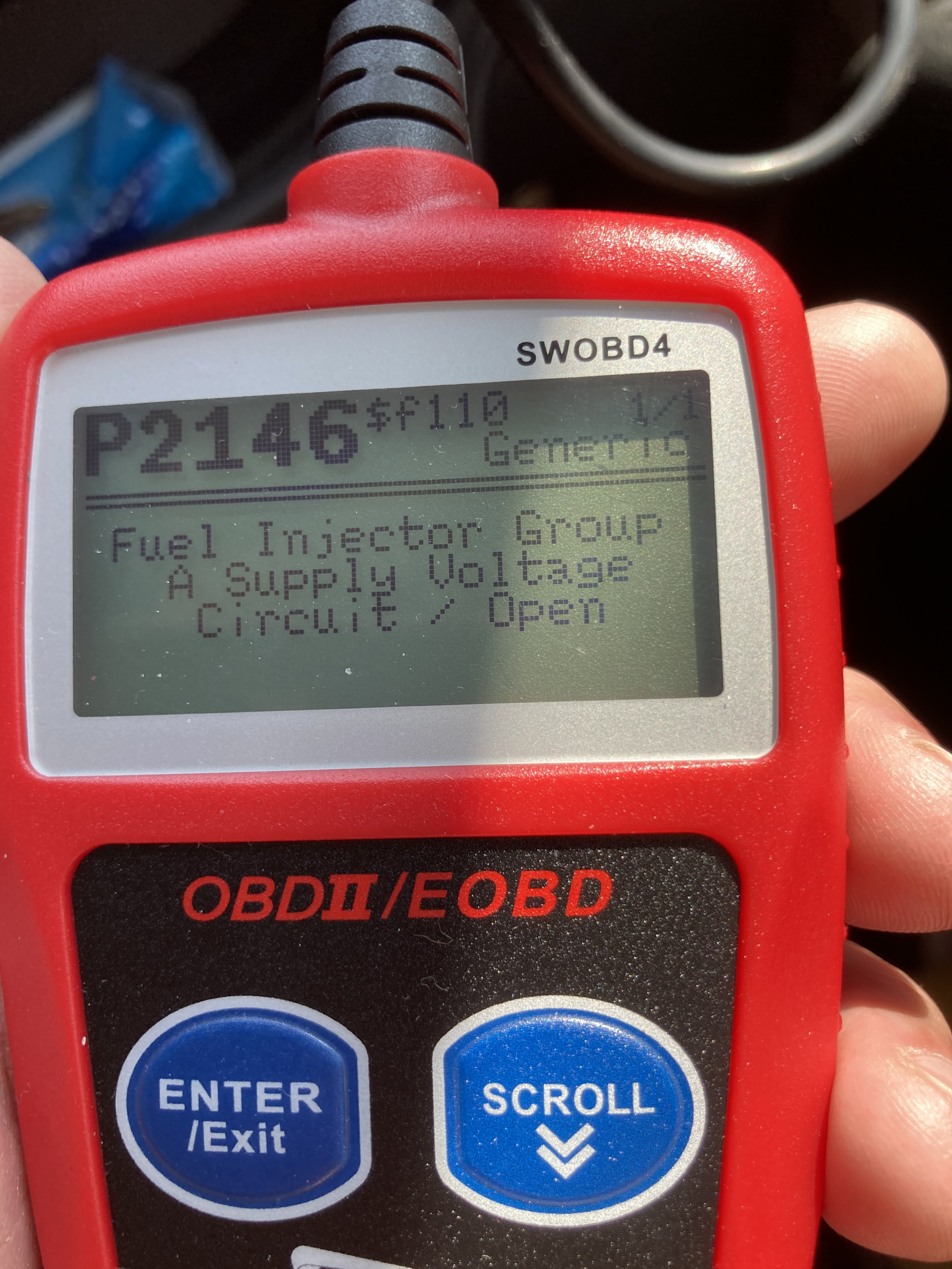

We are just on our way to catch the 11pm ferry from Newhaven to Dieppe and our engine management light comes on again and the van goes into limp mode!
It did the same last Sunday so we had it into a Fiat Dealer in Portsmouth and they couldn’t fault it!
The code the ODB reader shows is P2146-12 which is something to do with the power supply to the injectors!
We have accepted that our trip to France is off the cards so now we have to make our way back up North and try and get it fixed! We have used our own OBD reader to turn off the warning light but the van definitely isn’t as powerful as normal. I’m convinced it will come on again soon.

The Fiat Professional garage informed us of a code relating to the oil level sensor and a code relating to a steering sensor. They told us not to worry about either of them! The problematic code is the p2146-12 which re appeared about 70 miles after our visit to the dealer.
I managed to contact an auto electrician over the weekend who came out and had a look at it. He doesn’t think it’s electrical and from some of his diagnostic checks he thinks the problem lies on injector 1or 2 (or both).He did a check looking at fuel flows, 3 and 4 were almost the same but 1 and 2 had variations in their readings. It’s possible injector 1 or 2 may have debris or some other matter that causes irregular misting fuction of the injector.

The main error code that is the problematic one is the P2146-12.
Hi Jim
This is the reply I posted about 6 months ago to someone with a similar issue:
The P2146 indicates a problem with the power supply to all injectors
The /12 "symptom identifier" suffix means a short to B+ (System Supply Voltage).
However, fault codes are only ever a guide, and I don't have information on the exact meaning that Fiat have allocated to this code.
If you have checked out the injectors, the injector to ECU wiring (2 wires per injector) and the ECU itself, there remains the possibility that the ECU is being starved of sufficient 12 volt power. This could be something as simple as a corroded/tarnished fuse or fuseholder. Earlier Ducatos had two or three separate fuses for the ECU, but unfortunately I don't have detailed information for the later models.
I suggest you or your vehicle electrician take a look at the supply voltage(s) at the ECU under running conditions.
I can't help feeling that if the problem has come on suddenly that it is more likely to be a wiring/electrical issue than something that comes on gradually like wear in the injectors. I would want to be absolutely confident that the supplies to the ECU and the wiring from ECU to injectors were above reproach before testing and changing injectors. If your electrical technician hasn't hooked up an oscilloscope to the injectors by now, you need to find someone else who can do this.

A quick update…. The engine light came on again on Monday as we were leaving Portsmouth. We drove the van directly to Adam Morey and they diagnosed a faulty ECU. The part was ordered and fitted on Wednesday am.
We have driven about 60 miles to our next campsite and everything seems fine.
I am keeping my fingers crossed and hopefully the new ECU fixes the issue.
