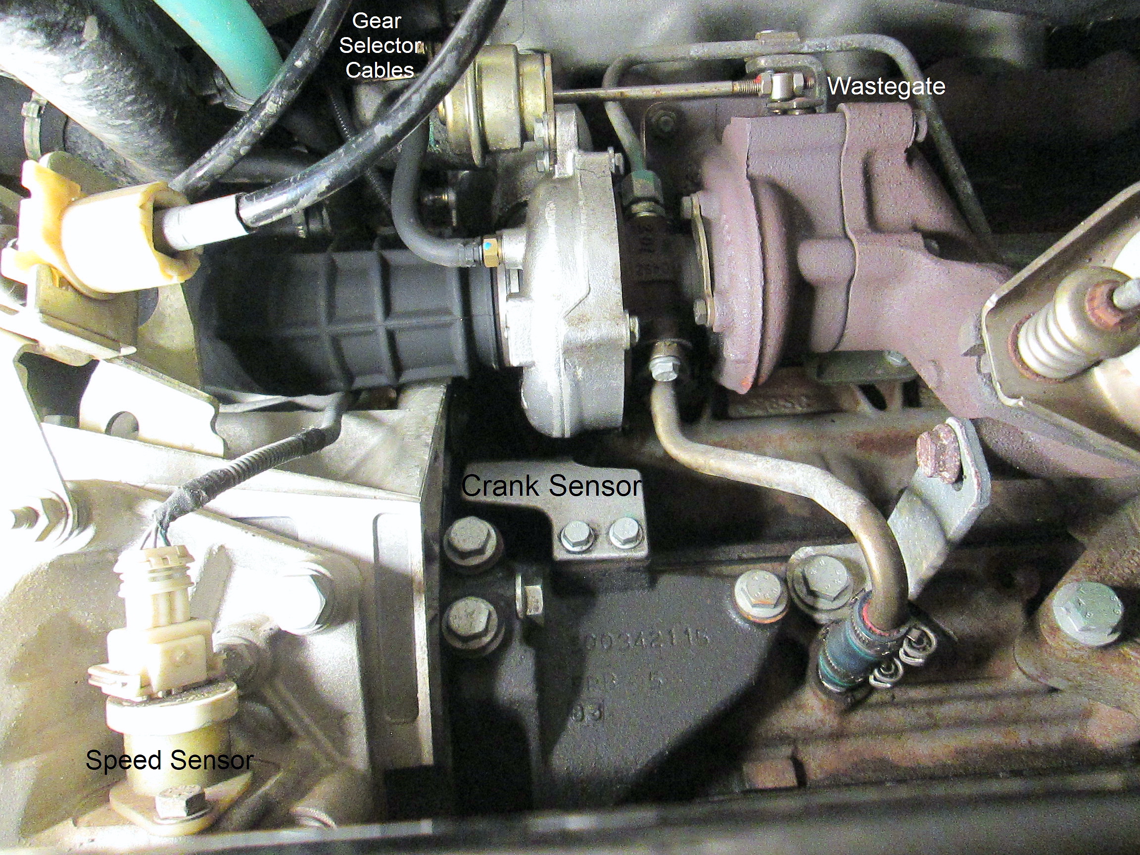

2. Speed sensor can fail, but I have no memory of high readings being mentioned. See recent thread https://www.fiatforum.com/threads/gearbox-impulse-generator-2004-fiat-ducato.506631/, on which I posted photo of speed sensor.
One other possibility is the support of the cable form to the tank, close to the left front wheel. See attached pictures, sensors are for 2.8jtd.
