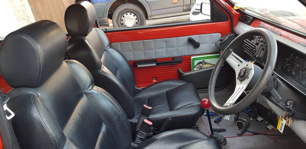

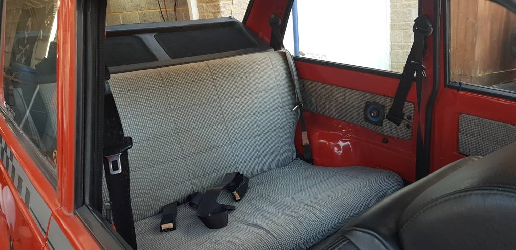

So spent few hours putting bits and bobs back together, mainly interior bits.
Put the dash all back together, mounted my glitter ball gear knob, bolted down the coupe seats, put the rear bench back in, refitted steering wheel, some plastic trim pieces, took the front speakers out and tidied up a rat's nest of wires, mostly for the stereo that's not there. All little things but needs doing and takes miles longer than you expect it to.
The novelty of driving it out the garage to work on it and then driving it back in felt good though.

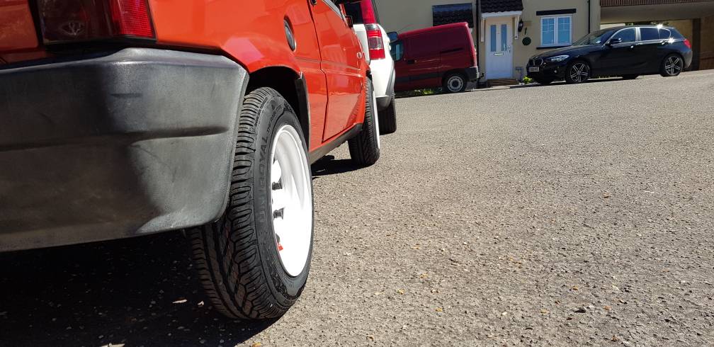

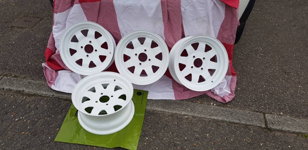

So the fact the tyres on the car are different size front to back has been annoying me from day one. Added to that, the fact the 2 rears are old, cracked and both no longer hold air for more than few days I started looking at tyres online. Which led to me finding a local company that makes custom steel and alloy wheels, mainly for big industrial equipment but also wheels for movie cars. Side note, they made the wheels for FAB1 in the Thunderbirds film.
Anyhow, they don't normally do small scale just few little car wheels but had a chat with them and they are happy to do me some as a one off job.
As such I've decided I'm 100% gonna try use the wellers, so dropped them off today. He said they are massively busy but hopes they'll be ready for me next week. I guess I should try find some money to pay them lol.

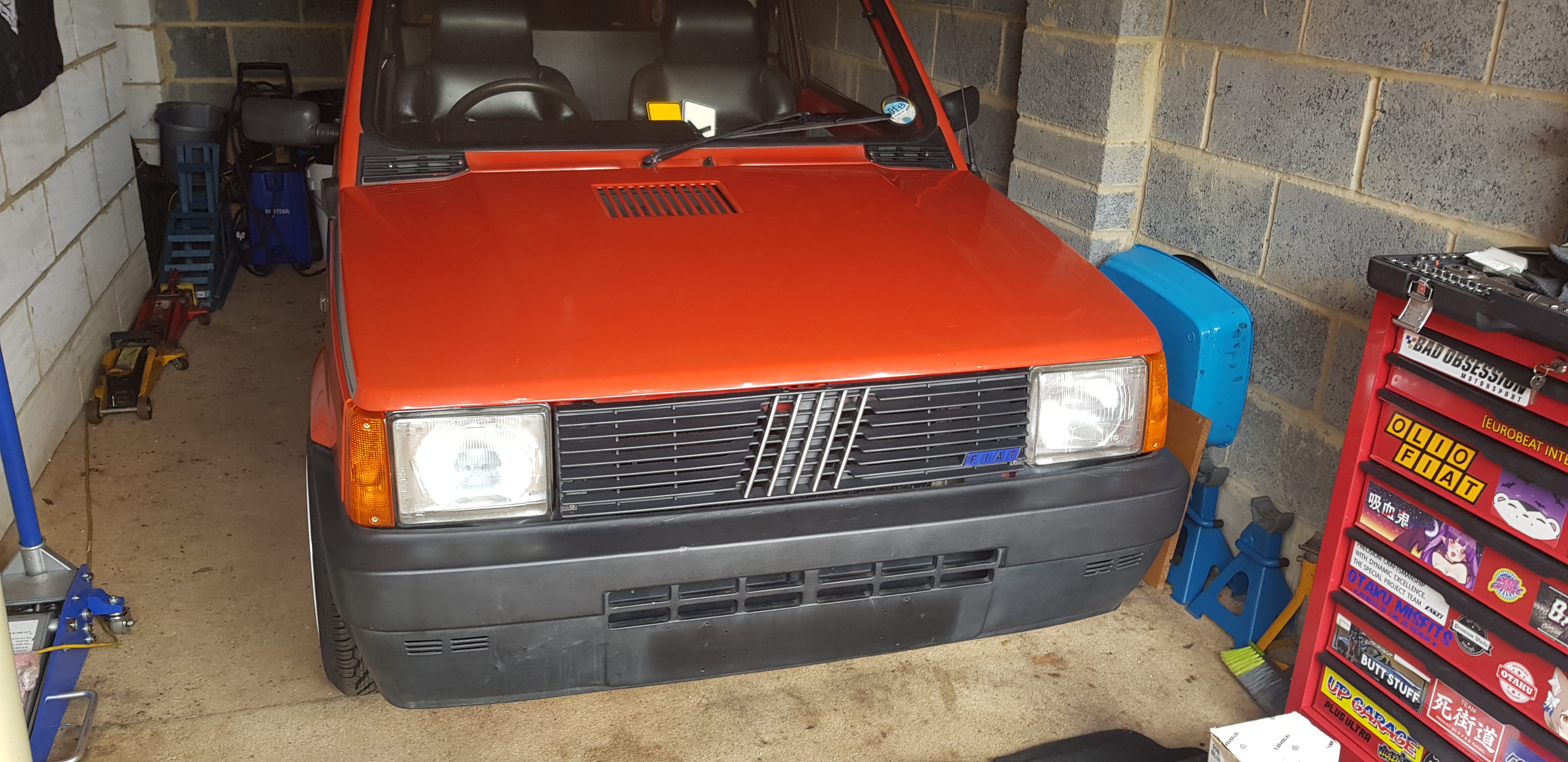

Well a good old car day sunday funday today.
Si popped over with a welder, we drank cups of tea and discussed far far too many different ways of chopping and welding a couple of pipes together lol. In end we went for chop it about there, weld it across here and bobs your aunties uncle it fit first try ?
Didn't put back box on cause for 1 we hadn't put any gaskets on for mockup and 2 would have had to pull the car out the garage and that involves moving stuff and musical cars. But basically exhaust is sorted, I might just clean it up a touch and put some vht black paint on it and the manifold before I bolt everything down for last time though.
Forgot to take any pics but it's nothing exciting really though. Luke sent me few he took though.

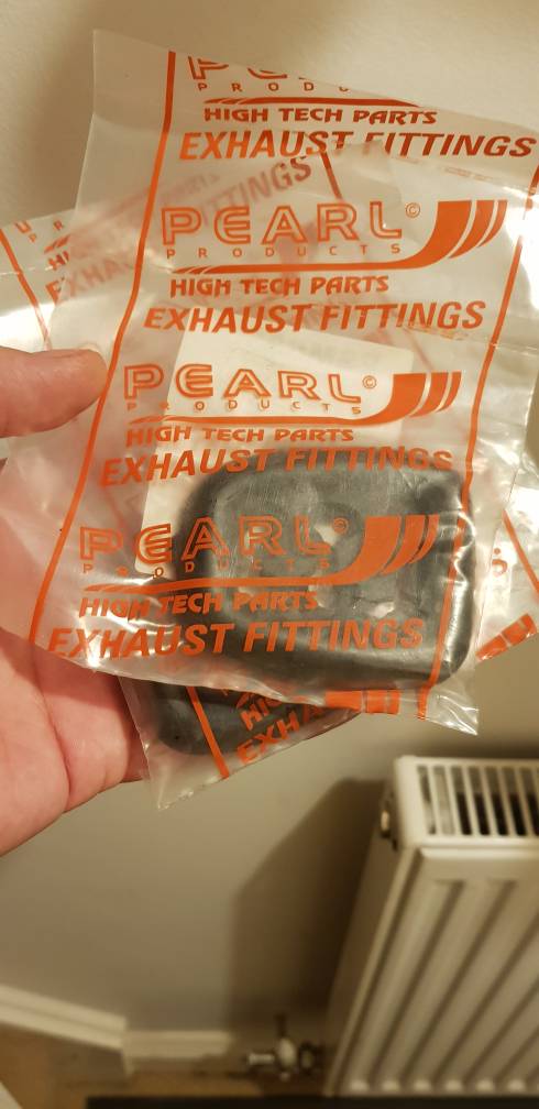

New exhaust hangers arrived so can fit the exhaust, not that I couldn't before but the hangers were really old and cracked so decided to replace

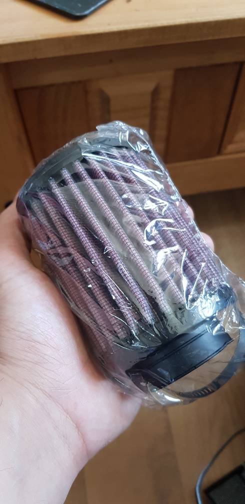

The filter itself has arrived..
It looks diddly but spoken to K&N and they assure me it can support upto 103hp so it's good for this application [emoji6]

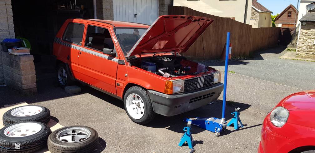

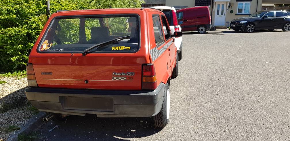

Right well fitted the exhaust yday, no pics but nothing to see really..
But in other news.....

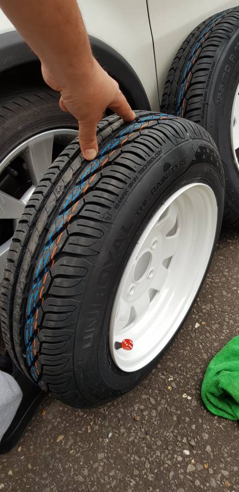

Tyres mounted, silly childish valve caps put on. Hopefully put them on 2moro but I do have other stuff to do so will see if I get around to it.

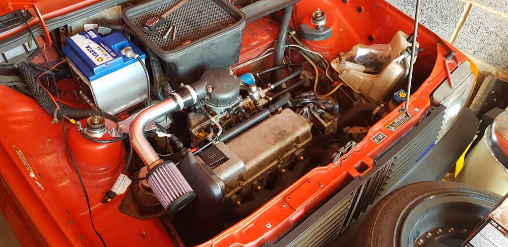

One simple intake fitted, actually looks better than I thought it would tbh.
Had a look around for loose bolts and nuts, found quite a few, but only a couple that I had actually forgotten I needed to tighten.
Let him actually warm up properly, here is actual video evidence lol
[ame]https://youtu.be/eKjzPZ-_MkM[/ame]

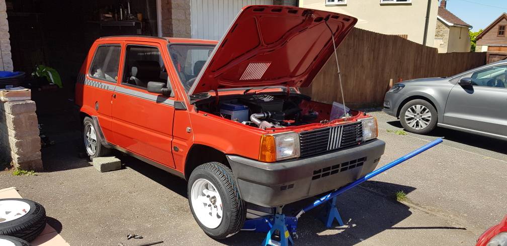

It went well, but the top rad hose leaked as soon as stat opened, but hey proof the stat is working lol. So let it cool down, had some lunch and stuck the wellers on, well 2 at least.
Sorted top hose, topped off coolant and started again. And I can report it runs upto temp, fan still kicks in and cycles and it doesn't overheat sat idling. Put other 2 wheels on while it was running.

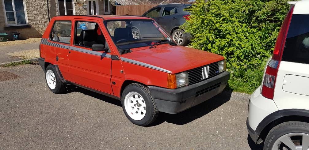

Drove it up and down the road couple of times, all seems well. Wheels aren't catching, at slow speeds at least. It goes and stops and isn't leaking any fluids from anywhere.

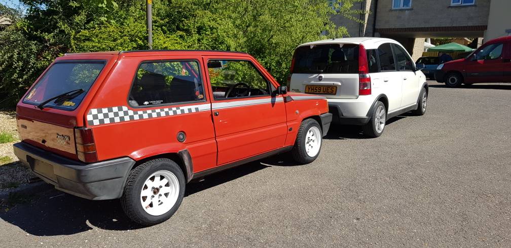

Chilling with his younger bro in the sun. Damn I really like these wheels!
And also it fires straight up when hot too which I've had issue with on few injection fires over the years.

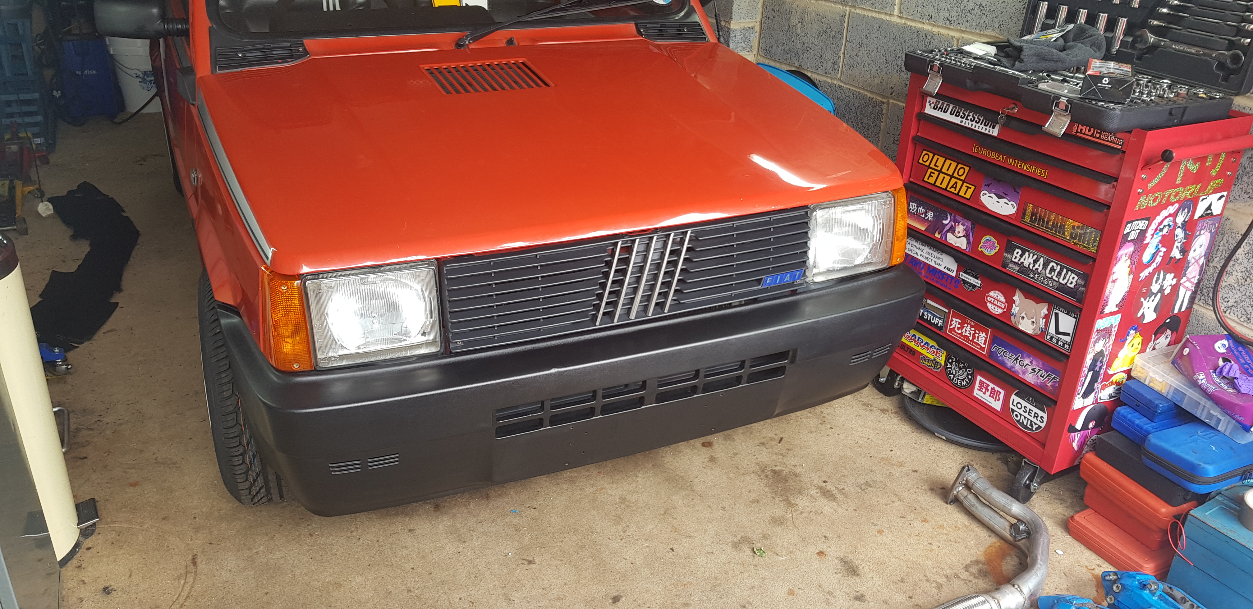

So finally got around to restoring the bumpers with this Forever Black stuff i ordered many moons ago after seeing some videos and reading some reviews.
It comes with a bottle of cleaner and a bottle of restorer - you use the cleaner to strip any traces of oil and silicone residues so the restorer can work properly, the restorer is an actual black dye which you just apply with the supplied foam pad, give it 15-20 mins to seep in and dry and your done. I did 2 coats to to make sure I had a nice even coating and gotta say I am super happy with the results!!
This is the stuff, got it off Amazon
Front bumper after using the cleaner, which tbh just alone made it look miles better than it was.
And after using the restorer.

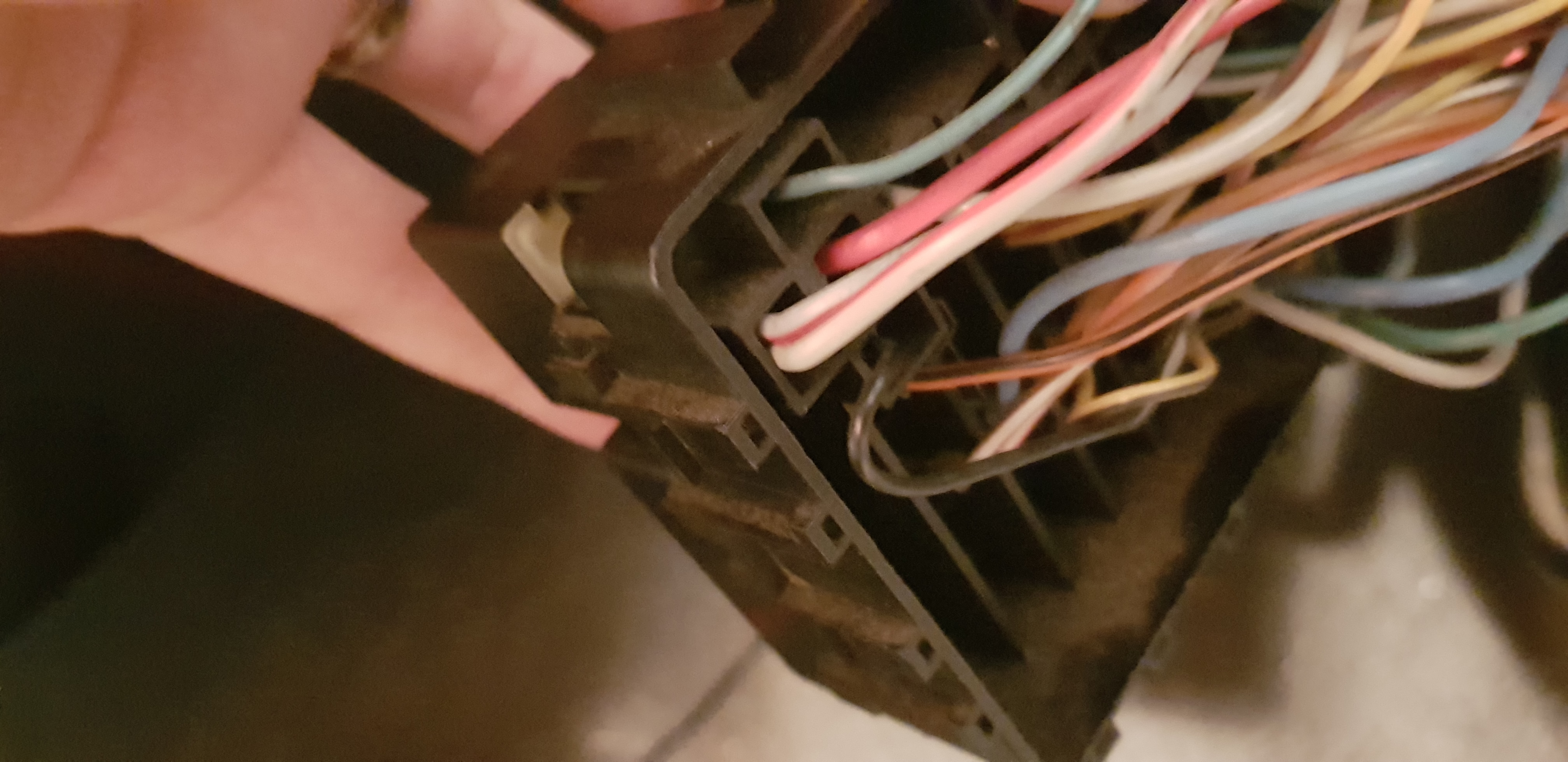

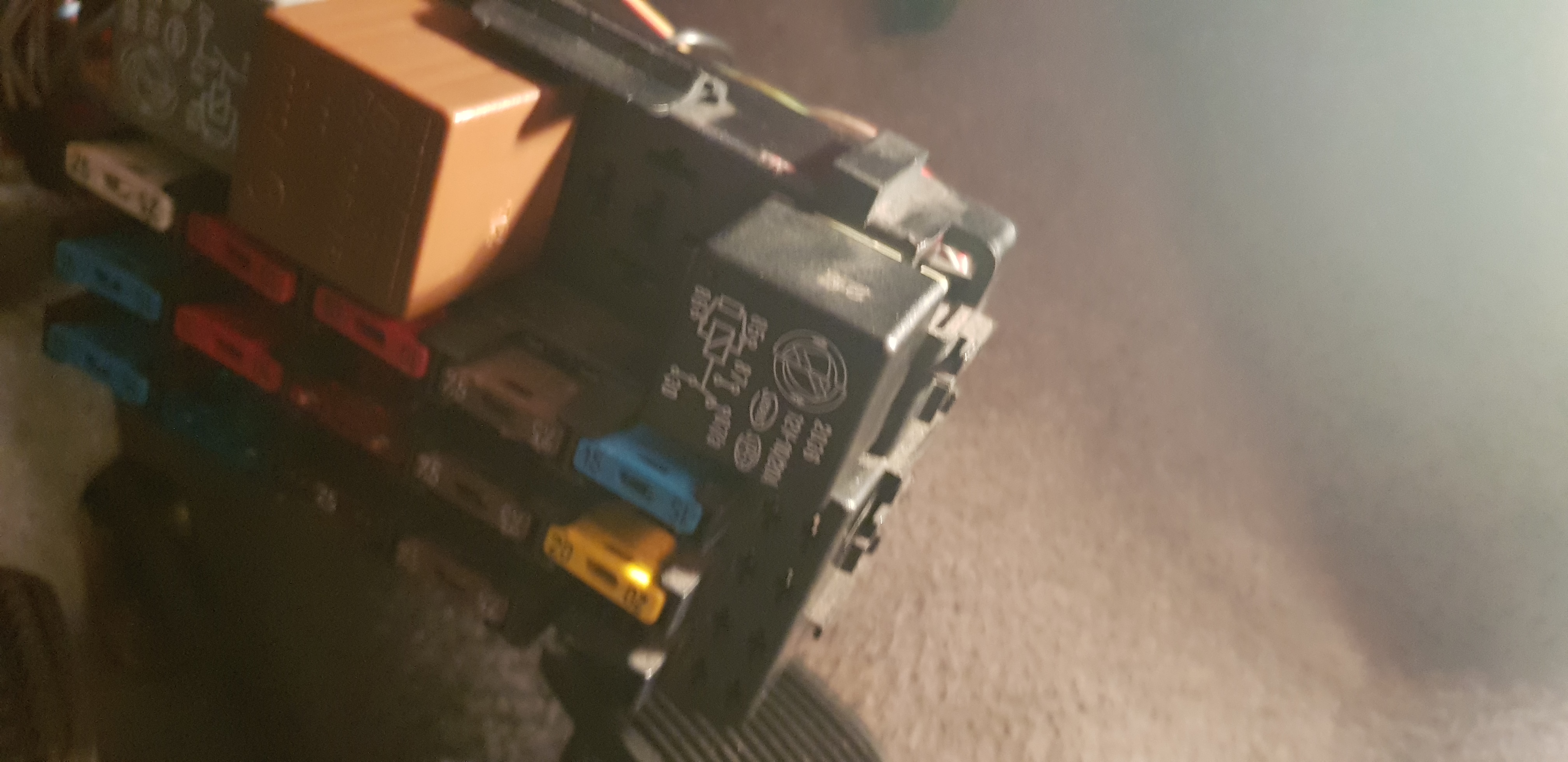

Which leads me onto these lights that don't work.
So there was a few bulbs that needed replacing, and some connections were just a bit wobbly and loose - sorted them no problems. But I am left with headlights that don't work and I openly admit these have got me a little stumped. All the lights work apart form dipped beam, all the rear lights work including fog and reverse, all the indicators work, the side lights work and full beam works but no dipped beam.
I've spent far too many hours trying to get them to work now with no joy - which is mildly annoying being that in theory I've not touched this circuit at all since I last drove it and they worked then.
My wiring doesnt seem to match any wiring diagram exactly which is adding to the confusion. And even wires that do seem to match don't seem to be doing what i expect looking at the diagrams. An example would be the wires on the back of the headlight switch, there is 4 wires and on the diagram the green/yellow should go live when teh switch is in position 2 to turn the headlights on - however, that wire goes 12v live as soon as you turn the ignition on - and the fact that goes live, again according to the diagram, means the headlights should be on if we just ignore for a second it shouldnt even have 12v on it lol.

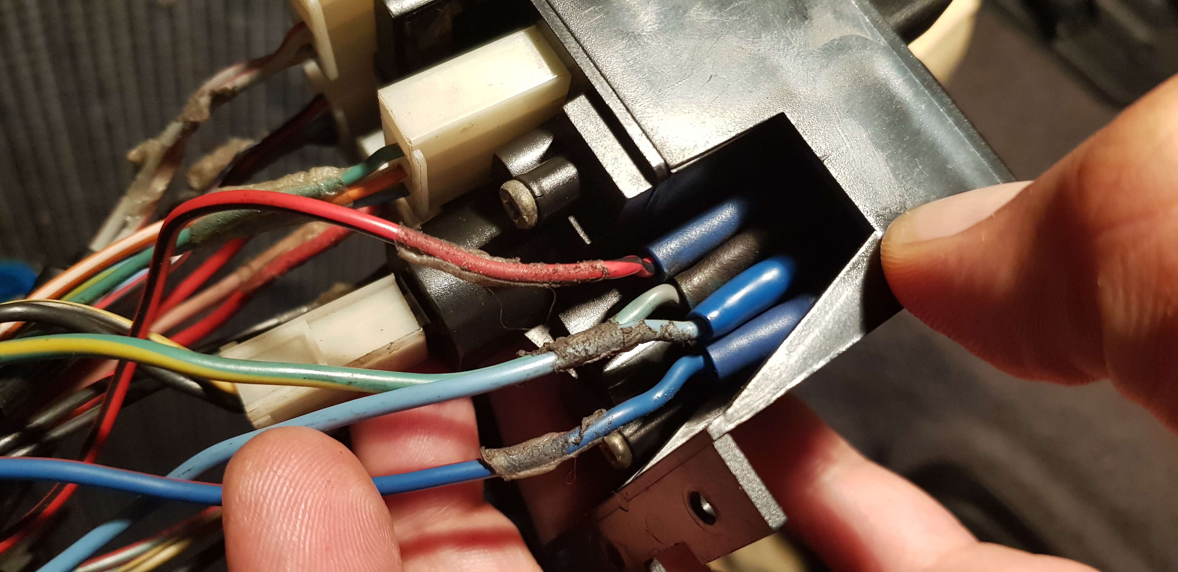

Anyhoo, been trying to follow the circuits around the car and figure out whats going on and I have a question for you good knowledgeable panda people. My car has halogen bulbs for the headlights, which isnt standard as far as i know. And it also has a relay on the fusebox that I dont think is factory either and I'm thinking someone at some point has put this relay in to power the lights - I only noticed this relay yday right before i decided to leave it for the evening and have dinner. So can anyone tell me if the relay pictured is normally there cause according to my haynes the only time there would be one there is in a selecta - its top right slot of the fusebox and its the same type of relay that runs the heated rear screen. (sorry the pics are a bit crap)
EDIT: Just another thought.. here are my wires on back of the headlight switch - I dont recall ever taking these off but maybe i have - the plug being missing and the crimp connectors is proof someone has been messing here at some point, not something I have done... But are these in the right place?
Pins on the switch are labelled D, C, B, A from left to right in that pic and wires are:
D - Blue with red trace
C - Blue with yellow trace
B - Green with yellow trace
A - Red with black trace
Also, By my reckoning my switch doesnt work properly so if anyone has one they know works they can post me asap it'd be great appreciated :)
