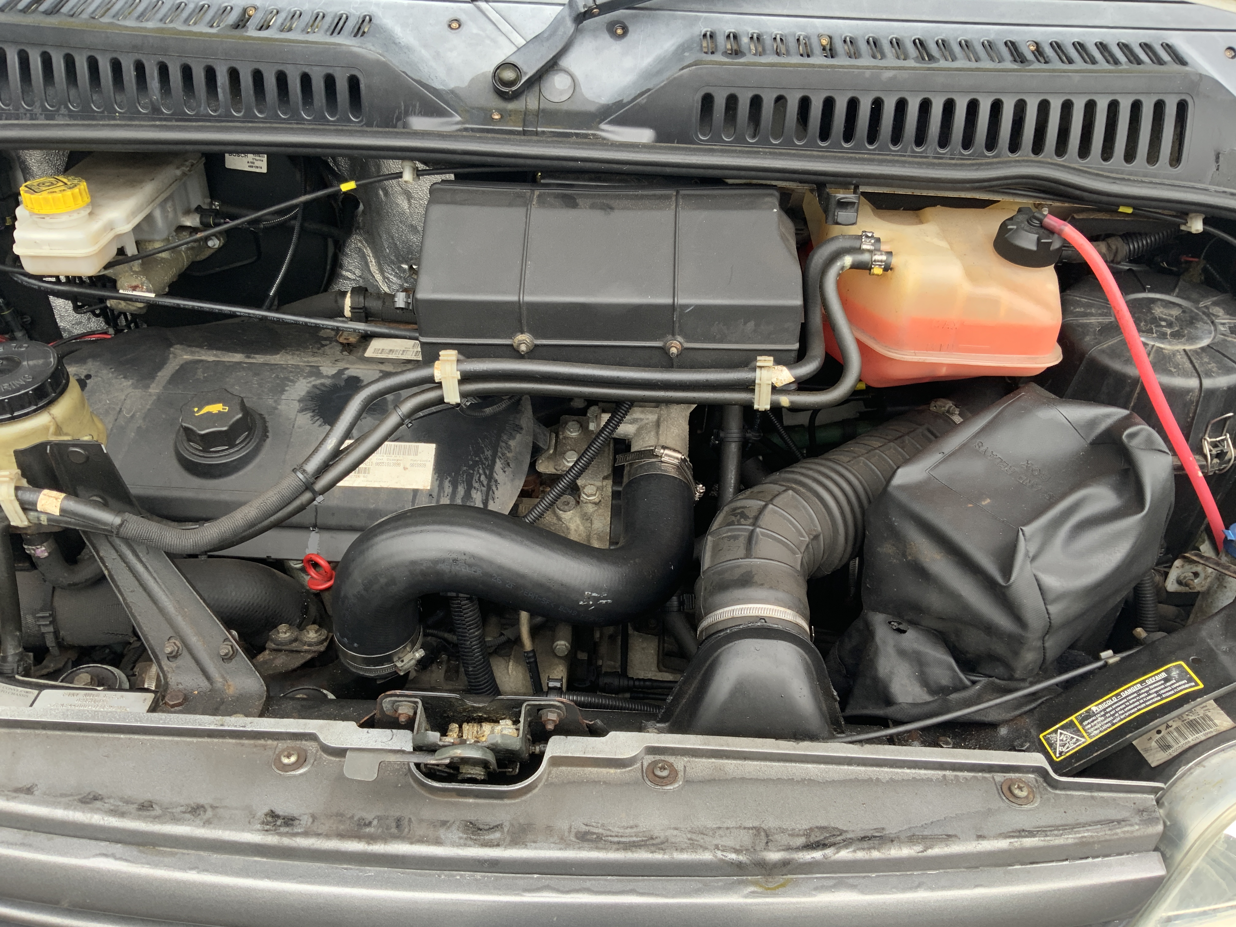

So I was told it was under the bonnet next to the starter batter but as there is only one there it’s not there .
Where should I be looking now.
The below image is the starter battery

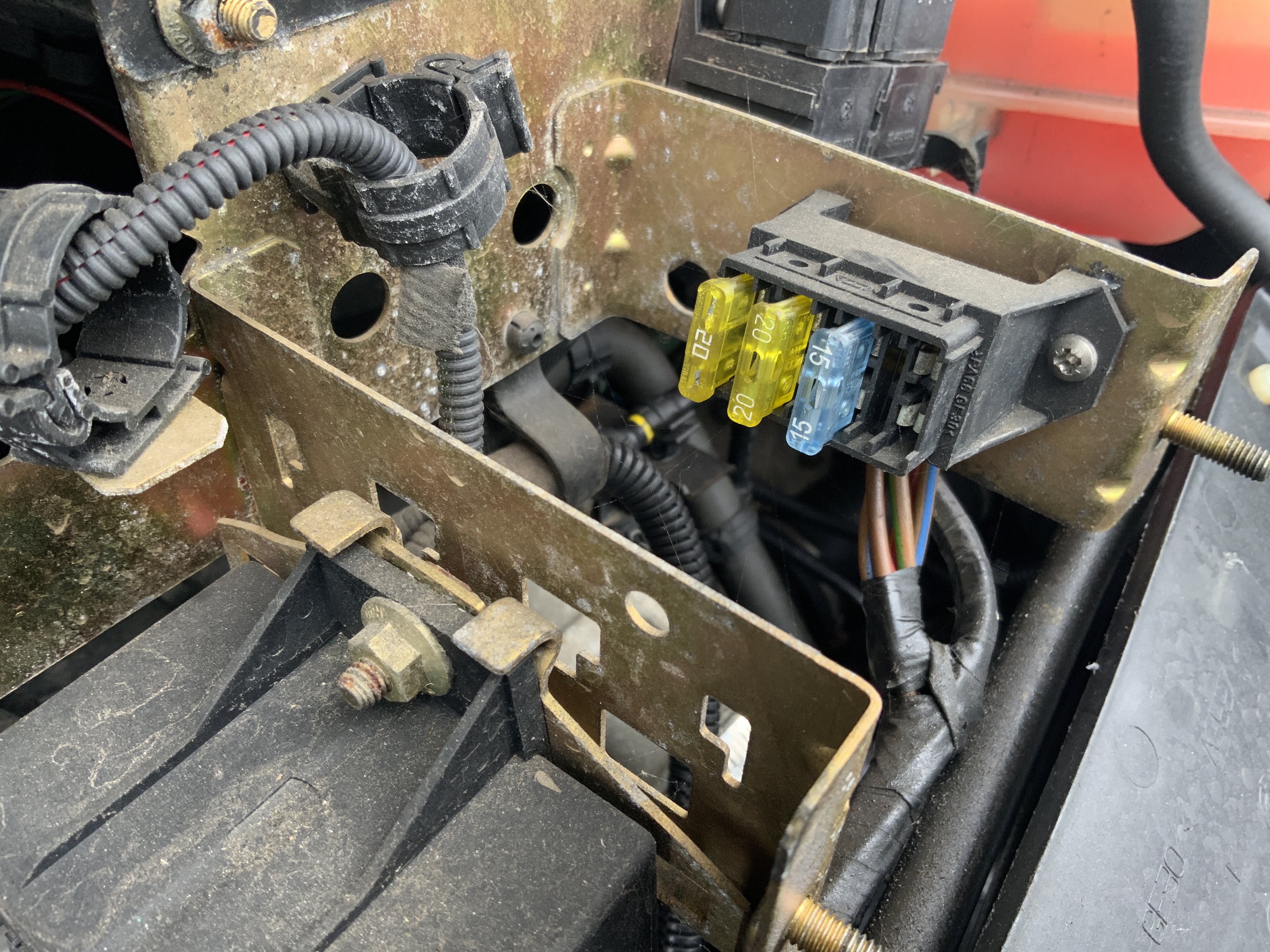

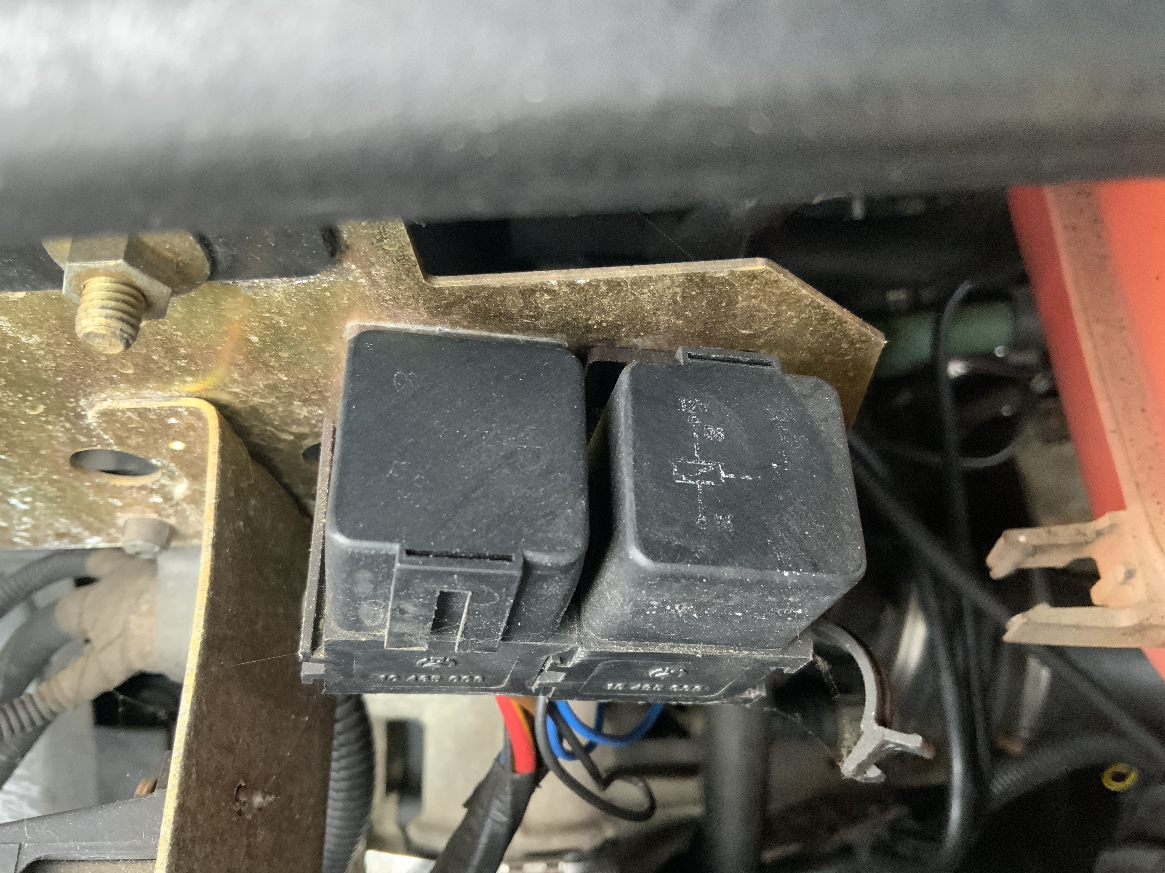

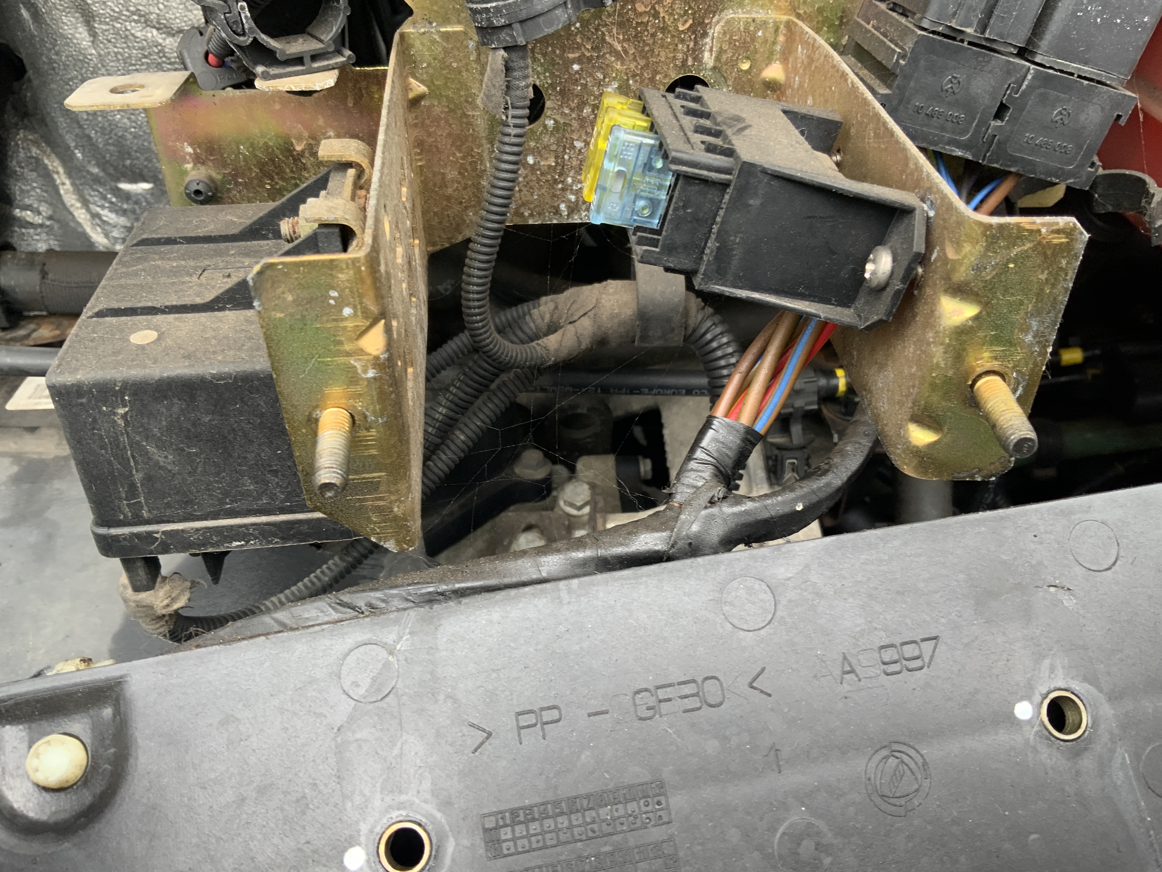

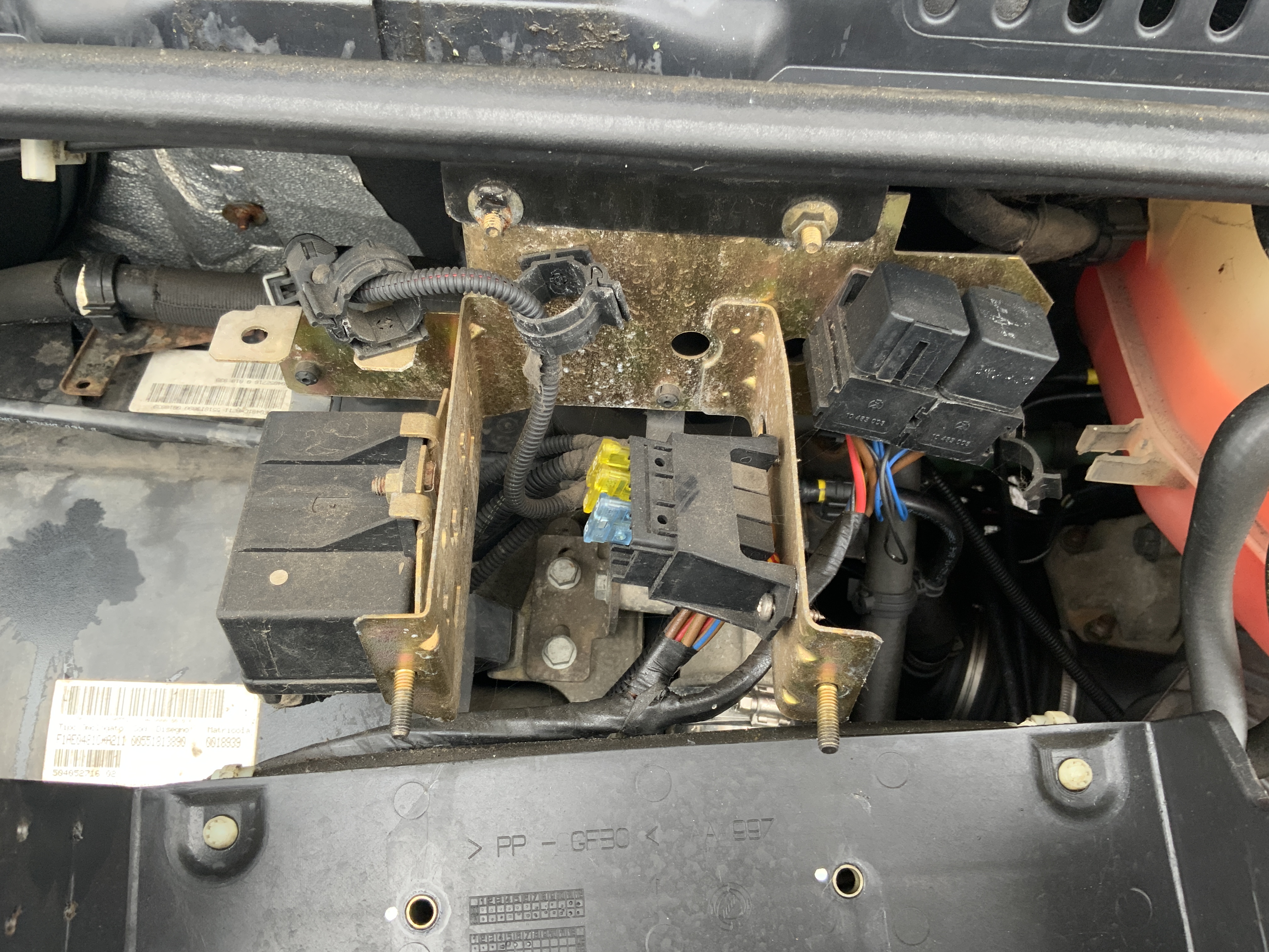

Attached are i
The images I was hoping for some reason one of the relays would say split charge relay .
My guess is one of the relays in the last image is the one I am looking for ..

The relay unit in IMG 2773 is the glow plug controller. In IMG 2774, the fridge relay is the one on the left with the red/yellow wire attached. This makes the adjacent relay the split sharge relay, which will have brown/green, and brown/blue wires.attached. The blue wire is the D+ connection for operating both relays. The diagram shows the step relay coil being operated from the red/yellow fridge supply wire.
